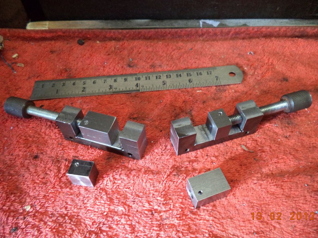

      These clamps are Based on Starrett No 160 tool makers clamps whilst I wouldn't call these clamps tool makers quality due to the constraints of home workshop construction they will be more than adequate for most home workshop. I made them as a perfect matching pair to enhance there usefulness.
      There has been a number of discussions on the forum regarding these clamps with a lot of interest shown in them, the original Starrett clamps can be picked up on flebay they go for about £30 to £50 pounds and Starrett still sell them for around the same price.

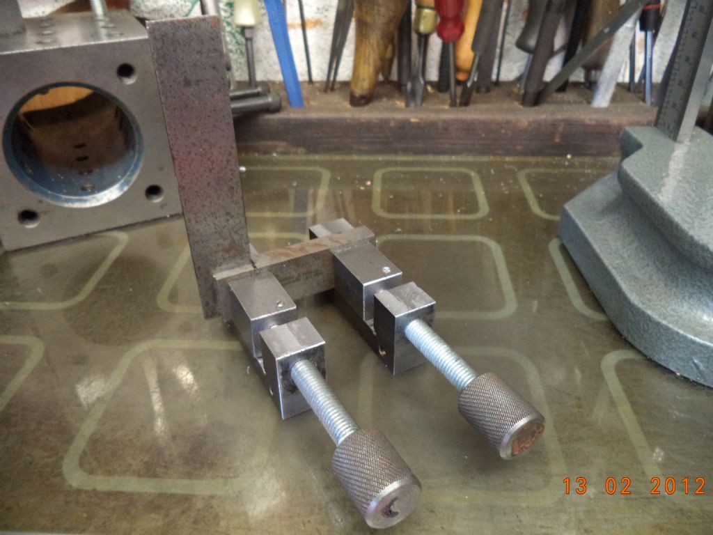

      Any way this is my attempt
      And to show them as to one of their uses.
      They are made from standard size mild steel bar Body 1"*5/8" jaw 5/8" Sq bolt M8. Starrett fixed the jaw with a cerclip but I've used a M3 keep screw.
      Stew

                To make the bodies a matching pair I simply bolted them together and machined them as one. I was unsure just how much the cold rolled bar would distort due to releasing the stresses:- so I roughed them out first and let them stand for a couple of days then I skimmed the base and top flat this took out the distortion.
                Roughing out
                Finishing off body

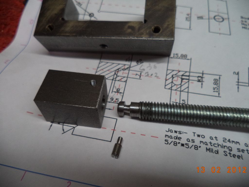

                The jaws couidn't have been easier you just have to drill the M3 hole for the keep first before drilling 6.5 using the self centerng four jaw chuck
                I used a M8 coach bolt to fabricate the screw and welded the knurled head in place.
                Total material cost about £6 and not much more than a days job
                Drawing

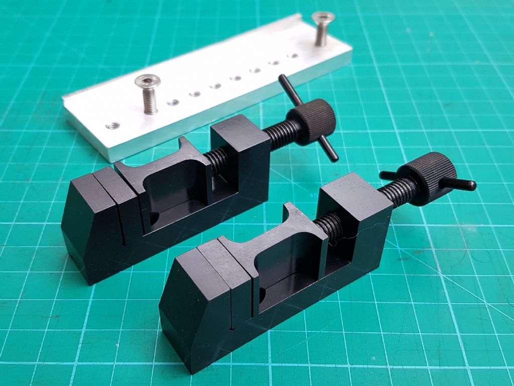

                                                Got the jaws made this evening, all done apart from softening the edges with wet and dry. Took a bit of trial and error with different spring diameters to get the circlip working reliably. More details in my album.
                                                Andrew.
                                                Long and short jaws retained by internal circlipPair of Starrett type vice clamps on aluminium base

                                                  After deburring , thorough degreasing, cold blacking and oiling.After cold blacking and oiling
                                                  #481276
                                                  Stewart Hart
                                                    @stewarthart90345
                                                    Wow Andrew they look superb the black finish really sets them off. How did you degrease them for the blackening process
                                                    Stew
                                                    #481293
                                                    Andrew Entwistle
                                                      @andrewentwistle
                                                      Thank you. I used Fairy liquid and hot water, followed by the alkali degreaser that came with the Blackgates Chemical Blacking kit I bought years ago, made up with hot water from the kettle. The kit is way past its expiry date, but still works fine.
                                                      Andrew.
