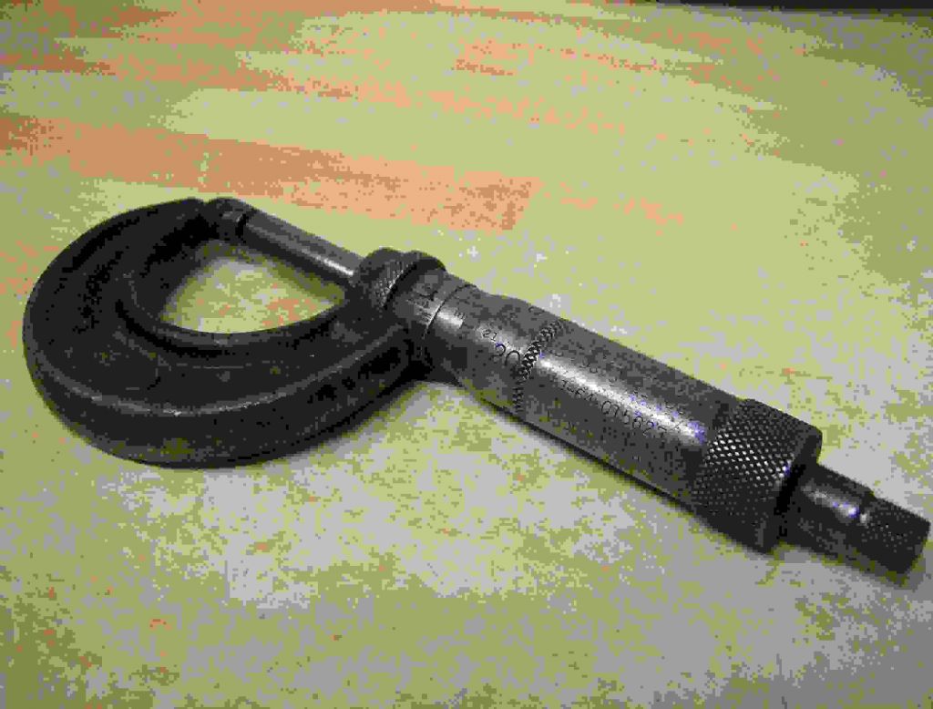

                It was already set properly to read zero at zero, soo i just tried it out with my 1" standard (came with my 1-2" micrometer) and was upset to see it reading 1.0095"
                Then I remembered my 'inch standard' is actually 25mm long or 0.98425" and I was mis-reading the mike – it say 0.9845, so reaing about t 0.00025" out over an inch. Obviously it could have larger errors if it worn on the middle of the thread (if I could be bothered to check and had a standard better than just using another micrometer), but even so not bad for a pound

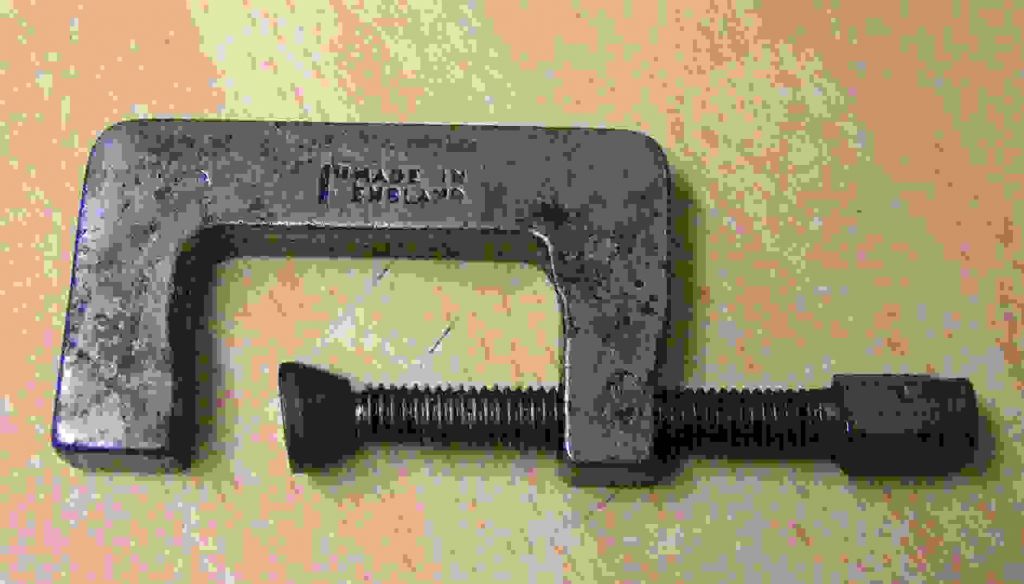

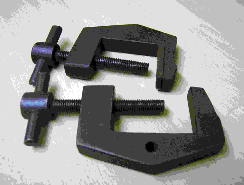

                    It gets more fun still. Here are some of the goodies:
                    Starrett 436
                    Starret Micrometer
                    Apprentice piece clamps(?) initialled 'FG' one has a pad on one jaw fixed by an alloy rivet.
                    Clamps
                    Nice clamp marked Futters London Limited on one side, 1" Made in England on the other (not India) once I cleaned the crap off. The body appears to be a stamping from 1/4" plate.
                    Sorry about the quality – I think I over-jpegged them
                    neil

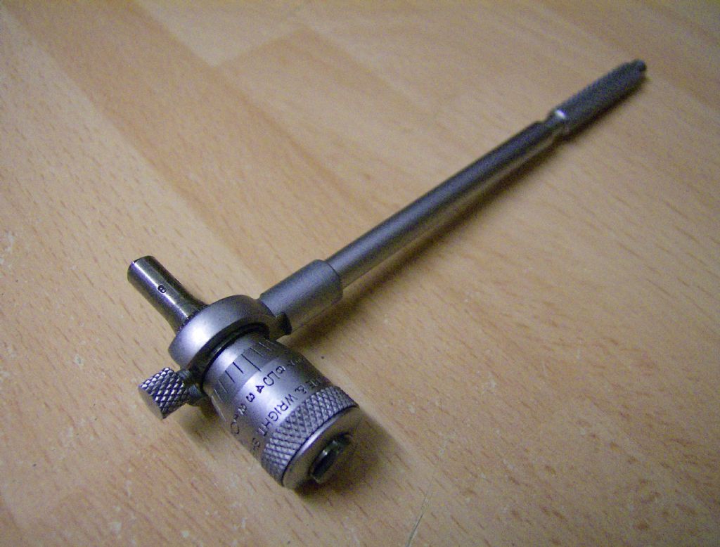

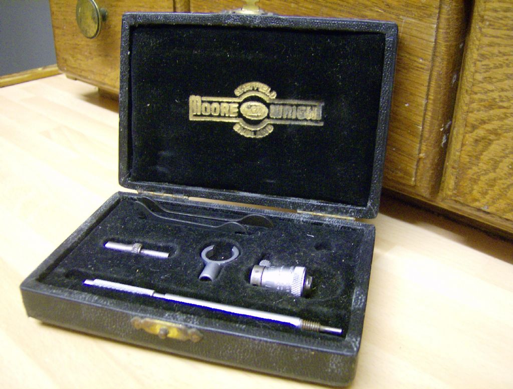

                      By way of apology for those photos (someone had set compression to 100…) here is an object of real beauty – a Moore and Wright inside micrometer, It was complete in the box for a fiver, but there is only one anvil (for 1 1/2" to 1 3/4&quot so must be for a speciality purpose. There is nowhere to store other anvils. there is a small, circular depression that is empty, about 1/4" across and not very deep. Any ideas what may belong in it?
                      is it not one of the most exquisite meauring tools? It would make a fine adustable precision end stop, but I could not brutalise it.

                        #97708
                        Anonymous
                          I don't think it is missing an anvil, it's missing a spacer. My 2" to 12" M&W inside micrometer has a 1/2" spacer included. For instance the smallest anvil measures 2" to 2-1/2" inches. Adding the spacer allows the same anvil to measure 2-1/2" to 3". For 3" to 3-1/2" the next longest anvil is used, without the spacer, and so on. So I'd suggest that your set is missing a 1/4" spacer.
                          Regards,
                          Andrew
                          #97714
                            I agree, Andrew
                            … the Spacer is shown on the page that I linked.
                            #97722
                            Sub Mandrel
                              @submandrel
                              Yes, looks like I'm missing a 1/4" spacer
