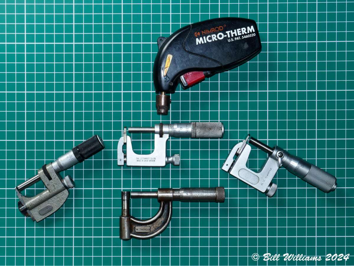

                        #730312
                        peak4
                          @peak4
                          On Bo’sun Said:
                          Hi Bill,
                          It’s not the thimble (outer part) that’s seized.  The thimble rotates very smoothly.  It’s the inner sleeve (also used to adjust zero) that’s seized.
                          Yes, I appreciate that; what I was suggesting was to gently heat the body of the mic where that inner sleeve is located, hot air gun pointing at the spot, and along further to the right.
                          There seems to be a slight variation, in that sometimes the inner engraved tube is a tight sliding fit on an inner fixed tube permanently attached to the main body, and others, the whole tube is a single item engraved on the outside, which rotates in the main body.
                          These all adjust broadly the same way, with the exception of the Slocomb at the lower centre, where I think the thimble fits on a taper attached to the end of the moving anvil.
                          The others are M&W 970MF, Starrett 220, & Mitutoyo, left to right.
                          The Nimrod Microtherm hot air gun, I’ve had for probably 20+ years, and now seems discontinued, but worth seeking out.
                          A5120004_DxO-Facebook-s
                          Bill
