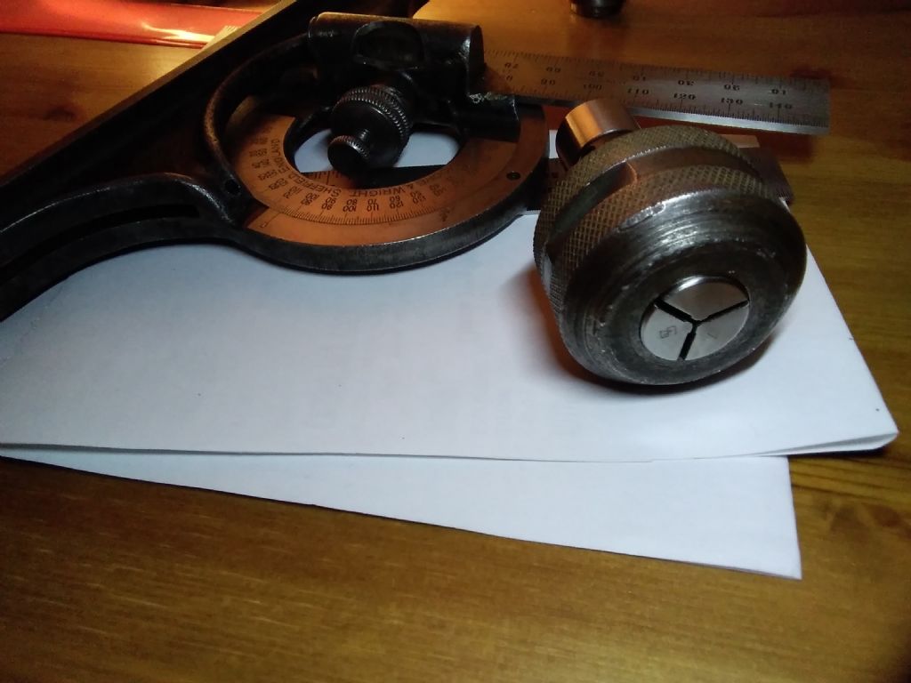

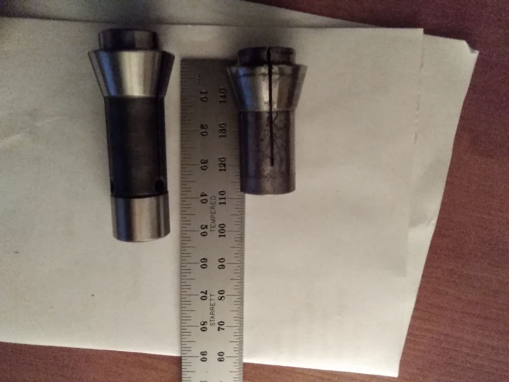

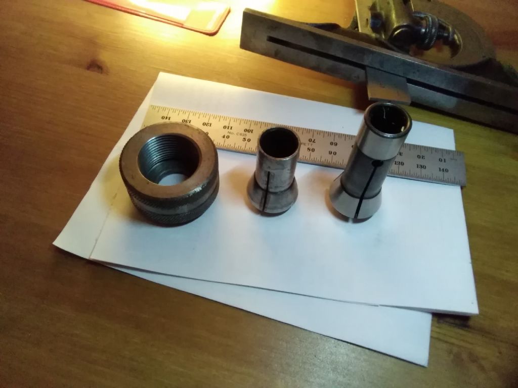

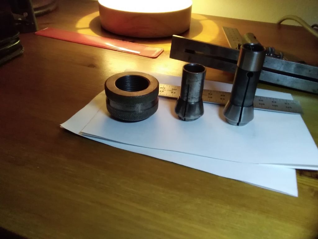

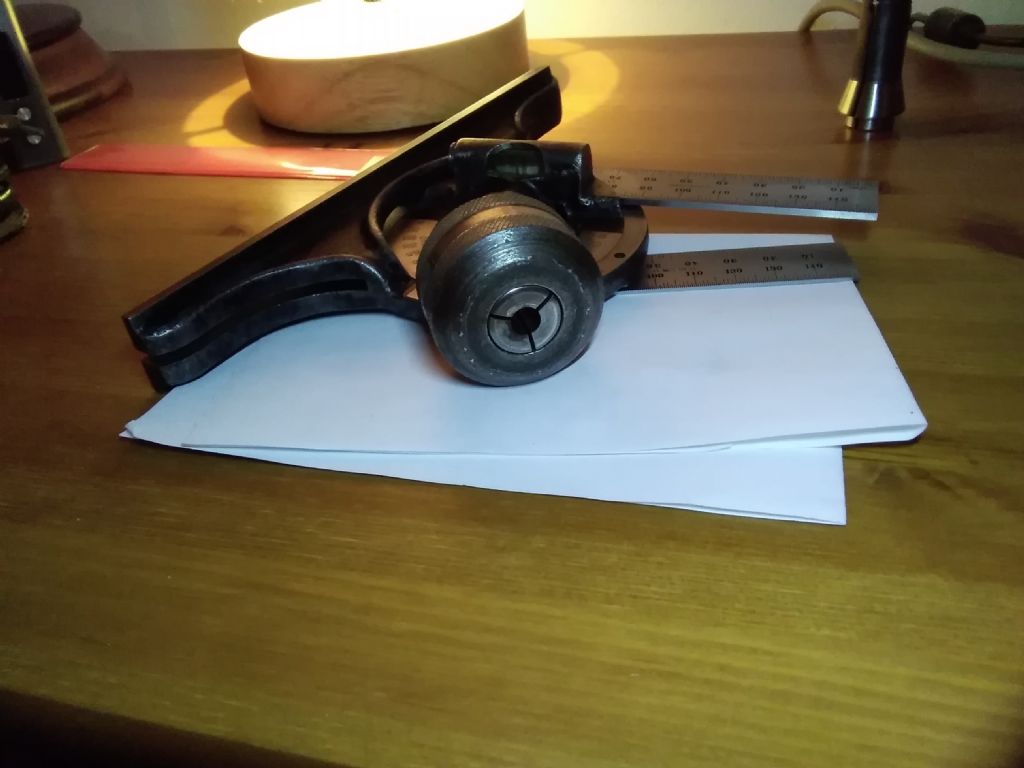

                              I received a msg back from Tony, he said if you find any, buy them all and trade duplicate sizes with others etc, others? I think I've only seen 2 others for sale, ever, which basically makes me think hen's teeth.
                              However, had a rummage through some collets I have, found some Schaublin F16 collets that appear almost identical in some aspects, they are a 15 degree taper, from the links you provided for Crawford, their dead length collets also use a 15 degree taper, the part that protrudes through the collar is the same size, the widest part of the taper is the same, I've tried checking the original collet, but it impossible to tell with 100% certainty using my protractor.
                              Down side, the collets are a bit too long, not much, might only need shortening 3/4 mm
                              You'll see on the photos, the polished back end on the Schaublin collet is slightly too wide to fit in the bore, but again not much, I measured the top of the bore inside the spindle, and it's 15.6mm, the Back end of the Schaublin collet is the thickest part at 16mm,
                              what I'm thinking, shorten the Schaublin collets about 4mm, while the machine is stripped down, take a small amount off the inside of the spindle bore, the original collet never went this far up anyway,
                              What the general consensus on the the original being a 15 degree taper, does anyone know if Crawford would have used this on a 1950ish British machine?
                              Original on the left,
                              Below, the original collet in the Collar.
                              Below the Schaublin F16 collet in the Collar
                              Below the 2 collets.

                                    Having a think, I'd rather not alter the machine itself as this was more about restoring a rare old machine designed by a model engineer, than creating a machine I need to use.
                                    so I've thought if I shorten the schaublin collets say 4mm, I can hold the collet in the lathe somehow, and turning very very slowly, use an ezelap credit card periodically press on the polished thicker end of the collet, to lap it so it will fit, I only need to take off 0.2mm to bring it down to the same OD as the original Crawford collet, and it's only the shiny part, the black part on the schaublin collet is smaller OD than the Crawford.
                                    I used this method to deburr a B16 drill spindle with good results.
