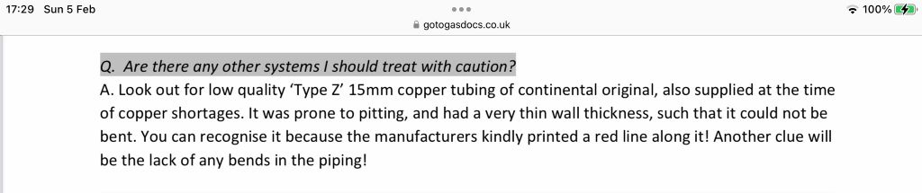

      O.K. John … Here is one potential answer to your ACTUAL question:
      Ref. **LINK**
      https://www.gotogasdocs.co.uk/f/m/Kamco/FAQs/Kamco%20CF30%20FAQs.pdf
      Personally … unless I was absolutely sure of the traceable origin of the pipe, I would [as stated earlier] not take the risk.
      As a trained airline pilot, you presumably understand better than most about traceability.

        Good find, Michael – I came across some of that red-striped tube when updating my central heating, and they are correct, not easy to bend at all, even with the proper equipment, it just kinked and cracked. At the time I just assumed work-hardening of some sort, but now we know.

              Hi Michael, yes indeed, and thank you for a sensible response.
              Very interesting about the red stripe pipe – I have seen it before and like the Grindstone Cowboy, I assumed it had work hardened, since it would not bend in a proper pipe bender, so I discarded it.
              Anyway, as I have said, I have decided not to risk squeezing this tube, and will just have to live with the situation for now until the weather gets warmer and I can break the system down. There are other installation faults to be corrected, such as an air bleed canister that is installed backwards……..!!!!, and the pump and other items being less than ideally situated. I will also install a magnetic cyclonic filter and the missing restrictor valve in the hot water loop. Flush the whole system out, vibrate all the muck out of the radiators and refill with proper inhibitor. A big job, and one that I am avoiding while it is cold, for obvious reasons.
