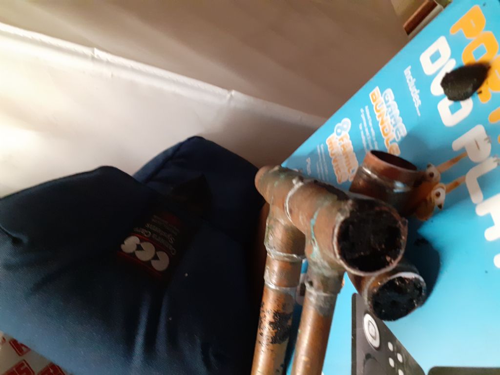

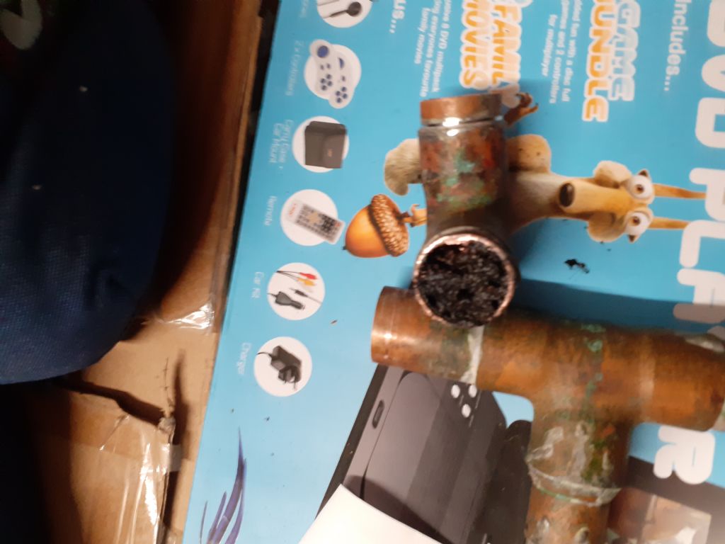

                                      David George 1
                                        @davidgeorge1
                                        I had a similar problem with our system. It seems that our system is an old system was originally a parkway coal fired system which had been upgraded to a gas fired Baxy Bermuda back boiler which we inherited. I had a Baxy condensing boiler installed to replace the Baxy and before it was installed a very strong system cleaner was run first for a few weeks. The boiler was installed in the loft next to the original pump and hot water cylinder. It ran ok for a while but i had the same ptoblems as you describe but the instaler couldn't fathom it and called the Baxy engineer who said it was s partial pipe blockage between the boiler and pump. The installer removed that section of pipework and he couldn't believe what he found. The old pipework it seems had at least 2mm a side coating inside which where he had cut into the old pipe it had dislodged and where the pipework had an elbow to the pump was blocked. The whole section was replaced and since we have had no problems.
                                        David
