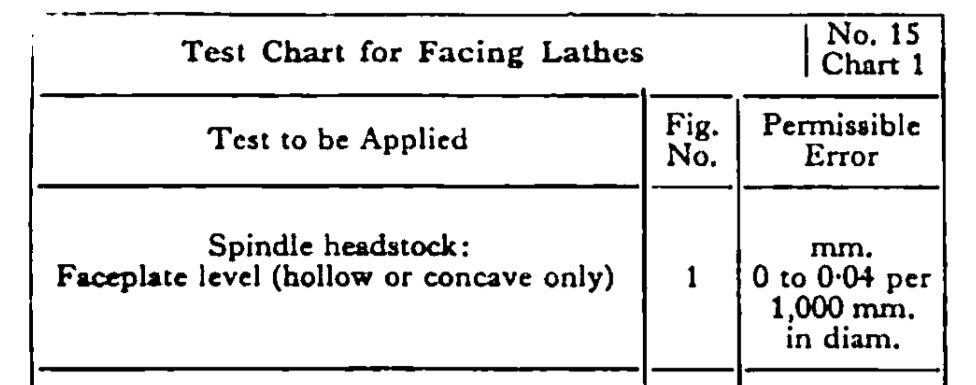

      I think I read on this forum somewhere, we're talking maybe .001" in 12".
      Schlesinger, Lathe faces within 0.02 in 300mm.

              Posted by J BENNETT 1 on 12/12/2018 17:51:59:
              Thanks for the great explanation of why, but how is it built into the lathe?
              Assuming that the headstock spindle is on-axis with the lathe bed …the cross-slde is set very slightly off 90°
              It is important to note that Schlesinger's lop-sided tolerance allows 'zero to slightly concave'.

                Posted by Michael Gilligan on 12/12/2018 23:24:05:…
                So a brand new lathe, made within Herr Schlesinger's limits, may in fact face dead flat and not necessarily concave.
                #385398
                  Posted by Hopper on 13/12/2018 00:21:04:
                  Explicitly:

                      Posted by Michael Gilligan on 13/12/2018 00:36:23:
                      Note: the specific test chart that I sampled is of no great relevance to most of us
                      But the principle of the tolerancing is consistent for all the 'facing' specs.
