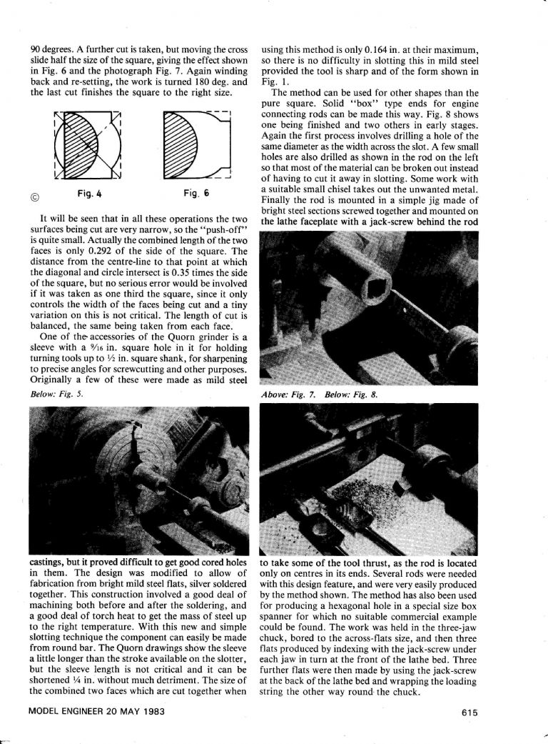

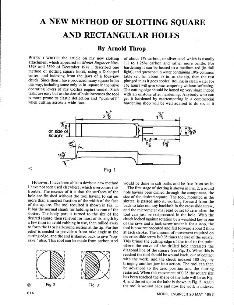

        Steamer1915
          @steamer1915
          Hello Paul,
          I don't know if this would suit your purposes, but it's a good method to know anyway…and it works!
          Best regards,
          Steve.
          Square holes
