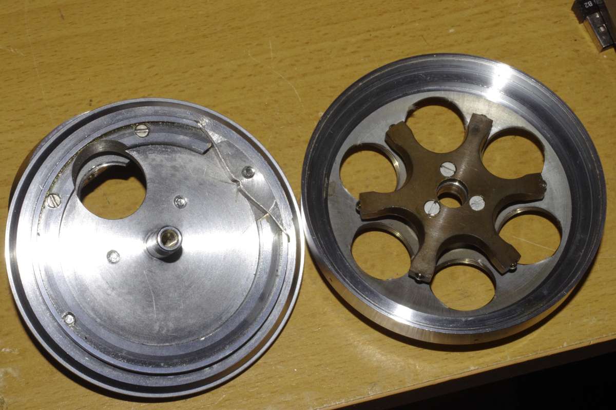

  • #763591
    old mart
      @oldmart
      The turret indexing spring on a microscope is on it’s last legs and I am considering either 0.5 x 4mm steel or 0.8 x 4 berillium copper or a bronze alloy of some sort. With steel, I would have to anneal and re heat treat after shaping but I’m not sure about the copper alloy requirements.

                            The strips of spring steel arrived yesterday, it is CS95 grade. It won’t bend enough as is without cracking and has to be red hot to get the desired bend. After cooling it seems just as springy as before heating over a short distance, so has potential. The press tools used probably quench the steel almost as fast as water would and letting the steel cool by itself before shaping was not a great success.
                            I bought a pair of Bosch wipers for the car and took the old Bosch ones to bits and salvaged two strips of spring steel from each blade, 0.79mm x 7.13mm which is too wide and would have to be reduced for making my small spring. The wipers had been on the car for about 4 years and the springs which were lacquered black showed very little corrosion.

                              The result of several attempts to get the tools to use in the fly press right with steel spring strip is ready to use, but I will also have a go with the beryllium copper when it arrives. The steel has had to be thinned down somewhat because it was too stiff and getting the 1/16″ holes each end exactly spaced needed the mill and drilling 20.5mm each side of the centre for the 10BA screws.
                              Assembling with about 120 x 1/8″ ball bearings will need some car brake grease to hold them.

                                If the 41mm distance is between the two end drillings in the spring, and its also 41mm between the fixed mounting points then the spring will be restrained and effectively be stiffer.
                                The 10BA screws are not visible in the photographs but one of the 1/16″ holes in the end of the spring should be oversize or better still slotted?

                                  I had thought of that and there is just room for cheese heads rather than the original countersunk. The clearance is about 1.5mm. My choice of spring is slightly stronger than the original which is why I have thinned it, but not enough, yet.

                                    Update: I assembled the turret fully and the spring force seems better with the ball bearings and I have started using the microscope with Leitz 4X 0.12,   GS 10X 0.28,   GS 20X 0.50,  Nikon 40X 0.65 sprung,  Watson para 60X 0.85 sprung, and a Swift 100X 1.25 oil. The 4,10 and 20 are parfocal and I will need 11mm added to the 40 and 7mm added to the 60, the 100 can wait till later.

                                      Further update: I have been using the steel spring sucessfully and when the beryllium copper arrived a bit was cut off the 100mm square sheet and I tried pressing the W shape, but it had cracked and fractured after half a dozen slight bendings. If I get around to trying it out again, it will have to be annealed somewhat. I have wrapped it up and marked what it is for future use.
