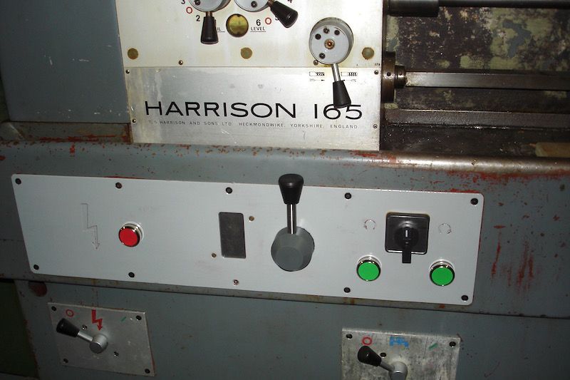

                                      Up and running successfully at last. I've tidied up the wiring into the inverter, adding the screened cables for the controls and routing all the cables properly. I removed all the old wiring from the control panel on the lathe cabinet, along with the old duff fwd/rev switch and welded up all the mounting holes, drilling new ones for the new switches and buttons. Final touch was to make a control knob for the 10k potentiometer in the style of the existing (give or take – I had to use what bits and pieces I had lying around). I've now had the lathe running for an hour or two, with everything working as it should and better than I expected, given my complete ignorance about VFD's before this little project.
                                      Edit – I still have to find a tiny brush and a splash of red paint to touch in the symbols on the panel, which will probably take a few months to get round to!

                                        Can I take a guess that your new red button is possibly an e stop? If it is, you really want to change it for the type that sticks out rather than a "shrouded" type so if you have to press it you can strike it effectively without taking to much of an aim with a digit!
                                        Mark
                                        #208537
                                        Steve Pavey
                                          @stevepavey65865
                                          I was rather hoping that no-one would notice that – unfortunately I was seduced by the quality of these switches (from RS) and they don't do a mushroom version. If I can find a bit of red plastic rod of some sort I will turn up an appropriately shaped button and superglue it to the top of the existing.

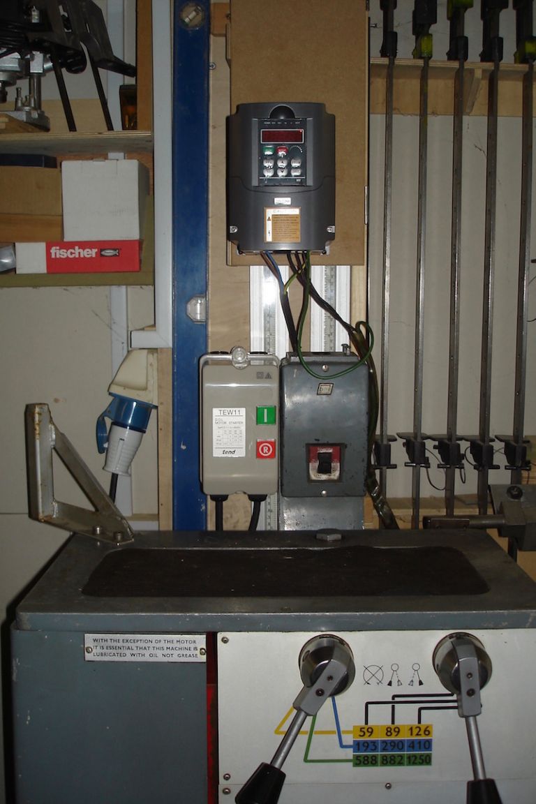

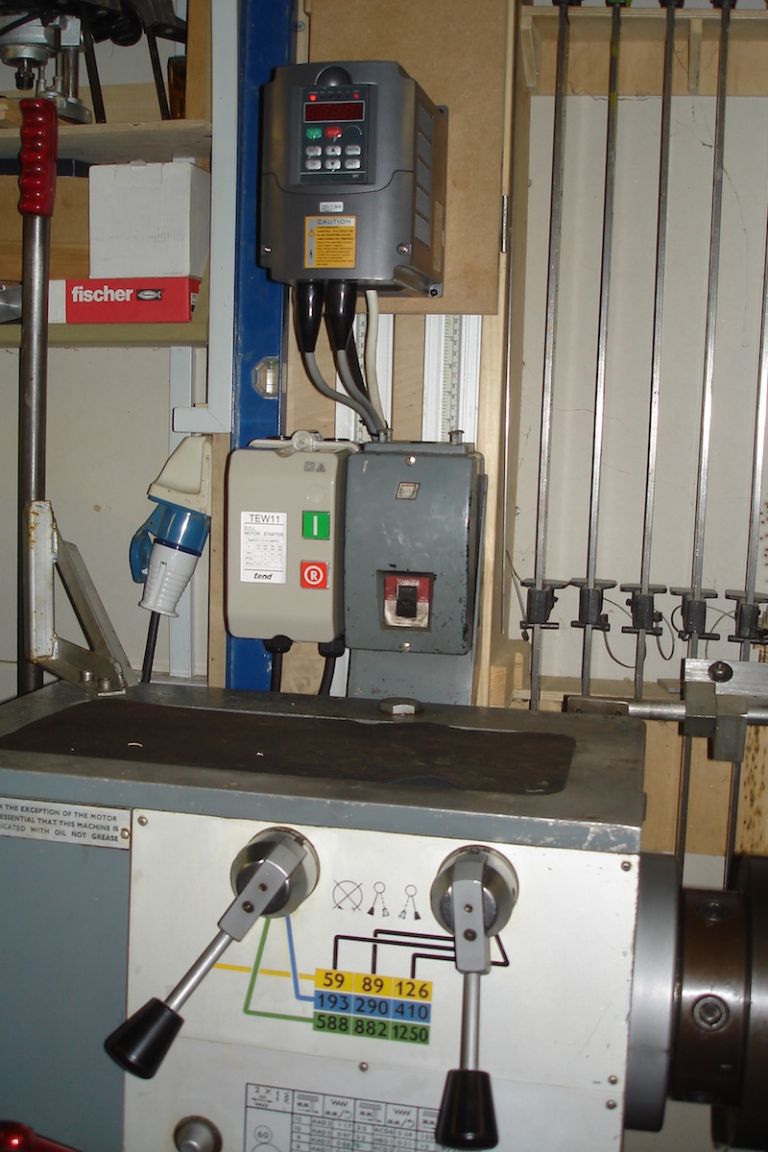

                                              Would you mind letting me know the sequence of your switch gear ( it looks an excellent setup ), is it isolator, DOL then VFD, or can you put the DOL between the VFD and Motor ? Any help you can give would be greately apreciated,
                                              Mick
                                              #230916
                                                As a general rule you shouldn't have any switching between inverter and motor.
                                                #230918
                                                KWIL
                                                  @kwil
                                                  Mick, the connections from a VFD must be direct to motor without any switching, you may put the DOL before the VFD.

                                                      Sorry for nor replying sooner – yes, the supply is from a 16a commando socket to the DOL starter, then to the inverter. You don't actually need a starter, but because commando sockets are unswitched, and commando plugs are unfused I decided that the simplest method of isolating everything was using a dol starter. I could have used an industrial isolater, but they are just as expensive.
                                                      Since the last photo I have restored the LoVo light and fitted it with a 12v led lamp. This operates from a seperate 13 amp socket outlet, which also provides the supply to the coolant pump (or it will do when I get round to sorting the coolant pump out).
