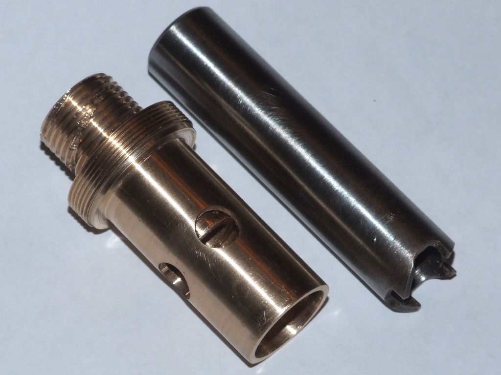

                        #473037
                        Anonymous
                          The teeth on this counterbore were filed by hand, but they still did a precise job on the part shown:
                          In the holes can just be seen a hollow spigot that will hold a wing valve. The spigot is counterbored so that it stands proud from the outer shell.
                          Andrew
