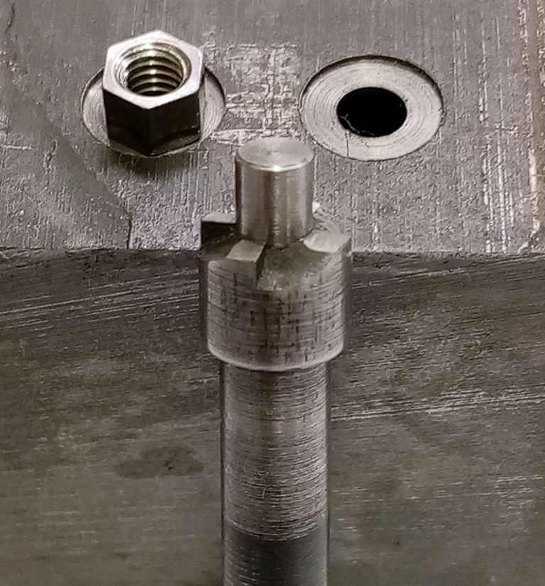

                Thought I would have a go and make up a spot facing tool to suit the M4 nuts I have, it turned out ok, though I think I will reduce the diameter as I prefer it a bit tighter to the nut than I have it at the moment.
                It was the first time I have hardened any silver steel but it seems to have gone ok, it cuts cast iron quite easily and fairly clean to. I was lazy this morning, I was going to file the teeth but did it all on the lathe and mill in the end.

                      #472468
                      Ron Laden
                        @ronladen17547
                        Posted by Michael Gilligan on 17/05/2020 14:46:16:
                        Posted by Ron Laden on 17/05/2020 14:34:10:
                        A brief description of how you went about that would probably be useful to many, Ron
                        Excellent result, Sir !!
                        Thanks Michael,
                        I started with a piece of 10mm silver steel bar and turned the 6mm shank and 8mm body as one piece, I then drilled a 4mm hole (M4 clearance) 10mm deep into the body to take the 4mm spigot later. I should say before someone jumps on me I dont use recommended clearance sizes, for me I think the are too big so M4 I use 4.0mm, M6 – 6.00mm, M8 – 8.0mm etc.
                        Milling the teeth I just picked up on one of Jasons pictures where he showed the tool set up in a Stevensons square collet block at an angle on the mill. I dont have a Stevensons block (yet) so had to come up with something else. I drilled a 6mm hole to accept the shank through a piece of alu round bar and fitted a grub screw to lock the shank. I then squared of the sides of the bar making sure the four faces were 90 degrees to one another (picture below).
                        With the tool locked into the bar/block and the block mounted in the vice I set up the angle for cutting the teeth. The angle was created simply by positioning the side of block against a piece of flat bar on which I had milled an angle on the end, nothing technical I havnt measured the angle I just went with what I thought looked right for the teeth. I then positioned the vice in Y so the the edge of the cutting tool was at the centre of the tool body, touched off the tool to the top of the body and then took 4 x 0.5mm cuts in X, 2.00mm total which again looked about right. It was then just a case of turning the block through 90 degrees and repeating the same for the othe 3 faces. I then stood the block vertical and "just" skimmed the top of the four teeth to make sure non were sitting proud. Then ten minutes spent with the diamond file I created a shallow rake angle on each tooth.
                        Then finished with the hardening and fitted the spigot with 638 retainer.
                        Sorry for the war and peace explanation but its the best way I could explain it.
                        Ron

                                  Alan Charleston
                                    @alancharleston78882
                                    Hi Ron,
                                    I'm not clear as to how you milled the teeth. From your picture, I can see that the bottom of the cutter is in the same plane as the angled part of the tooth but the side of the cutter doesn't line up with the part of the tooth which is parallel to the drill. If the teeth were cut as shown, wouldn't you end up with a negative rake? Did you file the side of the tooth after milling to give a neutral rake?
                                    Regards,
                                    Alan
                                    Sorry Ron, I've looked at your post again and I see you say you filed the cutter after hardening to sort the rake out. I initially thought you meant you had filed the top of the teeth to provide clearance after milling the top of the teeth to ensure they were all the same height.
                                    Alan
                                    Edited By Alan Charleston on 18/05/2020 07:30:11

                                      #472593
                                      Ron Laden
                                        @ronladen17547
                                        Posted by Alan Charleston on 18/05/2020 07:19:23:
                                        Hi Ron,
                                        Regards,
                                        Alan
                                        Alan
                                        Hi Alan,
                                        No it is as you thought, when you turn the block through 90 degrees the cut runs through the previous cut with the edge of the tool creating the face of the tooth which is neutral. In hindsight I probably didn't need to dress the top of the teeth but in doing so it left flat spots on top of the teeth and it was those that I filed a small relief to. So my teeth have a neutral face and a relief on top or bottom if you like.
                                        I don't know if Jason leaves a neutral face but I,m sure he will confirm.

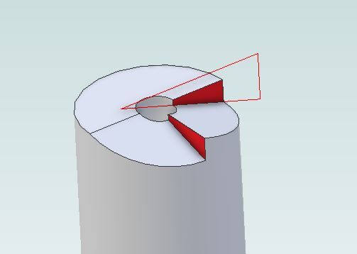

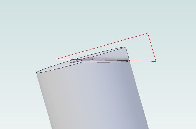

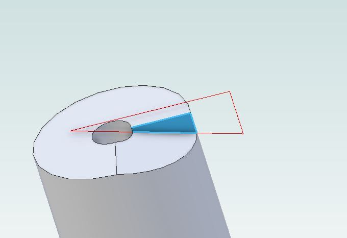

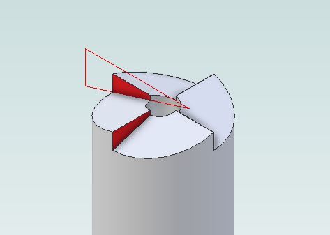

                                        #472612
                                          Yes just a zero rake face left by the edge of the tool seems to work OK, you could use a triangular file to add soem positive rake or even use a dovetail type cutter to do the same.
                                          First cut and the edge of the tool forms the first cutting face.
                                          spot1.jpg.
                                          Next cut forms the clearance and you get the cutting edge where they meet
                                          #472617

                                            #472641
                                            Dr_GMJN
                                              @dr_gmjn
                                              And the CAD is a left/right mirror image of Ron's photo presumably?
                                              #472646
                                                That's a reverse spot facer for those that don't want to run in reversewink 2
                                                Conventional would end up like thisblush

                                                  #472657
                                                  Dr_GMJN
                                                    @dr_gmjn
                                                    Posted by JasonB on 18/05/2020 11:16:19:
                                                    Yes, that was my understanding – one pass of the cutter right to left forms everything.
                                                    I'm going to try that method when I get the steel.
                                                    If I make a fixture like Ron's, any tips for marking out the rotation positions on the steel shaft ie 0, 90, 180, 270?
                                                    Is there an optimum number of cutting edges to reduce vibration?
                                                    Thanks.
