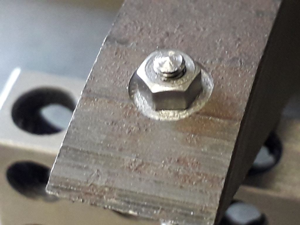

      7BA nut is just under 5mm across the Corners so 6mm or 1/4" spotface. On that size I'd more than likely use a short series 3-flute. Seldom use 2-flute unless its for an actual slot or an aluminium specific one where it helps to clear the swarf.

        I was using a 5mm slot drill. As Jason says that’s the minimum I could get away with. I partly chose to go with the minimum in case I ran into issues…

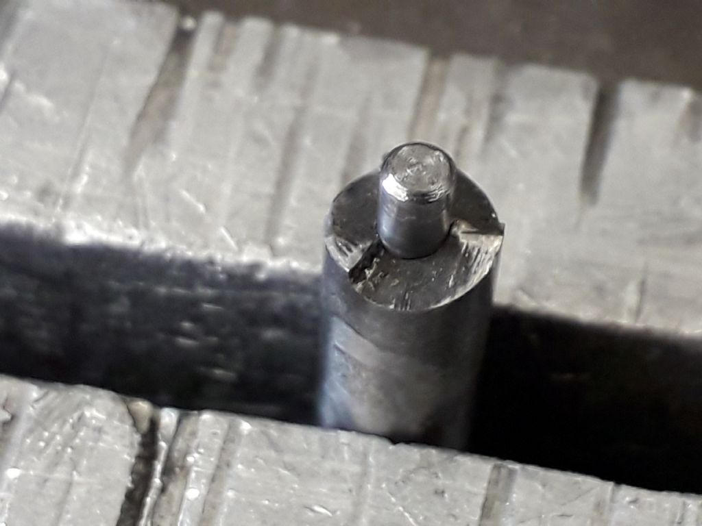

                  So with some trepidation I set about making a spot facing tool this morning. The idea is that the spigot will get pressed into the central hole when it's been heat treated; it's a tight fit. It's also a good fit in the casting clearance holes. I made the O/D 5.5mm, which seems to be the minimum required to clean up the error, and still not go too far into the corner radius. I still need to do a final touch-up on the cutting edges with a fine sanding/polishing stick. Looking at the last picture, I might also turn some more off the plain flank to give more clearance to the casting:
                  I did some reading, and I think I'll need to hold it cherry red for 5 minutes, dunk in oil or salt water, then straw yellow and dunk in water (does it have to be oil)? Hopefully our gas poker will be ok. Making tools and heat treatment (apart from annealing photo-etched brass) is completely new to me, so any further comments on either are of course very welcome.

                      #472130

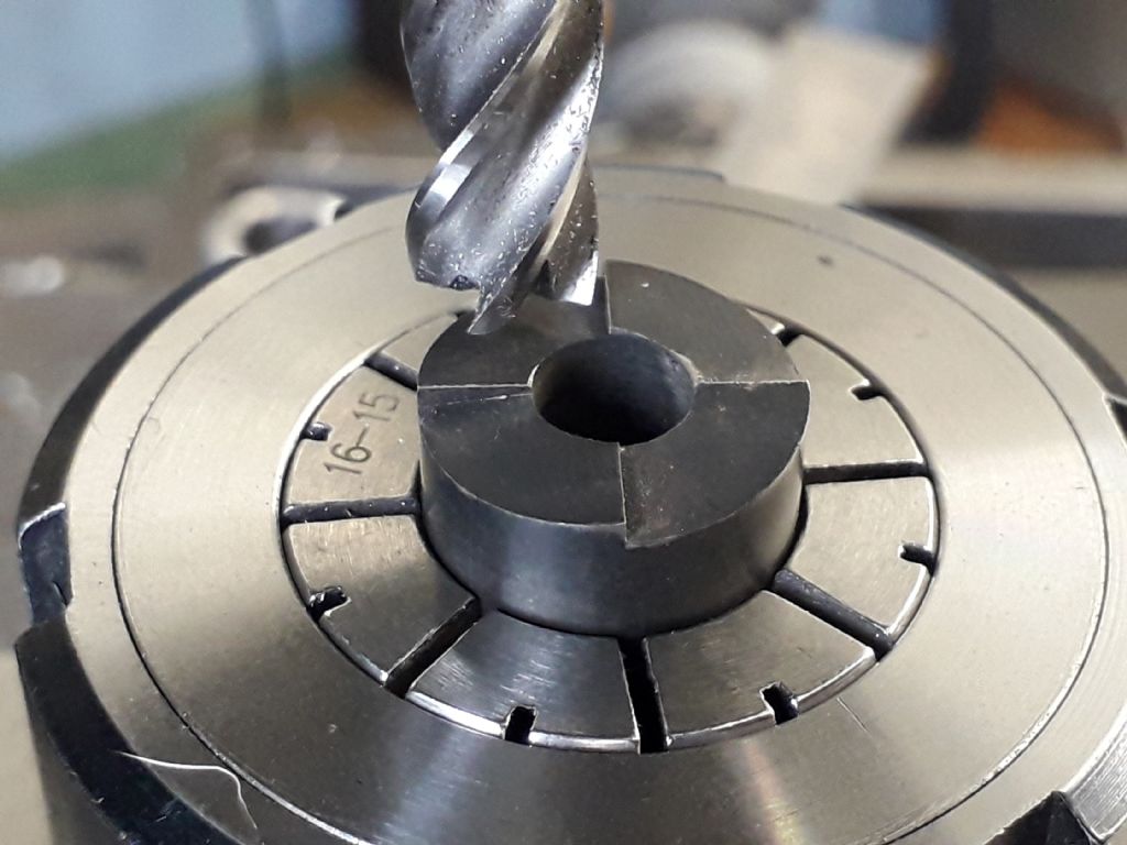

                        Looks like you are making a good job of that so far, maybe a bit less of an angle will help with tool life. here is a rough and ready one I knocked up this morning from 1/4" silver steel, just filed and not sawn, I tried 3 teeth as it is small but 4 is actually easier. Photo after hardening and a lick with a diamond slip.

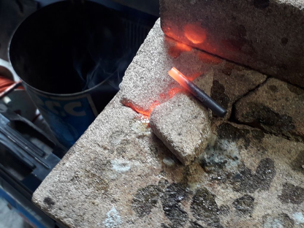

                        Got the end red and held it there for couple of mins
                        Quenched in water, make sure you keep it vertical as going in at an angle can make the work bend. As it's a fairly solid lump I did not temper it.

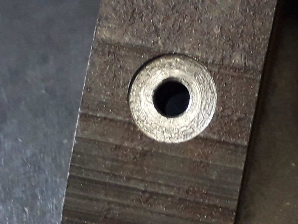

                        This is the side of a piece of cast iron bar drilled 2.6mm than spot faced, bit chewed up as I did not spend much time on the cutting edges
                        As I said I would usually go for a 3-flute cutter on small ones like this that are easy to get to without excess tool stickout, and it's a better job
                        For those that don't like to file it can be done by milling but if you are anything like me the job is already in the milll and drilled when you then want a spotfacer!

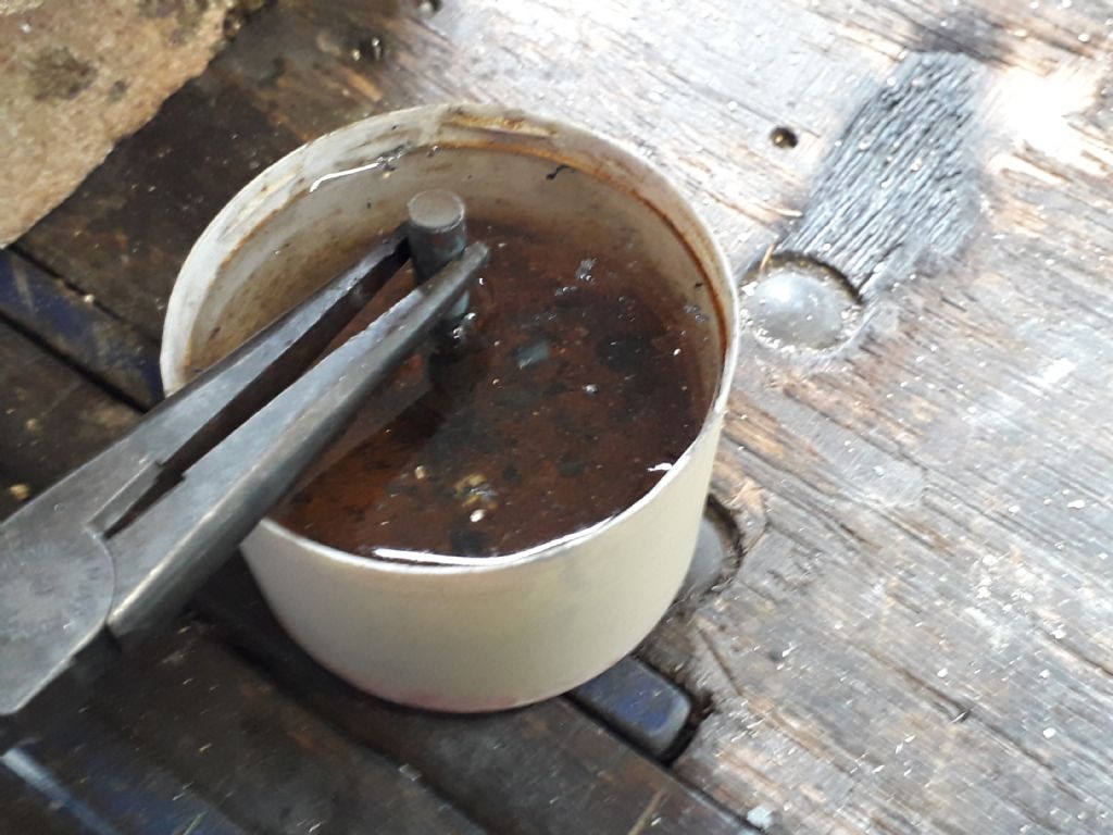

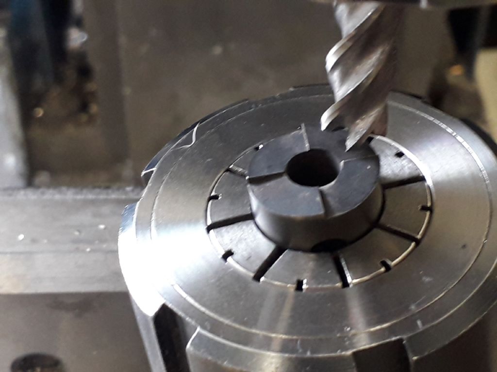

                                                  So I reprofiled the teeth, heated , and when it was about cherry red after removing it from the flame, dunked it in brine. The outer parts of the teeth felt pretty sharp to the touch at that stage, but in reality the teeth are tiny and it's very difficult to see and feel the edges further towards the pin:
                                                  Then heated to straw, and brine:
                                                  I tried it in the casting, and in some scrap steel, and it just polished the surface and mashed the teeth:
                                                  I re-filed and re-heated etc, but with the same results.
                                                  TBH I think all we're doing here now is introducing a whole new load of unknown variables (tooth geometry and heat treatment) into a problem with several existing unknown variables! Plus I'm a beginner…
                                                  I hate giving up on things, but unless anyone can see anything obviously wrong, I think I'd be better just buying a spot facing tool if one's available, and leave tool making to the experts for now. Shame, becasue I thought it was looking pretty good.
                                                  As ever, comments & suggestions welcome.
