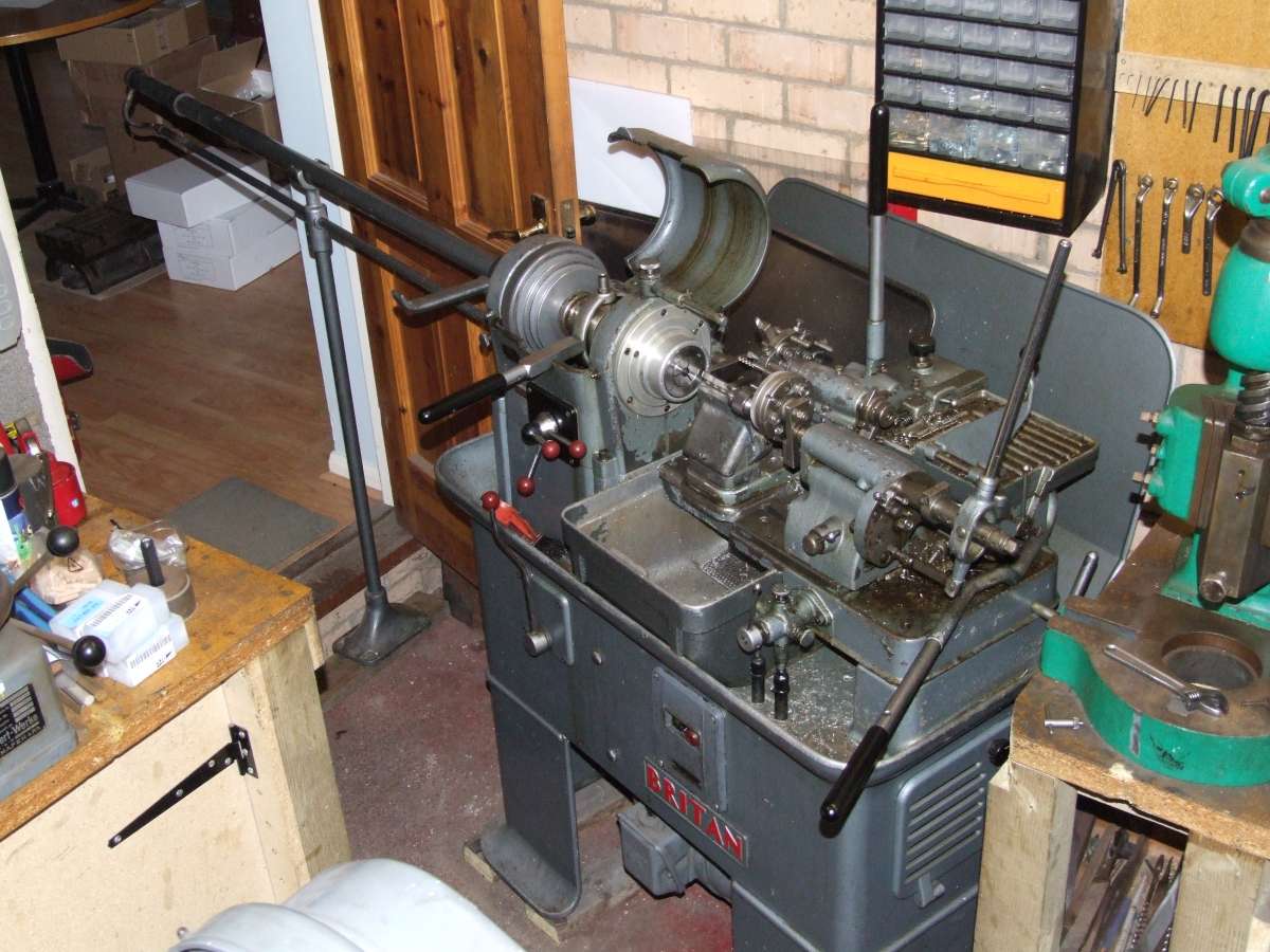

                                          #779008
                                          Julie Ann
                                            @julieann
                                            On baz Said:
                                            …I also have an Britan, 1 1/4 capacity a later version green one with bar feed, also got their four in a row tool grinder.
                                            My Britan is 1-1/4″ too, but the older, rounded model and it came with a lot of accessories. I was lucky to win a couple of Ebay auctions for Britan accessories soon after getting the lathe. The auctions included some collets for the 3/4″ Britan which I sold to someone with the 3/4″ model who made automata.
                                            Photo1 Britan Lathe with Bar Feeder
                                            Is your four in a row tool grinder the one that was on Ebay for some while?
                                            Julie
                                            #779012
                                            Baz
                                              @baz89810
                                              Julie,
                                              No my grinder came from Steve Holder at Home and Workshop at least 15 years ago, the Britan came from Javelin machine tools at Staines over 30 years ago, quite a bit of tooling included.
