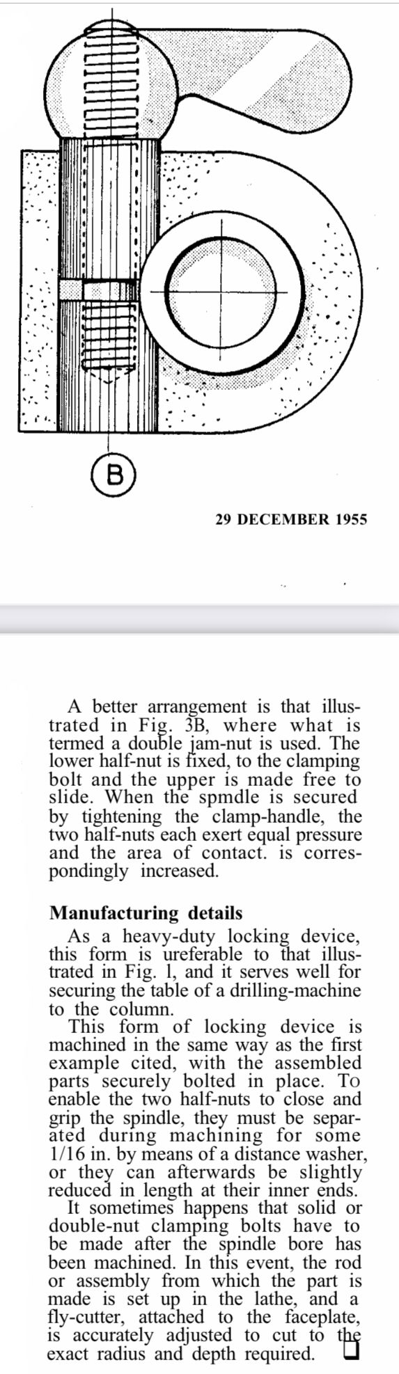

                                  There is an article by Duplex in ME on these devices 29 December 1955 if anyone wishes to look further.
                                  #551110

                                        Posted by DC31k on 24/06/2021 06:57:42:
                                        **LINK**
                                        https://www.madmodder.net/index.php?action=dlattach;topic=6941.0;attach=7950
                                        Note: … I think we might safely assume that, in the final section of that brief document
                                        ’ureferable’ should read preferable.

                                                      For what it’s worth … This appears to be the total extent of what [in that Duplex article] is specifically relevant to the subject of this thread.
