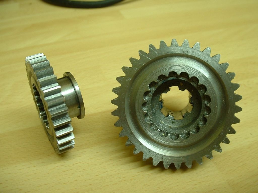

                          I cut the splines on this gear using a 'Stan Bray' toolpost slotting tool, and made the 'internal gear' by plunging in a 3-flute cutter – it only acts as a dog clutch on another gear.
                          Outer gear using the Ivan Law single point cutter method.
                          Two home-cut gears for Fordson Gearbox
                          #89192
                          Anonymous
                            Neil: Wow, those are pretty nifty gears, I'm impressed!
