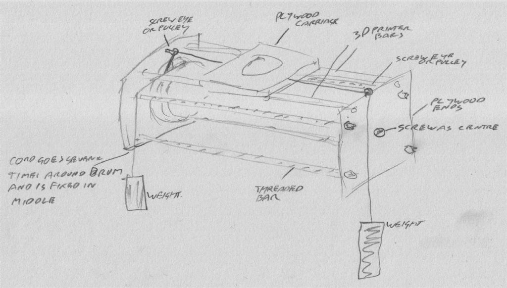

                    Hi John
                    The device Ian showed looks like it could perhaps be replicated using plywood plates for the ends and threaded rods and nuts to space them out in much the same way as a Prusa I3 is assembled. A plywood carriage could then carry the router, sliding along smooth rods with linear bearings (3D printer parts from eBay perhaps or just carefully bored holes in wooden blocks). The workpiece would be fixed to a drum and could rotate between screws in the centre of each end plate. As the drum is turned, the router would slide along 3.14 times the diameter of the drum for each revolution.
                    It is all a bit crude, so it would probably be necessary to tension the cord using two weighted cords pulling against it, one at the opposite end of the device to the drum, and one wound around the drum in the opposite direction. I suspect you would need to hold both the router and the drum to use it as it may not be that rigid.
                    No promises it would work, but it wouldn't cost a lot to try.
                    Brian

                                    Posted by john constable on 20/06/2018 14:53:19:
                                    .. The part I'm finding difficult at the moment is an arrangement to sync the travel of the tool along the work and the rotation of the work and do it in such a way that it can be changed easily for different pitches (in effect it's some kind of simple gear box needed).
                                    Going back to my Heath Robinson lash up, how about using a leadscrew (from DIY store studding) connected to the spindle by Delrin chain like this? **LINK** You could get 6:1 reduction with 8 and 48 tooth sprockets, so two pairs would give you 36:1 and a 36mm pitch using M6 studding for the leadscrew. Unlike gears, it would be easy to accomodate the spindle-leadscrew distance and a third wheel acting as a movable tensioner could adjust the chain when you changed sprockets.
                                    Meccano chain and sprockets would be a little more sturdy, but only offer 4:1 reduction, although it would be simple to combine this with gears and would allow a massive range of spiral pitches.
                                    Brian
                                    #358677
                                    john constable
                                      @johnconstable10725
                                      Posted by Brian G on 20/06/2018 15:59:45:
                                      Brian
                                      Thanks, Brian. That looks like the best type of hardware to use. I never came across Delrin before. I wanted to use meccano but as you say the choices are limited although someone mentioned a robotics supply site.
                                      How would you arrange the gears for different ratios? Would you use a pair for each different pitch you wanted and then just connect your chain to whichever you needed for each job? How would a moveable tensioner work? Would it need to move in a slot to take up the slack and then be held there with a nut or something?

                                        Brian G
                                          @briang
                                          Only problem with the cartridge arrangement is that you would have to use pairs of gear that had the same centre-centre distance, which limits your choices. As any useful twist would need double reduction (or more) perhaps the easiest thing to to with either gears or chain is to copy the "Banjo" of a lathe. Mounting the idler on a slotted part that pivots around the leadscrew would let you slide the gear/sprocket up and down the slot and lock it with a nut to set the distance to the leadscrew gear/sprocket, and rotate the whole arrangement to set the distance to the spindle. Otherwise you might just use a gear, pulley or even just a slipper on the slack side of the chain, sliding it along a slot and as you say, locking it with a nut – a bit like adjusting a cam chain.
                                          Lots of Meccano gears and sprockets here **LINK** (Never used them but I have been looking for gears for another project).
                                          Incidentally, if using chains you could use two screwed rods linked together to both move and support the carriage, probably cheaper and more reliable than smooth rods and linear bearings which probably wouldn't like sawdust.
                                          Brian
