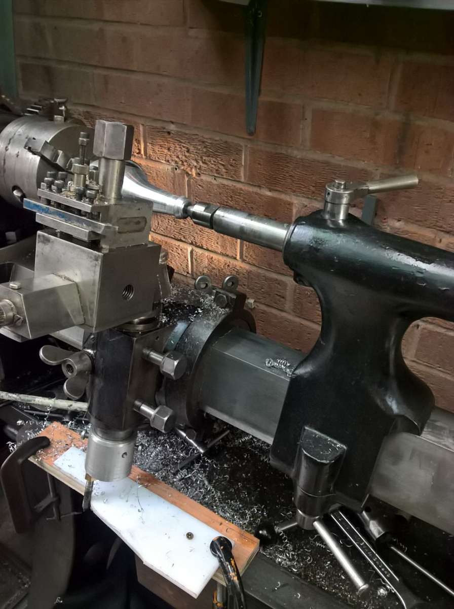

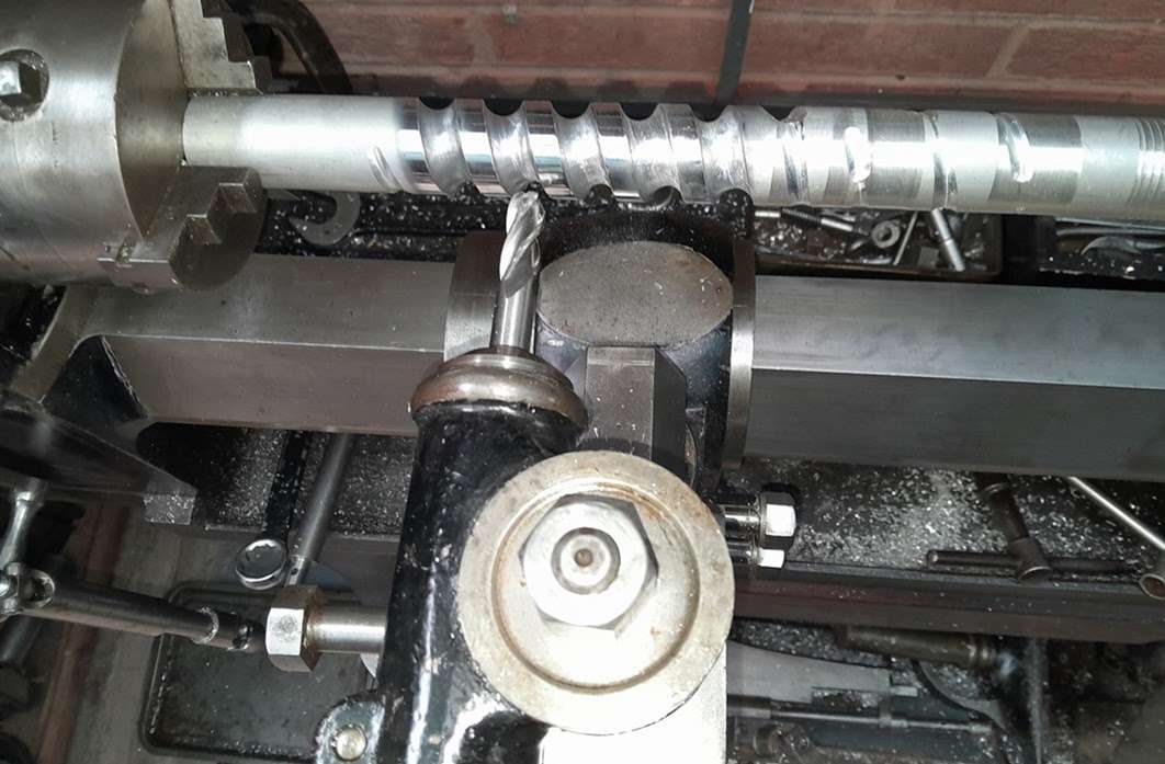

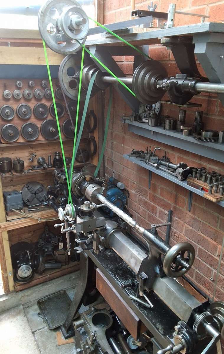

      My Pittler lathe is capable of many different types of turning and milling. Here I am trying out milling a spiral using the lathe being driven by the leadscrew itself via an overhead drive to the tailstock mechanism.
      The power then passes up through the reversing box and onto the headstock mandrel. The chuck and saddle will turn very slowly, dependent on the worm and wheel used. It’s most important that the headstock pulley is free to turn so the flat drive belt for this must be slackened off or temporarily removed. My video on Youtube can be seen here
      https://youtu.be/wOrPeptvLJ4?si=oRUHl6WAOwA0KK6i
      In total there are 4 belts running and 7 pulleys are used!  The cutter is a 1/2″ ball nosed endmill
      spiral close upsideways

        Neat.  Actually it’s a helix – not sure how you would mill a spiral on a lathe.

          Very interesting but needed to be stopped every few seconds as it was flying around too fast to take in the details. Alos liked the other videos you have on this lathe.
          Now I’m curious about the thing with a big hole in it under the lathe in the above picture.

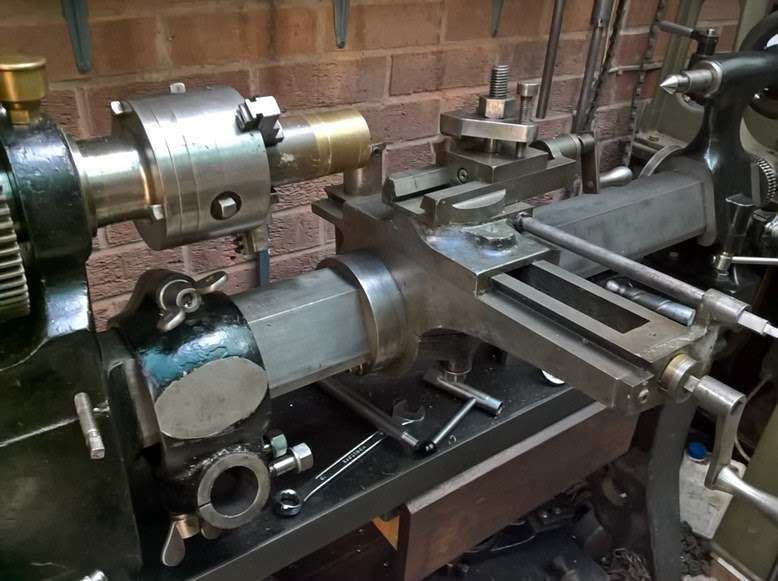

              It’s a rare Pittler radial compound slide, it has 3 handles compared to normal compounds with 2, the 3rd handle rotates the top slide. See:  https://sites.google.com/view/pittler-lathes/c3-lathe-menu/radial-compound-slide
              You can always pause the Youtube video

                  Maybe it’s a helix but mister Pittler would not agree as he has sections and tables in the catalogue under spiral cutting. Examples are shown of spirals cut on a round ball, all produced on this lathes standard equipment.

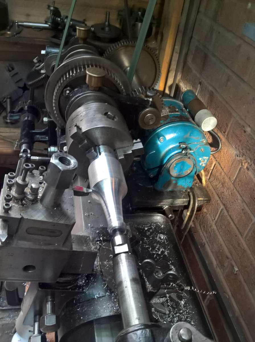

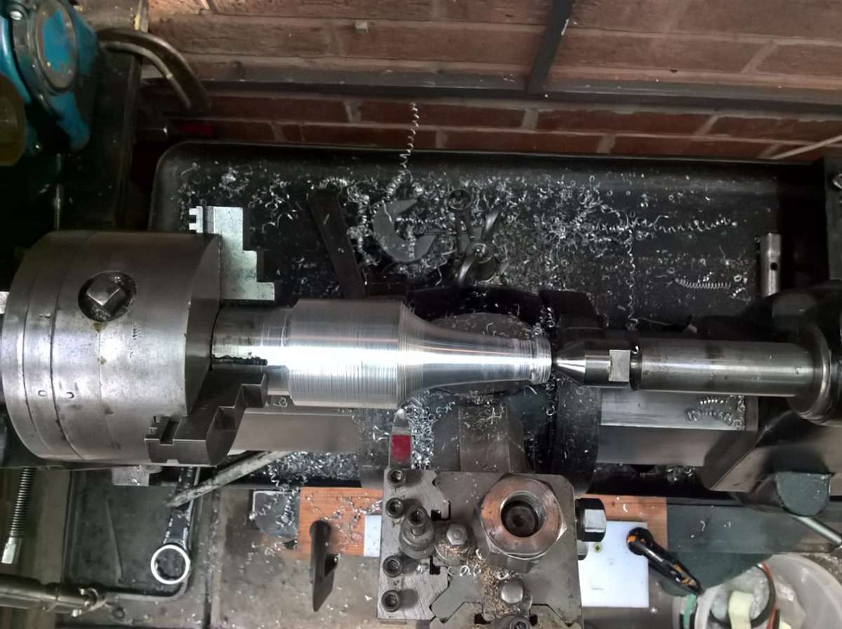

                                        Following on from my post above re spiral cutting and the refs to a fusee being more correctly called a spiral I thought I’d have a go at setting my Pittler lathe up to do an experiment re making one. I am using 2″ aluminium here rather than waste a good piece of expensive brass, also it’s in the chuck rather than between centres.
                                        Also using a plastic template for this experiment which seems to work o.k.  The lathes ability to swivel the round saddle casting is what makes this lathe different to the more usual.
                                        Using the lathes original copying attachment which fits on the bottom of the cross-slide shaft and either side of the saddle it is able to follow a template and swivel the saddle casting to replicate the pattern on the workpiece.
                                        After the shape is cut, and I’m not claiming this shape is exactly right at this point but near enough to show it’s easily possible to make a fusee on the Pittler lathe. Without altering anything except changing the cutting tool, selecting the gear & worm for a suitable tpi it will then cut the required groove for either chain or wire.
