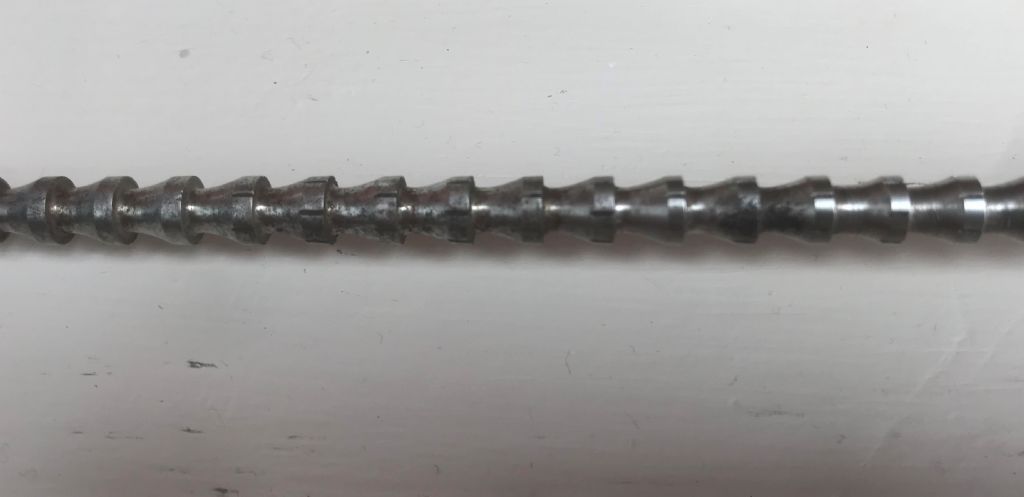

                              I have both T&J and 'Summit' brand adjustable reamers which will cut in increments of between less than a thou to around 3 thou as they have leads on their front edges of their blades. My experience of import adjustable reamers is that these do not have a lead on their blades, at least not on the ones I have seen.
                              For a definitive valve guide size with excellent wearing properties I have a selection of valve guide broaches. These were 'salvaged' from the Triumph Meriden factory when it closed. These broaches remove around a tenth thou per tooth and finish with a double sphere, giving a 'ballised' finish. For a job like Ian's I would seriously consider making such a broach – ream to -0.001" then finish with the broach.
                              Valve guides are a critical item in an engine – there are numerous examples of poor understanding of the required sizing and finish required in a guide. One of the latest examples was the McLaren MP4/12c which suffered repeated valve catastrophes (dropped valves!) during development which delayed the release of the car for 15 months whilst the problem was discovered and resolved.
                              I can post some photo's of the Triumph broaches if you need more information.

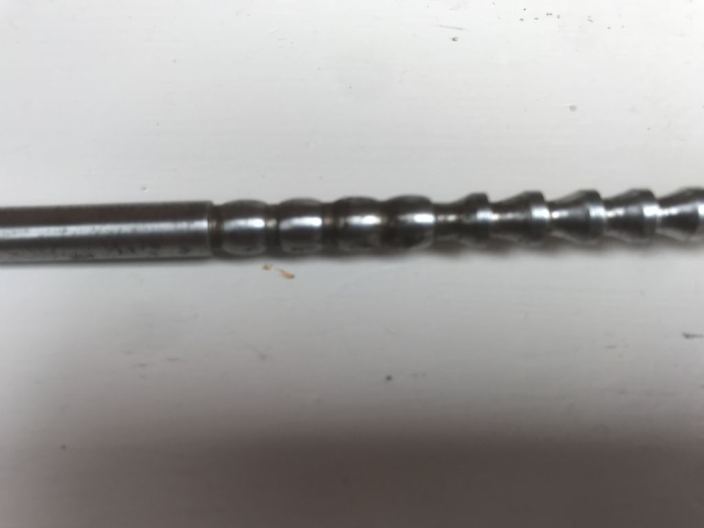

                                    #546155
                                    Oily Rag
                                      @oilyrag
                                      Here are the Triumph broaches – made by BSA!
                                      The etching on the broach says "BSA Broaches Co, MCO No. 2359?, ST 3828W, TRIUMPH" (the ? indicates 'unreadable' )
                                      Finally a close up of the 'Ballising' area:-
                                      The Ballising final size is 0.3142" for the final 2, 0.3141" for the 2 preceding 'balls' – the final cutting flute is 0.3140", and the first of the 5 final flutes is 0.3136" – note that these final 5 flutes are not 'rived'. the final 'rived' flute is 0.3135".
