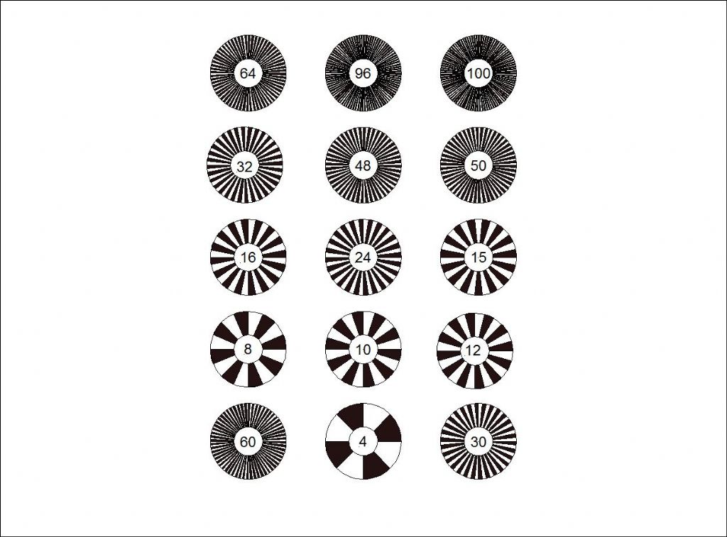

        I am using a Variable Speed motor drive on my Milling Machine and Lathe, these were fitted after purchase etc.
        I wondered if anyone knows of an easy / economical way of measuring the spindle speed to check Cutter speeds etc. RPM measurement.
        Any help would be greatly appreciated, Best rgds Chris

          Have a look at this.

            There was a artical in Model Engineer 6 Nov 1998 by Bill Stevenson in USA. His system is to use strobe discs (theres a page of them to photo copy),they work with 50cycle AC incandesent lamps.One site on the web also gives a single strobe disc that gives a speed range from 300rpm to 3000rpm in 10 stages. Ian S C

              I copied these discs as a check on the inverter set up on my machines and they are a good way of checking, I also have a separate commercial RPM strobe machine now should I need it.

                        As far as the strobe discs go there is a site on Google, put in “tony Jeffrees Model Engineering Pages” and look through that stuff. ypu’ll find a lot of other stuff as well.The model aeroplane tacho sounds good, don’t know if they are available here, must have a look. Ian S C

                                      I have a program that someone sent to me that is designed to produce the pattern for optical encoders. This could be used to produce strobe disks that can be printed out.
                          If anyone woulld like a copy send me your email address on this forums message system and I will attach it to an email.

                              Oh, if you want strobe patterns, the best thing is to do them in CAD, just takes a few minutes.  As an example, there is a JPG in my album of some I made when I was messing with the tacho.  I printed a bunch on a single sheet, to see what worked.  Funnily, one pulse per rev is as good as any…
