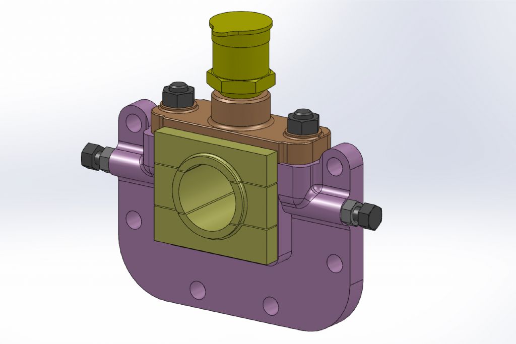

                  #479464
                  Paul Lousick
                    @paullousick59116
                    The crankshaft bearings on my Ruston are split horizontally. And are adjusted horizontally by the 2 screws on the side and vertically by shims under the retainer plate at the top.

                      #479489
                        "the brackets are not handed so the screws adjust in opposite directions!"
                        As the Little Samson has one bracket inside the hornplates and the other outside you should end up with both screws facing the same way
                        Fowlers used a similar arrangement to Paul's drawing but the horizontal screw was just at the front and the bearings in 3 pieces. However the 2" & 3" MJ Eng designs just split it horizontally and use the cap for adjustment.

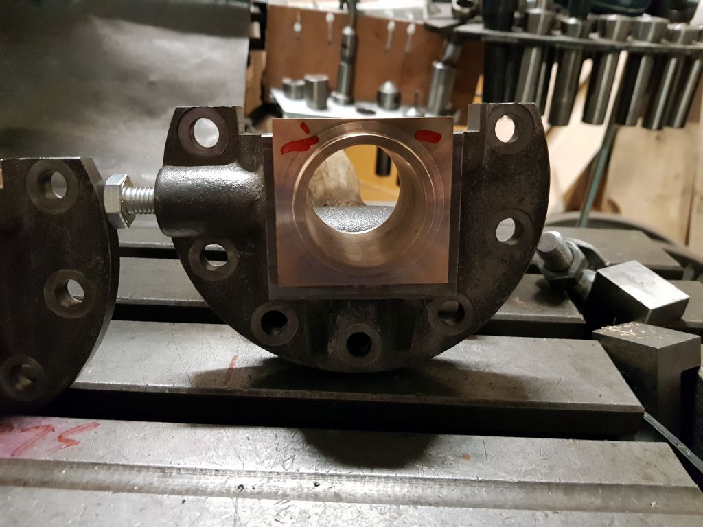

                          Mark Simpson 1
                            @marksimpson1
                            With a little care, and a lot of turning of the rotate table handle I've made the bearing from Edward's castings. Just need to add the studs and that's another piece tocked off the "to do" list
                            Paul. I also worked out that the holes were not possible to the dims on the drawing, so I respaced them having faffed around in CAD for a while to get some better looking positions.
