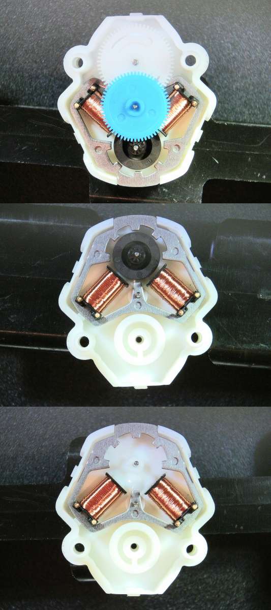

      Hi all – those old simple reliable mechanical speedometers, with the aluminium cup and rotating magnet, have been replaced, at least in the BMW, with insanely complex electronic ones. They have dozens of parts, including a high speed processor fgs, and Gb of flash memory with god knows how many millions of transistors etc in them!
      It’s an incredible waste of technology, imho, but the miniature pcb-mounted motor that drives the pointer (!! grrr) is cute.   There’s one in the enclosed pic in various stages of undress.  Would anyone like to explain exactly how it works? They’re about 20mm across, and have only four connections, two for each electromagnet. The black wheel is very lightly magnetised. I imagine the coils are powered alternately, but what stops the black wheel from just switching back and forth in the same position? And how does it reliably forward and reverse?
      Interesting, albeit infuriating!
      Thanks,
      SpeedoMotor_x3

      duncan webster 1
        @duncanwebster1
        It appears to be some kind of stepper motor

              John Haine
                @johnhaine32865
                <p style=”text-align: left;”>They are much cheaper than the mechanical type, easy to drive and would take a very small proportion of the available processor power.  Look on the Arduino support forum, for example, to see how they can be driven.</p>

                                      Graham Rounce
                                        @grahamrounce14492
                                        MichaelG: “Did you actually look…???” – Kindly don’t talk to me like that. I, and most people here, make the effort to be polite, fyi with no ill-effects.
                                        Here, for other folks’ benefit, is the useful bit:
                                        Automotive Gauge Stepper Motor (x27.168)
                                        I’ll have a look, especially at the datasheet, to see if there’s enough info for me to be able to make it do something 🙂
