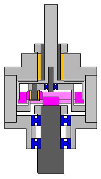

            John Stevenson 1
              @johnstevenson1
              Rod,
              I looked at this a while ago and wasn’t very impressed on the design.
              Basically it’s a 3:1 increaser and runs in reverse as mentioned before but it only has one planet wheel running round the sun with no top bearing support, in fact it relies on the one bottom bearing.
              The result is that the planet wheel wants to push the sun out of mesh. Dick hold the ring gear and drives the planet with the sun as driven, this gives the 3:1 increase in reverse.
              If he had driven the ring hear, held a pair of planets and taken the drive off the sun he would have got an increase of 4:1 in the correct rotation, this using all the same parts but one extra planet gear. Plus the ability to provide a top bearing for support.
              I can’t comment on Hemingway’s drawings which are usually good but the original MEW drawings leave a lot to be desired, for instance the sun wheel is missing and if you make all the spindle parts and come to assemble them, they are longer than the space allows.
              John S.
              #70502
              Roderick Jenkins
                @roderickjenkins93242
                John,
                Thanks for those comments. I bought the kit and started manufacture without really thinking about it but have now become uncomfortable with the design. Whilst it may be fine for engraving I do not think it is robust enough for a 3mm endmill.  The drawings seem fine but could really do with a cross-section. There are some 3D views but these do not show the critical internal workings. I’m drawing up the cross-section myself and will give serious consideration to your suggested improvements.

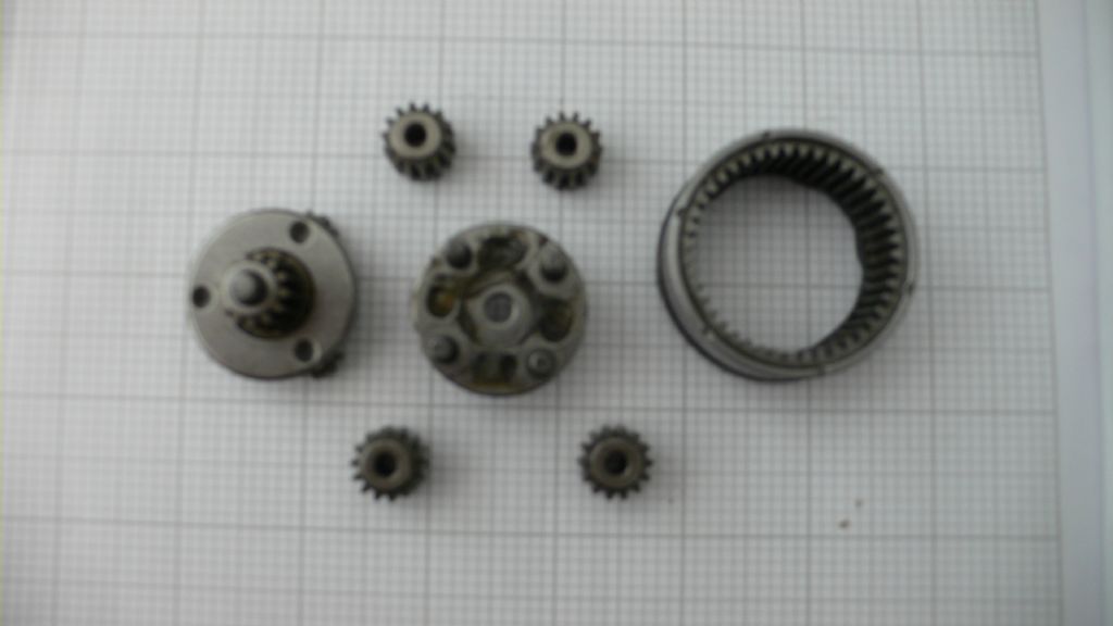

                  #70506
                  Pat
                    @pat
                    Hi Rod
                    I also had reservations about the torque that could be transmitted. So I started to look for a planetary gear box to act as a source of gears. I have now got the gear box guts of a Bosch industrial grade battery drill. Got these as a gift as the chucks had been wrecked and the retaining screw head chewed up.
                    The gears are designed to transmit torque. The gears and bearings show no sign of wear and the input to out put ratio is around five – difficult to hold the bits together with out the plastic case!
                    The planet gear cluster has four pinions and the over all diameter is 37mm. I will photograph the bits but may have difficulty posting so there could be a delay!
                    Phew!
                    Reagrds – Pat
                    Edited By Pat on 18/06/2011 15:41:42
                    #70554
                    Roderick Jenkins
                      I’ve created this cross section from the Hemingway drawings, the pink bits are the gears. Clearly some tweaking will be required on manufacture to get the gears meshing properly. I’ll make it according to the drawing and see how it goes. I am a bit nervous about locating the ball bearings using only Loctite but we’ll see. It can always be dismantled and modified later.
                      Rod
                      Edited By Roderick Jenkins on 19/06/2011 17:15:05

                                #101264
                                Sub Mandrel
                                  @submandrel
                                  A bit of lateral thinking – I made a toolpost drill/mill by fitting the planetary gearbox out of a broken portable drill into a steel housing.
                                  If you took the internals out of such a gearbox and fitted them the other way around…
                                  Note these gearboxes are two-stage, so you could just use one stage.
