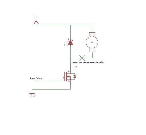

The PWM circuit in the article is rather like a water pipe (current in motor) with a fast tap (the FET) – but with no relief for the water hammer (the snubber is too small to do anything). It's subjecting the switch to the resulting voltage transient. "Avalanche breakdown" is where the switch breaks down and conducts, rather like a pressure relief valve. However, as the switch is passing both current and voltage simultaneously, it sees a high transient power dissipation which isn't good for it unless in moderation. Modern MOSFETs are inherently able (and optimised) to withstand some limited repetitive avalanche energy which is usually specified in the datasheet, whereas bipolar switching transistors which were the only commercially viable option 20 years ago don't like it. When they start to break down through overvoltage, there is a runaway effect called secondary breakdown that results in device failure.

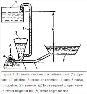

On a lighter note and in the spirit of enjoyment and enthusiasm, here's an interesting example of an hydraulic system that delivers water to a reservoir some height above the source. It's pretty much an hydraulic analogue of a "boost converter" which can boost a low voltage (eg 12V) up to a higher voltage (50V or more). It's the basis of many circuits such as power factor correctors (PFCs) used on the front of many VFDs for boosting mains voltages up to 400Vdc or more. Many of us on this forum are fairly intuitive and practical, so hopefully will find this kind of electrical / mechanical analogue interesting. You can't extend the mechanical model to explain all concepts in electrical circuits but it's a start. Once you begin looking into electronics, you find there's some pretty interesting stuff going on….

PS – here, the FET is valve 4 and the diode is valve 5.
