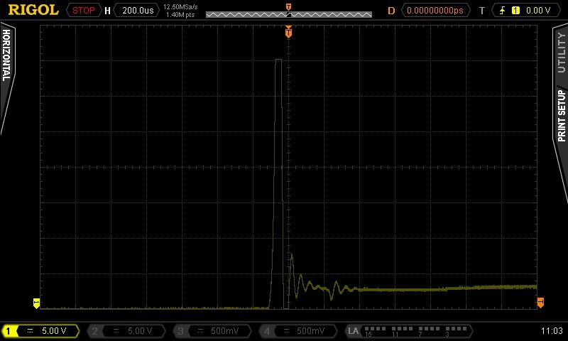

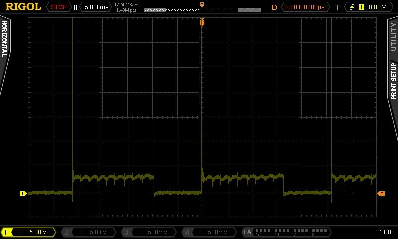

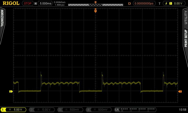

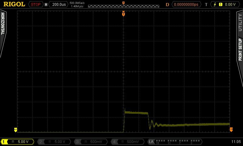

                                              #190884
                                                #190892
                                                TrevorG
                                                  @trevorg
                                                  Thanks Jason. First try so lets hope I don't mess it upwink
                                                  Effect of the Schottky Diode across the motor.
                                                  These DSO pictures show the effect of placing a Schottky diode across a 545 motor, taking ~1A, on a 7V supply.
                                                  The measurement is made across the power MOSFET being used as a switch. So the baseline is just above OV and occurs when the MOSFET is ON. When it switches OFF there is an inductive kick which is what we need to focus on. After the kick the voltage drop back to the motor generated EMF and the commutation spikes can be clearly seen.
                                                  Picture 1 – the schottky diode is fitted and the spike is limited to just over 7V
                                                  1 overview of waveform with diode fitted
                                                  Picture 2 – As above but picture is expanded to show the clipping of the pulse with the diode more clearly
                                                  2 switching edge with diode
                                                  Picture 3 – schottky diode removed – the pulse is now 35V high
                                                  Picture 4 – expanded version of Picture 3. The clipping of the waveform at 35V can be seen as the body diode in the MOSFET begins to conduct.
                                                  4 switching edge without diode
                                                  This makes the case for the schottky diode even at low powers on a small motor. The energy going through the MOSFET during avalanche breakdown at 35V will cause the MOSFET to heat up by a surprising amount. Much better to let a diode push it back into the motor where it will do useful work.
                                                  Trevor
