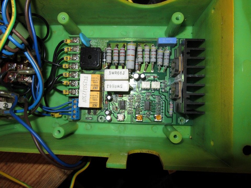

      Savinay Bhari
        @savinaybhari
        thanks again guys,
        my board is the very old FC250J, i have uplaoded a pic, i dont thing any connections will be wrong as they i have not changed anything yet and lathe was working when the ebay guy demoed it to me.
        how do i check R2 on the board? sorry i have no clue on electronics i am a automotive engineer by trade but mostly sit on desk all day doing paper work. i can handle mechanical things but no clue on electrics

        #184274
          Right, It's an FC250 – look at top left of the pic. Same as my old board.

            Hi Savinay,
            With the lathe unplugged from the mains and with the forward/reverse switch in the middle (Off) position with a multimeter connected to terminals P1 and P4 on the board you should get a reading of about 20k ohms. I expect that with the switch in the reverse position you will get the same reading but with the switch in the forward position the reading will be almost zero ohms. (I may be wrong about which position of the switch gives zero ohms.) Confirm which position of the switch gives the zero ohm reading in your reply. If R2 is open circuit I would expect you to get a reading of about 230K ohms. If my understanding of the way the circuit works is correct I do not expect R2 to be the cause of the problem. When the switch was in the reverse position (The position that caused the motor to run as it should.) did the speed control controll the speed smoothly and was the maximum speed correct. (Assuming you have a tachometer.)
            Les.

            Savinay Bhari
              @savinaybhari
              yes between p1 and p4 the resistance is 21.2k Ohms in both middle and reverse and drops to zero when put into forward.
              in terms of the running in reverse, i would say yes the transition from slow to fast was smooth, dont know if the speed is right as the motor is not connected to the lathe at the moment, since if i do connect it to the lathe the fuse goes eventually as the motor starts to arch so i dismounted it. so cannot be sure if its getting to the right speed and dont have a tachometer either.
              one odd thing in forward postion is, when the motor speed control knob is bought to zero and it clicks off (going complety anticlockwise), if i twist the knob even further anti-clockwise the motor flutter a bit on and off it doesn’t run but will kick to life then off then on and so on, the same does not happen when switch in reverse.
              In forward if the speed control knob is opened just a bit about 15-16 volts or so the motor can easily be noted to stop start stop start the stop are very defined. So definitely there is a voltage pulse coming on and off or AC voltage is being fead like. I can see the fluctuation on the volt meter too.
              Something I cannot explain is, in forward or reverse while connecting a multimeter to the motor output wire the voltage is read a steady 60V for example, reverse the multimeter contacts/or swap motor output wire and the voltage fluctuates 10-60-10-60v…. etc…. This is both in forward and reverse. But only affects the motor in forward. I don’t know what this is I cannot explain, how does changing polarity make the voltage fluctuate on the meter being DC?

              Les Jones 1
                @lesjones1
                Hi Savinay,
                The resistance readings confirm that R2 is OK and that my understanding of how that part of the circuit works is correct.
                The way the meter reading changes from a steady reading to a pulsing reading when the leadsare reversed is very strange. I would expect it to just change the sign of the reading. (+60V one way -60V the other.)
                Prior to yor last post my understanding was that the motor worked correctly when the switch was in the reverse position but after your last post I think you are saying that when the motor is put under a slight load by refitting it to the lathe the arcing on the comutator returns and the fuse blows. Is this correct ?
                Is the voltage rating of the lathe correct for your country ? (I assume that it will be as I do not think you travelled to a different country to buy the lathe.) What is the mains voltage in your country ? You do not even say which country you are from in your profile.
                Are you sure that you bought the corrct version of the motor to suit the voltage in your country ? There are different versions of the board and motor for 110V and 230V mains.
                I think you will have to find someone with a better understanding of electronics to help you. It is much easier to fault find when you are by the machine than to do so just by asking questions.
