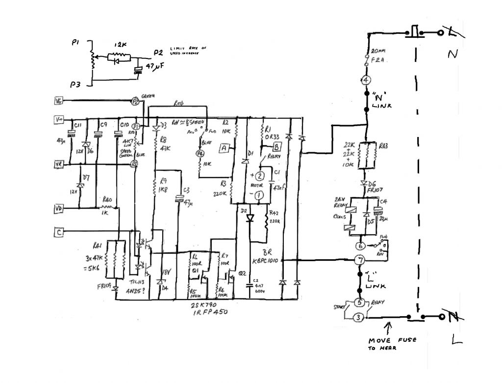

            #95843
            john swift 1
              @johnswift1
              Hi Kelvin ,
              I'm glad you managed to fix the problem
              I've had a look back at my e-mails for the 26th and 27th july but it looks like no e-mail alert to your first post had been sent !! hence no reply
              as you may of found , in addition to short circuited FET's etc another reason for the board to give you uncontrolled full speed is the 220K resistor "R3" going open circuit or high resistance
              the resistor connects the negative motor terminal 1 to the control circuit input "A"
              R2 and R3 form the potential divider that sets fraction of the armature voltage thats compared with the 0 to 12V control voltage from the 4K7 speed control potentiometer terminal P2

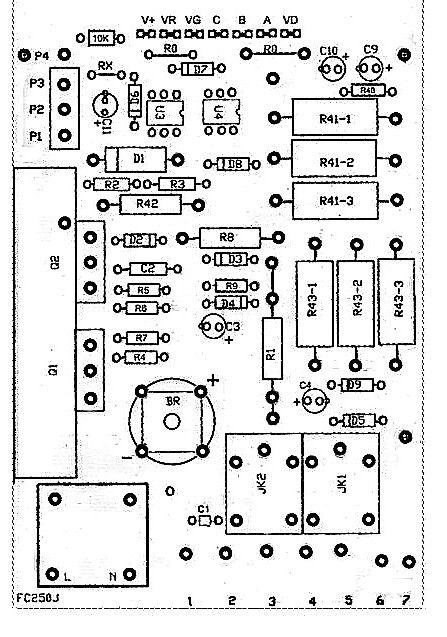

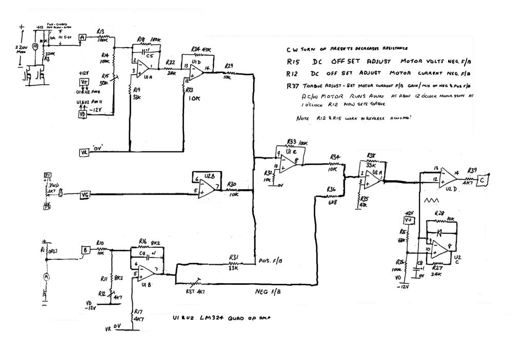

                  #96088
                  john swift 1
                    @johnswift1
                    Hi Kelin ,
                    yes I received the messages sent yesterday but I looks like you didn't receive the alert to the reply !

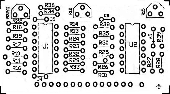

                    Message Viewer
                    on the original speed control boards
                    points A and B are two of the seven labelled connections
                    between the main PCB and the small PCB with the 2 dual in line IC's and preset potentiometers etc
                    if you have the later SMT version using the surface mount IC's you don't have the connections labelled
                    point B is the end of the resistor R1 (0.33 ohm on the 240v version ) connected to the motor via one of the relays and the voltage at this point is used to measure the motor current
                    point A is connected to junction of resistors R2 and R3 and is also connected to the terminal P4 via a 10K resistor
                    the voltage at point A is a measure of the motor armature voltage
                    when the forward motor direction is selected the 10K resistor is connected in parallel with R2 reducing the volt drop across R2 ( terminal P1 and point A )
                    as a result speed control circuit increases the armature voltage to re balance the circuit and the motor runs faster in forward than in reverse
                    the forward / reverse switch is a 4 pole switch
                    two poles are used to reverse the connections between the motor and terminals 1 and 2
                    and on the circuit diagram a third poles connects terminals P1 and P4 to increase the forward speed
                    remaining pole connects terminals 6 and 7 together when either forward or reverse is selected and but opens when off is selected
                    with the speed control fully anti clockwise , the "start" switch connects terminals 3 and 5 together, and provided a direction has been selected a relay will also connect terminals 3 and 5 to maintain the power when the speed is increased and the "start" switch opens
                    this relay interlock circuit provides the no volt release function to prevent the accidental restart of the motor after the loss of mains power and force you to start at minimum speed to protect the motor and control board from the high start up current that would result from starting at a high speed setting
                    in between terminals 4 and 6 , the circuit with the two 24V relays , resistors R43 diodes D5 , D6 and capacitor C4 is the equivalent to a 240V two pole relay
                    note when you re draw circuit of the main board R 41 is made up of three 47K resistors in parallel and should measure 47K / 3 = 15.6K (not 5.6K the 1's gone missing! )
                    Edited By john swift 1 on 10/08/2012 13:21:20

                      to save you looking back to the circuit diagrams
                      from post 7 on page 1
                      speed controlminilathe speed control
                      and the connections V+ , VR , VG , C , B , A and VD are shown on this one
                      main pcb silkscreen
                      note — it looks like it should be
                      V+ , VG , VR , C , B , A and VD   and not   V+ , VR , VG , C , B , A and VD as printed on the PCB
                      Edited By john swift 1 on 10/08/2012 14:32:23

                                                      There is ad difference between forward and reverse. It is not just a polarity change, the motor runs at roughly half-speed in reverse.
                                                      Looking at the circuit diagram HERE (earlier in this thread) which may be for a different board, it's clear that there is a half-speed arrangement operated by the switch but there are several connectors and a pot which could be playing up – but my guess is the 10K resistor R2 may be suspect, as in reverse a second 10K is switched in parallel across it.
