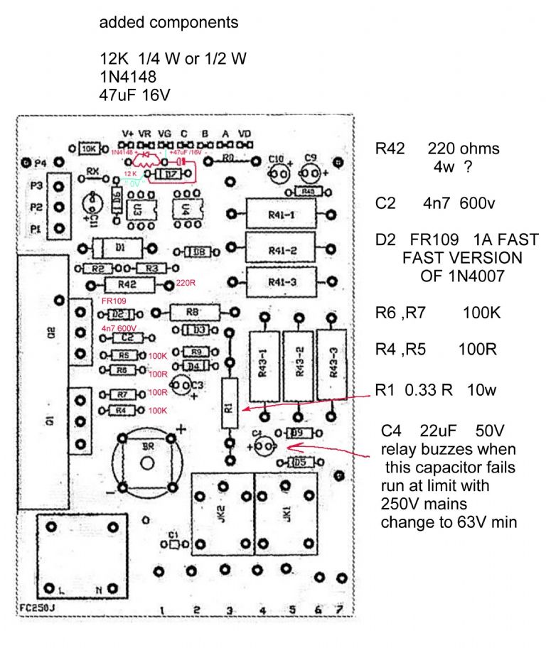

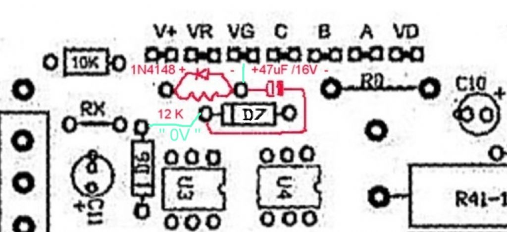

          >quote
          ………… on my board I replaced a link with a 1N 4148 diode and 12K,resistor
          and added a 47uF acpacitor , to make it like the later versions …………….
          ………………. Is there any other element to the resistor and cap’ spec?
          Such as Tant cap or resistor ratings, tolerences, wire wound etc?
          #63752
          flintlockand steel
            @flintlockandsteel
            Hi John
            I forgot to ask. P1-3 are these the little pre-set pots on the board?
            #63767
            john swift 1
              @johnswift1
              Hi Jon ,
              P1 to P3 are te connections to the speed control
              ( in the corner between the heatsink an the small pcb with IC’s on it )
              if you follow the copper print from terminal P2 ( this is the middle terminal from the speed control potentiometer)
              the link to replace looks like a resistor with one black band and connects to teminal VG
              on the small pcb.
              the control voltage at this point is only 12V at full speed
              the resistor I used was a 0.6W metal film resistor from maplin code M12K
              but any small 12K 5% resistor that will fit will do
              the capacitor is a 47uF 16v electrolytic (usually 20% tolerance) eg maplin AU01B or VH32K
              the negative end goes to the cathode of zenner diode D7 (and P3 , link RX )
              the cathode of 1N4148 connects to P2
              as you increase the speed the capacitor slowly charges via the 12K resistor
              but when you reduce the speed the capacitor quickly discharges via the diode
              to P2.
              note depending on the wires on the diode and resistor
              you may find it difficult to feed both wires through the board
              ps the presets are R12 , R15 and R37
              #63780
              flintlockand steel
                @flintlockandsteel
                Hi John
                Just to say thanks for all the info. After spending some time searching suppliers I went with Farnell as they don’t lock you in to large pack quantities. Also orders over £20 from UK stock are free shipping (min card order is £20). As it is it’s cheaper for me to drive to Leeds than order on line. Other suppliers were almost double the cost for the bits with their shipping charges.
                I may still need the odd pointer but hopefully all’ssorted and I’ll have a working lathe by the weekend.
                Jon

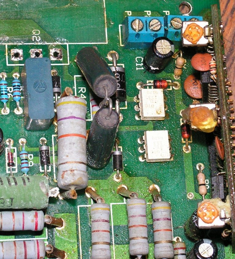

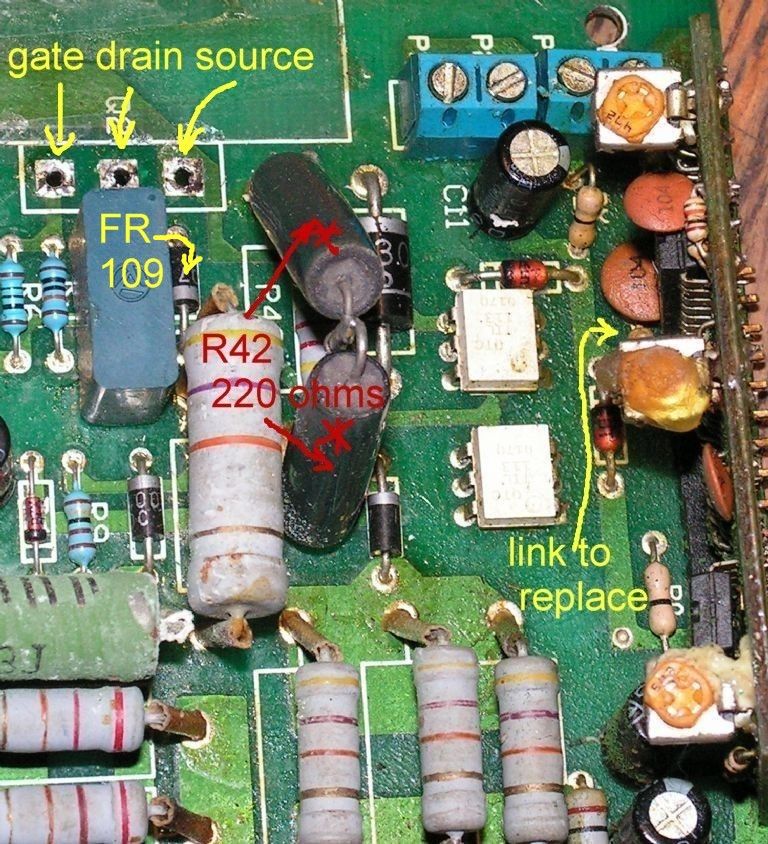

                  Hello John
                  I can see 3 resistor-like links (one of which is hiding under the middle pre-set pot in this pic. Just to confirm, is it the one next to the black cap’ (RX) , it goes to P1&3 (top side track), that I swap?
                  P2 looks as if it goes to R0 link.
                  Actually, is link R0 removed or just tied in?
                  Hopefully finally is it the black end of the diode goes to the P1&3 end?
                  Many thanks
                  Jon
                  #63842
                  john swift 1
                    @johnswift1
                    Hi Jon ,
                    the link is the middle link ,( one of two marked ” R0 ” )
                    hidden by the middle preset ( R12 the sealed current limit preset) in your picture
                    hope the pictues help
                    PS did you check the FET’s after you had removed them ?
                    Edited By john swift 1 on 09/02/2011 19:41:45
                    Edited By john swift 1 on 09/02/2011 19:45:32
                    #63844
                    flintlockand steel
                      @flintlockandsteel
                      Hi John
                      Yes 1 FET is totally gone, and the other is doubtful.
                      If I’m reading this correctly the diode & resistor combo replace the link while the cap bridges to D7.
                      What are the turquoise lines?
                      Jon

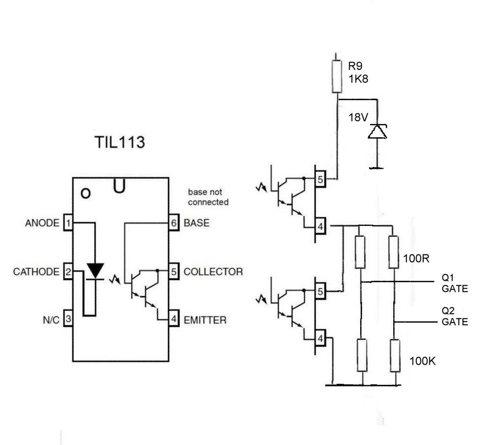

                      #63846
                      john swift 1
                        @johnswift1
                        Hi Jon ,
                        it might be worth checking the opto isolators have survived
                        if a fet was short circuit drain to gate
                        the transistor in the opto isolators can be damaged and the 100 ohm resistor connected to the gate
                        it looks like the 18V zenner and R9 (1k8) has been replaced
                        the isolators are switched alternately on and off
                        the gate voltage switches between 0V ( same as the FET source terminal) and +18v ,
                        PS   just incase
                           it may be worth testing the repaired with a 100W  GLS bulb in series with the mains supply
                        and a 15W or 25 W pigmy bulb as a dummy load , as in an earlier post
                         and checking the motor
                         PPS   the line just shows the  common 0V connection between the two 12V zenners
                                   D7 ‘s cathode where I connected the negative capacitor terminal
                                   and D6’s anode
                                   this junction is connected to P3 , the minimum speed end of the
                                   the short line from VG and the positive end of the capacitor is the
                                  printed circuit connection on the under side of the pcb
                        Edited By john swift 1 on 09/02/2011 21:07:03
