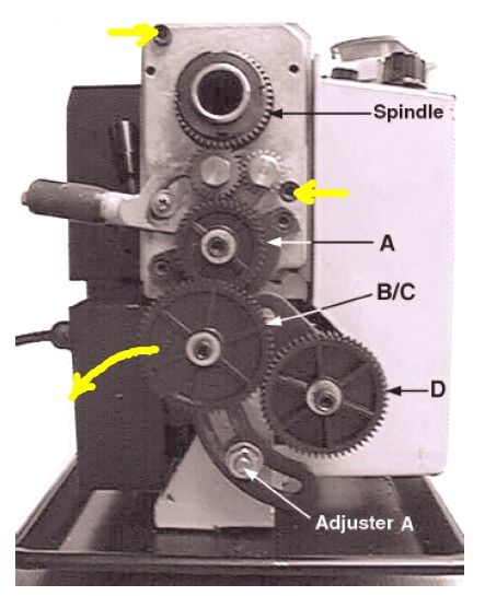

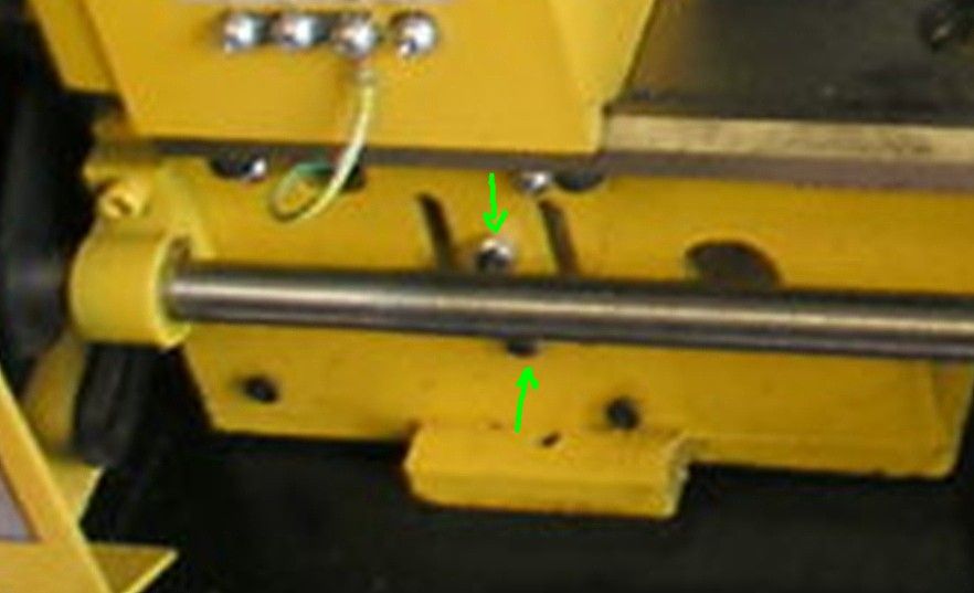

      Hi Daryl ,
      they don’t make it easy
      with gears B & C out of the way and the two M6 screws removed
      the die cast cover can be removed with the timbler assembly and gear A in place
      the problem is you have to remove / move  the control box to adjust the belt tension
      the wires should be long enough to leave them connected
      if your like me it will take a few attempts to get it right
      the grub screws only give you a small amount of adjustment
      they push on the motor body
      adjusting one screw in and the other out the motor is moved up and down a small amount
      the grub screws are just visible above and below the lead screw
      (the two studs holding the motor in place  are hidden behind the lead screw)

      Daryl Heasman
        @darylheasman56468
        Many thanks John ,there does not seem to be anything in the manual about it

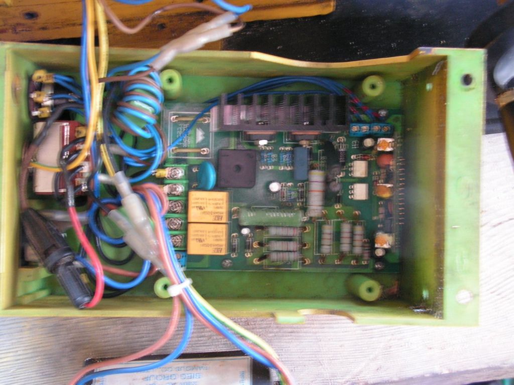

                        #63434
                        flintlockand steel
                          @flintlockandsteel
                          Hi
                          Not sure if this follows on exactly but I have a CL300m variable speed, except it’s not.
                          It’s either all or nowt. I was suspecting the pot but skimming the replies here, could it be the board?
                          I haven’t taken it out so I don’t know what number it is but it has large components standing off and a couple of large square yellow things to the left. Heat sink top.
                          I’d just like to swap it and get the machine running again asap.
                          Any ideas?

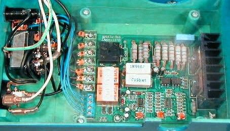

                          #63451
                          john swift 1
                            @johnswift1
                            Hi Jon ,
                            I assume your board looks like this
                            the two yellow relays on the left , near the terminals
                            form part of the interlock circuit that forces you to start at minimum speed
                            one of the common faults is the two FET’s ( on the heatsink on the right )
                            go short circuit and the motor runs at full speed
                            with the mains supply disconnected
                            if you measure the resistance between the gate and source terminals on each FET
                            you should be 50k (50,000 ohms)(outer 2 terminals)
                            between the drain and source should be virtually open circuit –
                            more than 20 M ohm (20,000,000 ohms)
                            even with a faulty speed control potemtiometer ,
                            the maximum speed in reverse should be about half the forward speed
                            the speed control is special 5k linear potentiometer plus a single pole switch
                            that you have to buy form the likes of machine mart , arc euro trading etc.
                            while it looks like the on/off and volume control on a radio
                            the potentiometer is linear not logarithmic and the switch is closed when fully anticlock wise
                            not open !
                            a new board from machinemart will be quick , but expensive
                            if in stock arc euro trade for example will be less expensive
                            if you decide to replace the FET’s your self
                            you can use two 2SK790 , IRFP450 or STW20NK50Z FET’s
                            either from RS components . Rapid online etc or ebay
                            Edited By john swift 1 on 03/02/2011 00:05:55

                                  flintlockand steel
                                    @flintlockandsteel
                                    Hi John
                                    My board looks like a little different to the one you show, the heat sink is at the top. I’ll post an image later on from which you may be able to determine age or other relevant specifics.
                                    Jon
                                    #63550
                                    flintlockand steel
                                      @flintlockandsteel
                                      This is the board my 300 has
                                      Note that the old fuse carrier has been replaced.

                                        flintlockand steel
                                          @flintlockandsteel
                                          Having now got the board out and tested I find 1 appears to be open circuit i.e. the reading just falls away to 0. The other reasd .2 on the 200k scale (digital meter). I was once a PCB draftsman but never fathomed the logic of operational circuits so hope I’m setting and reading this meter correctly
                                          #63558
                                          flintlockand steel
                                            @flintlockandsteel
                                            Is there anything to choose between these components?
                                            I looked at RS and didn’t see the 2SK790 ,
                                            The IRFP450 were £3.34 each and the STW20NK50Z £1.99 each.
                                            How often does this fault occur? I’m just wondering if it’s worth getting a second set.
                                            Finally the replacement fuse holder is inside the box, and inaccessable for a quick change if it pops. What’s the name for the style of holder normally employed and the fuse rating?
                                            Many thanks
                                            Jon
                                            #63570

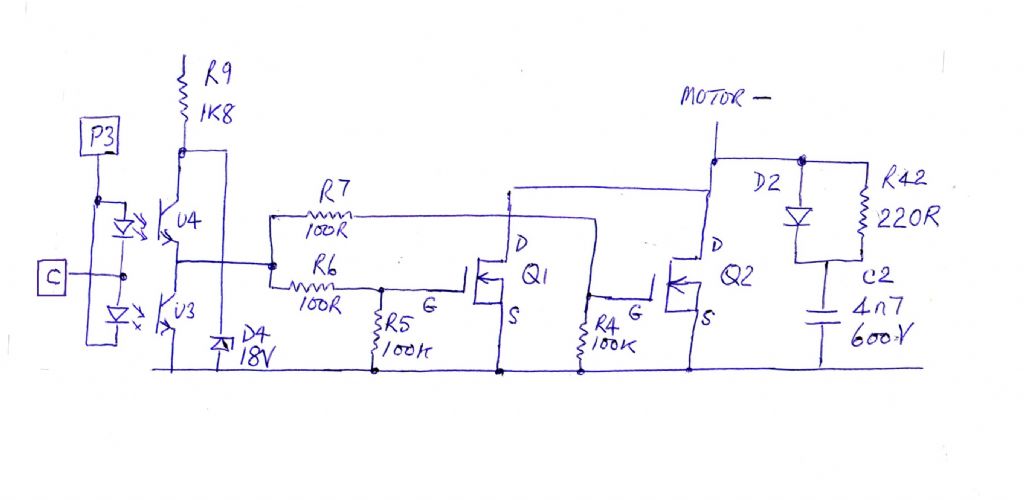

                                            john swift 1
                                              @johnswift1
                                              Hi Jon
                                              your controller is like mine !
                                              looking at your picture
                                              I it looks like the FET’s have been changed at some time as well as the resistors R4 to R7
                                              (R4 & R5 = 100k , R6 & R7 = 100 ohm )
                                              plus R42 ( 220 ohms ) in the snubber circuit – replaced by the two green wire wound resistors in your picture
                                              0.2 on the 200K range = 200 ohms, this could be the 200 ohms you measured if C2 is short circuit.
                                              the source and drain leads on the FET’s are connected together and should be
                                              high resistance
                                              ( depending on the resistance range your using you may see C2 charging )
                                              I’ll upload some pictures

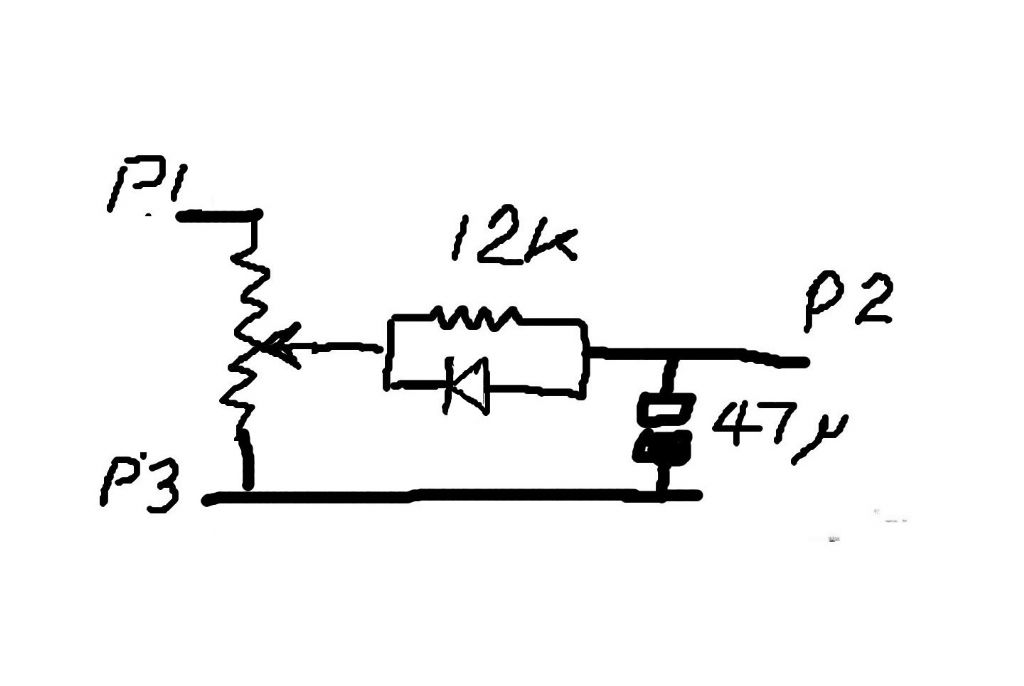

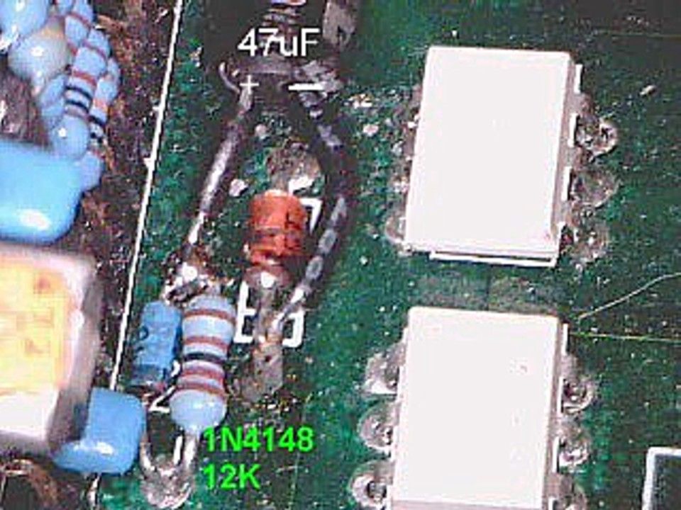

                                              ps
                                              on my board I replaced a link with a 1N 4148 diode and 12K,resistor
                                              and added a 47uF acpacitor , to make it like the later versions
                                              this limits the rate of speed increase
                                              if you rapidly turn the speed to maximum

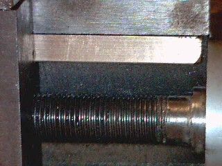

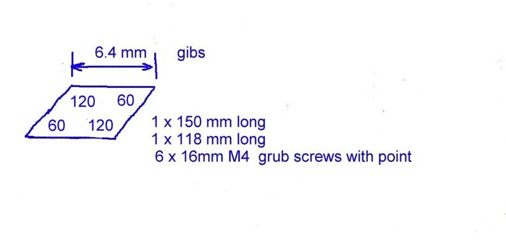

                                                  Hi Bill ,
                                                  the gibs are 150 and 118 mm long and possibly made from 10mm x 6mm stock
                                                  the original gibs are slotted where the grub screws are , this is a weak point
                                                  the new gibs don’t have the slots and are gripped by new grub screws with sharp points
                                                  with the brass gibs the slides moved more smoothly even when tightened more
                                                  than the originals ones ,
                                                  Edited By john swift 1 on 04/02/2011 22:42:18
                                                  #63580
                                                  john swift 1
                                                    @johnswift1
                                                    Hi Bill,
                                                    pictures of top slide gib in position
                                                    the new gib is a better fit than the original !

                                                      Hi Jon ,
                                                      I forgot to add
                                                      the 2sk790 is the FET originally fitted on my board 10 years ago
                                                      both of the other FET’s OK but as the newer stw20nk50z has the lowest on resistance and is cheaper thats the one I’d use
                                                      the FET’s tend to fail when the motor is stalled or fails its self
                                                      the correct fuses help
                                                      and the mod on the later surface mount versions that limit the rate you can increase the speed
                                                      this is the mod on my old board
                                                      the 12k resistor and diode is fitted in place of a link
                                                      that looks like a resistor with just one black band
                                                      Edited By john swift 1 on 04/02/2011 23:52:33
