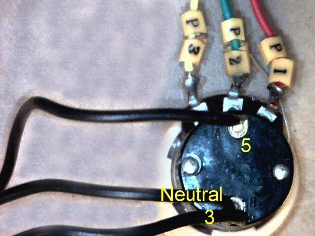

              Hi William ,
              the speed control is a special  5k linear potentiometer with a singl pole switch
              that is closed when the control is fully anticlockwise (part of the interlock circuit)
              this makes you start at minimum speed
              on my version of the lathe
              the forward/off/reverse switch is a 10A 250v    4 pole 3 way switch   , this is to stop you changing direction with the motor running
              2 of the poles control the motor direction
              the 3rd selects  the maximum speed  ,  reverse is about 50% of that  in forward
              and the remaining pole is part of the power control interlock –
              so the machine switches off as you change direction

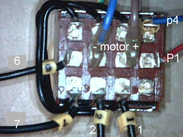

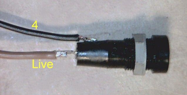

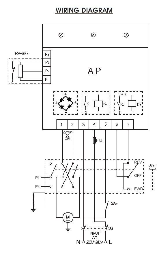

                    just some pictures of the control box wiring
                      (the first picture shows a later pcb than the board I have )
                    the motor running on 12v is a good sign
                    the brushes are about 14mm long when new
                    I’d expect to replace them at 7 or 8 mm
                    if you can look through the rear cover and check the commutator is still a copper colour
                    and not burnt black
                    ideally you need an insulation tester to check the insuation between the dc in wires and the motor body
                     but its worth checking it reads open circuit with a multimeter

                      Hi John,
                      Thank you so much for the trouble you have gone to, to send me photos and all the information, I am very grateful. I now wait for the unit to arrive from the states. I have only just realize that the states electrical supply is 120V, will this mean the the PCB controller will need some component changes to work in this country or even worse that the unit will not work here at all? Or do they use some form of step up transformer in the states to make the lathe work?
                      I have just one other question that I cannot see from the photographs. Does the power chord hook onto the emergency stop button. From the circuit diagram it looks like it does, but the guy from the states said it hooks onto the main PCB board. If this is true I cannot see how. Look forward to your reply.
                      Kind regards,
                      Bill Smiles.

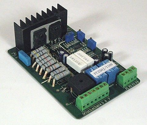

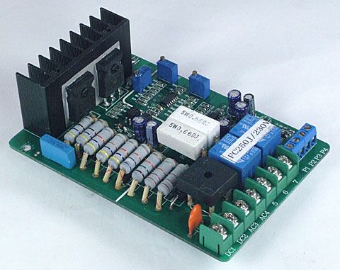

                          Hi Bill ,
                          just checking  did you order part number 3200    the 230v kit
                          or part number 3042  the 110v version ?
                          if you can stop the order and reorder the correct one
                          if you look at the boards the 9 large resistors along the edge of the board and 2 x 5w
                          resistors in the centre of the board
                          determine  the voltage the board works on ( just need to confirm 24v relays are used on both boards) so it should be easy to convert the board if you had to
                          the LMS control board is pn 1336 for 110v and 2526 for 230v
                          (have a look at the picture in my post to Richard on 10/08/2010)
                          do you have the mains cable (124), motor cover (151) cable gland(152), protector(174)
                          (marchine mart part numbers HT300M151 HT300M152 , HT300M124 , HT300M174)
                          yes the mains cable connects directly to the red stop switch
                          a wire on the fuseholder and on interlock switch on the potentiometer
                          then plugs onto the switched mains side
                          Edited By john swift 1 on 23/11/2010 10:40:49

                          #59192
                          john swift 1
                            @johnswift1
                            Hi Bill ,
                            just an update
                            having had a close look a at my circuit and some info of the web
                            it looks like 2 or 3 surface mount resistor may need changing
                            this is were I need to have the circuit or a high resolution photo of a 110v board
                            to read the values of the surface mount resistors
                            still a viable plan B , if exchanging a 110v board is expensive
                            Edited By john swift 1 on 23/11/2010 15:09:01
                            Edited By john swift 1 on 23/11/2010 15:10:27

                                      #59220
                                      john swift 1
                                        @johnswift1
                                        Hi Bill ,

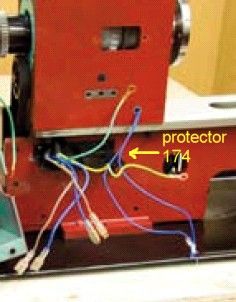

                                        the extra 2 blue wires that go into the headstock go to a microswitch
                                        on the chuck guard
                                        this switch is not fitted on our version of the lathe
                                        the photo was the best I could find to show the protector in position
                                        the only manual for the lathe to download from machine mart  is for the latest version
                                        ( I have a pdf copy of your manual )
                                        the main change is the use of the xmt2325 control pcb
                                        Edited By john swift 1 on 23/11/2010 22:25:58

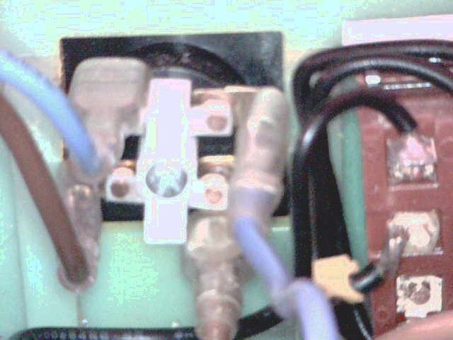

                                              Hi Bill ,
                                              thats good , only taken a week at this time of the year
                                              because the box is plastic
                                              a short wire connects the switch body to one of four  earth points on the head stock
                                              in addition to  the motor , and mains cable earth
                                              on your picture you will see four screws with  star washers to secure the earth wiring
                                              ( only three used )
                                              I expect the one earth wire  in your  picture is from the motor body
                                              the motor cable and mains cable passes through the same hole the the bed
                                              the plastic protector stops the wires being damaged by the leadscew
                                               four counter sink screws ( m5 x 10mm ) are just used  for fastening the control box to the headstock and bed – don’t over tighten , you could split the plastic !

                                                  lucar boot    FE65V  for 1/4″ connector HF10L
                                                  fuse holder boot FT35Q extra insulation not on original
                                                  just ensure the LIVE connection is to REAR terminal and not the side terminal
                                                  ( if you remove a good fuse with the power on , you could get a shock if
                                                  you have  it the wrong way round )
                                                   wires P1 to P4   can be connected with wire like    3A  equipment    FA36P    16/0.2
                                                  the motor wires have as smaller f/m lucar terminal to fit the terminals
                                                  on the forward /reverse switch  –  4.8mm  N35CY
                                                  add cable markers to make it easy to identifiy the cables
                                                  if you don’t have one
                                                  the plastic cover for the pcb is    133mm x 114 mm  , 0.2 mm thick
                                                  i made an extra  one , about 25mm longer , with the extra bit bent at right angle to
                                                  make contact with the headstock
                                                  hope this helps
                                                  Edited By john swift 1 on 03/12/2010 00:20:31
                                                  Edited By john swift 1 on 03/12/2010 00:21:52
