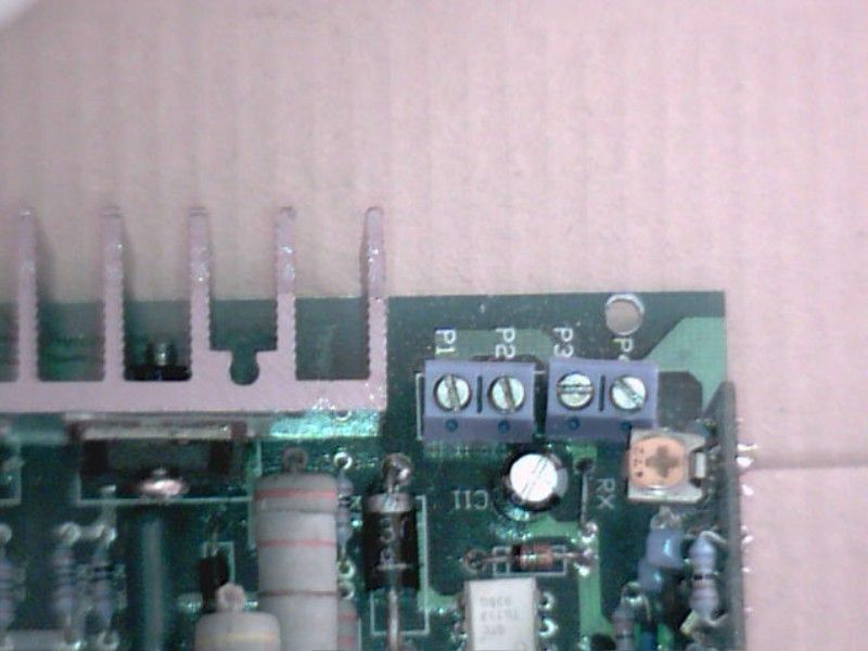

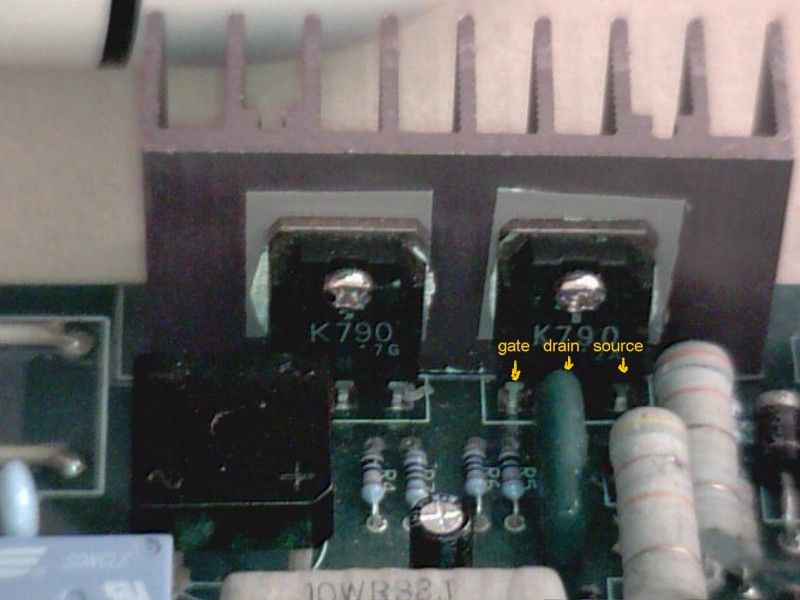

                john swift 1
                  @johnswift1
                  Hi Daryl ,
                  if the control pcb is a FC250 J type old or new version
                  ( have seen one version of the sieg C3 lathe using a xtm…type of controller
                  the control panel has a amber overload light )
                  first check the resistance of the two fet’s on the heat sink
                  the resistance across the out side leads should be 50 000 ohms ( the two 100k resistors connected to the gate and source )
                  all other combinations over 1 000 000 ohms
                  if one is short circuit replace both with  IRFP450 (eg RS components pn 541-0058 @£3-34)
                  if the fets are ok  , check the speed control
                  the voltage between terminals p3 and p2 varies from 0 volts at minimum speed to
                  +12v at maximum
                   even with a faulty speed control potentiometer that gives you maximum speed all the time
                  the output should drop when you switch from forward to reverse — do this test with a 60 or 100w gls bulb instead of your new motor !
                            John Swift
                  Edited By john swift 1 on 17/09/2010 23:44:36

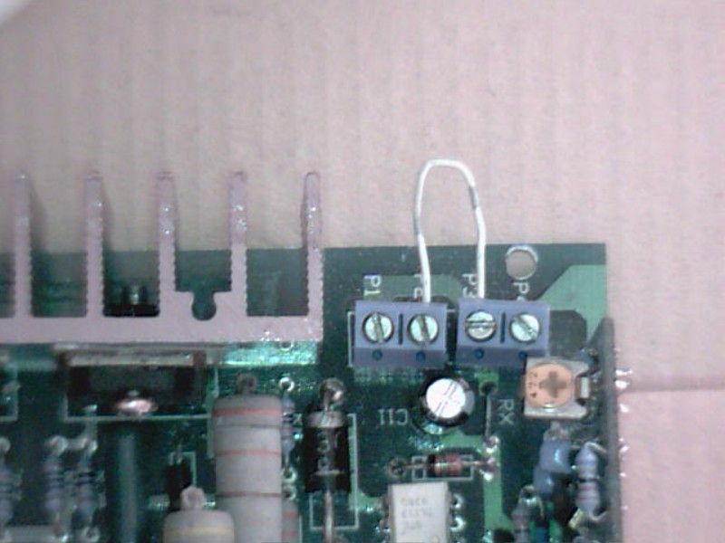

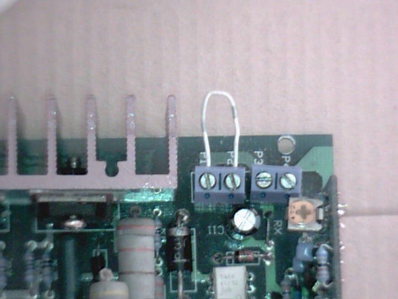

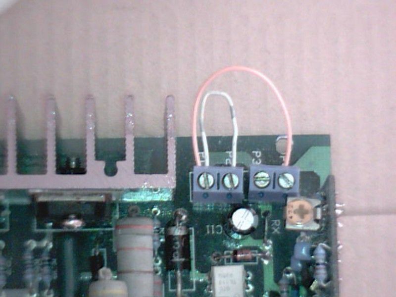

                      #55848
                      john swift 1
                        @johnswift1
                        Hi Daryl ,
                                       hope the photo’s help
                        the resistance between the gate and source terminals is 50K
                        all other combinations over 1m0  ( virtually open circuit )
                        you can test the board to some extent with out a speed control potentiometer
                        you can fit wire links for min speed , half speed ( rev full speed ) and  maximum speed
                        p2 + p3 ,  or    p1 + p2       or      p1 + p2 +p4
                         remember all the pcb is live ! and use a tungsten lamp as a load , not the motor
                               john
                        ps        on later the version of the pcb all the terminals are in line on one end of the pcb
                                    and the fet are IRFP450’s
                        Edited By john swift 1 on 18/09/2010 14:55:25
                        Edited By john swift 1 on 18/09/2010 15:18:33
                        Edited By john swift 1 on 18/09/2010 15:23:13

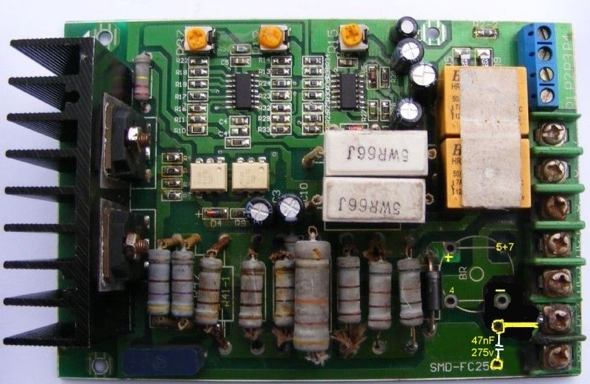

                        #55855
                        Daryl Heasman
                          @darylheasman56468
                          Hi John the last picture of your post ,is this the old pcb or the later one as this board is the same as mine . The reason i ask is that Clarke sent me pictures showing this as the old type board,so now confused
                          regards
                          Daryl
                          #55858
                          john swift 1
                            @johnswift1
                            Hi Daryl ,
                                            the last picture is the later version with the surface mount components
                            the other pictures are of my old control board
                            the FET’s you need to check are on the heatsink , on the left
                              if you disconnect the 5 wires from terminals P 1 to P4    ( the blue connector)
                            and link P2 and P3 the motor should run at the minimum speed unless the FET’s are short circuit
                            connect a test lamp to terminals DC1 and DC2 instead of the motor
                            until you have fixed the fault
                            applying full power to the motor with out starting from minimum could damage it

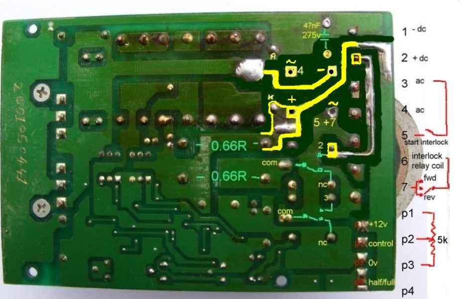

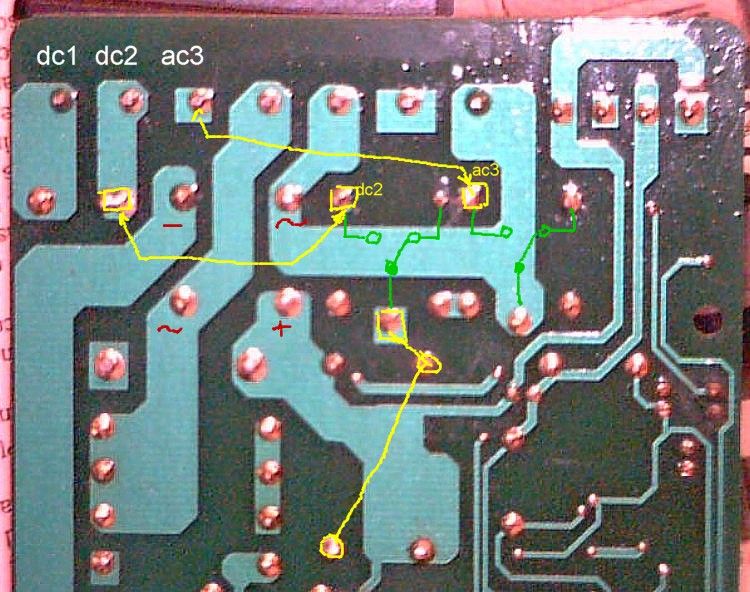

                                robert glover 1
                                  @robertglover1
                                  HI’ all I am new to this site and wonder’ if someone can help me ‘ I have had a short caused by rain water ‘ and have blown  my SMD-FC250J circuit board it’s that bad’ part of the tracking has gone’ and I am not sure what the missing part should look like’ it’s missing the part on the rear face under the DC1 DC2 connections. Anyone have a photo of the back of the board so i can repair it? I know it may not be worth the effort but I would at least like to try’ as the conponets that you would think should have gone seem to be ok.  THANKS A LOT Bob.

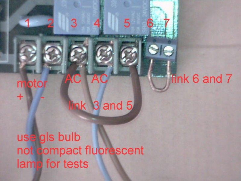

                                  #58881
                                  john swift 1
                                    @johnswift1
                                    Hi Bob ,
                                    do you have a picture of the damage ?
                                    hope this helps
                                    check the bridge rectifier and fets are ok
                                    and the pcb is not burnt between terminals dc2 and ac3
                                    for initial tests wire a 60W or 100W gls bulb in series with the fuse
                                    and a 15W pigmy bulb in place of the motor
                                    ( the 60 / 100W bulb will limit any fault current if any short circuit still exists
                                    the 15w bulb is just a load / indicator )
                                    #58918
                                    robert glover 1
                                      @robertglover1
                                      HI john thanks for reply’and photo’ but it does not look like mine? are there 2 types? see photos.   The board went with hell of a POP   but did not blow the bridge rectifier or the motor’ I have had the motor tested by my nephew who works for a rewind company and it’s OK’ and I have sort off figured out the component side of the CB there is a bit of L shaped tracking missing between DC2 and the rectifier leg’ also there is a capacitor next door to the rectifier; do you know it’s value?. I have repaired the hole since the photos  John don’t know whats gone wrong with photos they seem to have got lost must have done something wrong? they only place they show up is in albums?
                                      ‘ so any MODS and NEW tracking will need to be done on the back of the CB’ if I can find out what it looks like. PS.  I took the rectifier out for a better photo.  Can anyone help with a photo. THANKS AGAIN JOHN regards Bob.
                                      Edited By robert glover 1 on 17/11/2010 20:06:52
                                      Edited By robert glover 1 on 17/11/2010 20:13:36
                                      Edited By robert glover 1 on 17/11/2010 20:31:03
                                      #58922
                                      john swift 1
                                        @johnswift1
                                        Hi Bob ,
                                        your board must be the first version of the SMT boards
                                        the circuit should the same as the old board I traced at the begining of the year
                                        the missing capacitor is 47nF 275v and connects across terminals DC1 and DC2
                                        the 0R33 10W resistor on the circuit for  my old board
                                         is 2x 0R66 5W in parallel on the SMT boards ( electrically the same)
                                        the pcb picture I had is for a later version with the smaller 4 pin opto isolaters
                                        replacing the 6pin (white) ones on your board
                                        plus a simple circuit mod  to limit the rate of speed increase if you turn the speed control  rapidly to maximum
                                        so I’ve made some notes on your pictures
                                        I think I’ve worked out the missing print ?
                                         good luck
                                        #58939
                                        robert glover 1
                                          @robertglover1
                                            HI’ john thanks a lot for taking the time to do the mods on the photos’  BRILLIANT work’   up to now I have got as far as repairing the hole and replacing the missing  L  shaped tracking on the component side of board’  it looks quite good.   I used a thin piece of copper sheet’   I would have posted a photo’   to let you see how I did it’  as the idea may come in handy sometime’   but being new to this site’  I dont want to make a hash of it’  as I seem to have done last time.   What I could do with is some kind soul to do me a walk through on how to post PHOTOS’ as I am fairly new to computers.    MANY THANKS AGAIN FOR THE TIME YOU MUST HAVE TAKEN’  REGARDS   Bob.
