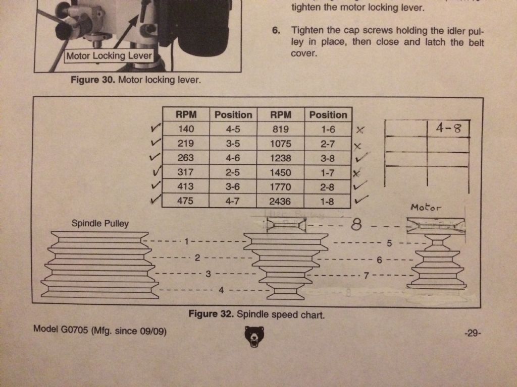

        If you have a mill/drill where there are 2 'V' belts to change to get the right speed, You know what its like, you seem to have to take the upper belt off, then the second belt so that you can select the right speed.
        My belts were a bit tired anyway, so I have bought 1 x motor to intermediate pulley and 2 x intermediate pulley to spindle. Ie I have a belt either side of the motor belt (Does this make sense ??) which can be used, but not at the same time.
        Motor==========I/Pulley SPINDLEpulley
        Pulley ======================
        Now – why do I do this – Simples (Merecat language). The upper belt can be used for a motor /intermediate pulley combination without removing the motor belt and the lower belt left in the guard tray, and the lower belt taken off the tray for those combinations of pulleys below the motor /intermediate (The upper belt having been taken off completely).
        It may have made more sense to have 2x motor belts as the motor tension is simple to change anyway. But that was an afterthought.

            I have been scratching the grey matter – again! I have a cunning plan, If I add 2 additional pulleys one each on top of the motor and the other on top of the intermediate pulley (centre pulley), I can get most of the available speeds without having to totally remove the final drive belt. Owners of these mills (without VMC drives etc) curse at the awkward way of changing from low speed to high speed ranges.
            I think that I can find a way of adding the new pulleys (famous last words), but can others see a problem. The attached diagram shows the new pulley set as ——– 8 ——-. I havn't worked out what speed ratio 4 – 8 will give me, but may work that out tomorrow when next in the workshop.

                D1 is the motor pulley, D2/D3 are the intermediate pulley and D4 is the spindle.  Adding a 5" pulley on top of the motor pulley and a 2.25 into the top of the intermediate pulley. The following changes could be made without totally removing any belts, just moving up and down.

                  Bit the bullet the other day after a hectic week of belt changing, picked up a piece of Al at the metal recycling yard – probably a roller off a conveyor belt – scrap price 4euro/kg Made up 2 new pulleys and attached them to the motor and intermediate pulley – Happy lad now.
