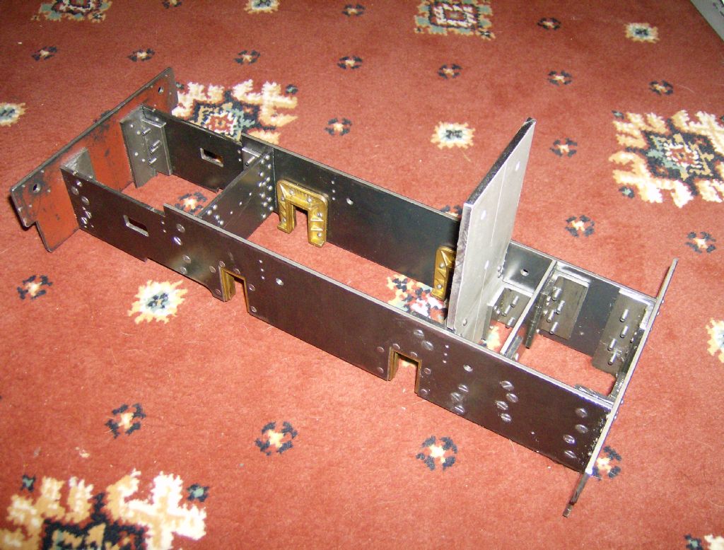

                      Andy, your drive train looks quite modest compared to mine – the motor I’ve got is 4 1/2″ long and 3″ diameter! I’m less worried about not having enough power.
                      This is my chassis, sorry about the carpet

                          Lack of phosphor bronze has put a brake on things. To keep some momentum I just turned up a set of buffer stocks, quite an interesting job as they need finishing both ends and there isn’t a lot to hold on to. In the end I bored out the centre shaped the ends, and then used a parting tool to create along neck 6mm diameter before parting off. Luckily I found some wonderfully free-cutting 3/4″ hex that was in one of the last ‘Whistons Metal packs’ from Proops – parting it was like cutting butter.

                            Hi Neil, not my colour, but I can’t see any problem with the carpet. Neat work on your chassis BTW.
                            Regards Nick.
