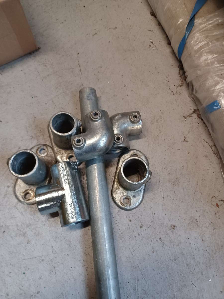

                            #740644
                            David George 1
                              @davidgeorge1
                              I have some spare 42mm diamiter standard handrail galvanised pipe and fittings. Not needed anymore.
                              20240711_073049
                              David
