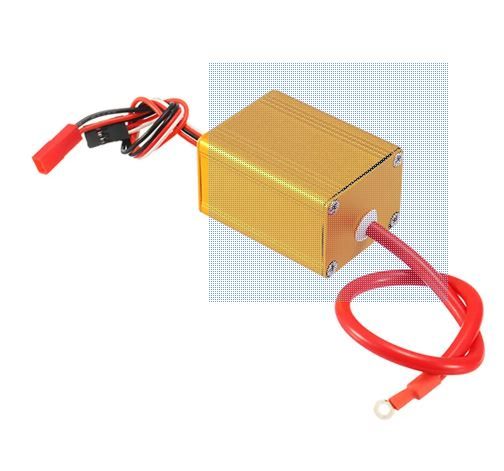

      I'm building a slow revving single cylinder I.C. engine and intend to use a Chinee ignition unit with potted components. (Sold as a spare part for the Chinee hit n miss engines).
      The spark plug lead is red and I want black. Is there any electrical reason why I cannot solder a black lead onto the (shortened) red lead? I did think about covering the red lead in black heat shrink sleeving, but that would make it very bulky.
      I'd rather not receive suggestions to alternative ignition systems as I already have the mentioned item.

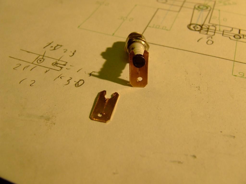

      While in questioning mode, how do you make the spark plug clip – the type that slides on the groove at the end of the plug? I've tried drilling a piece of brass and slitting it, but that soon loses its spring. Spark plug size is 1/4" x 32 if that makes a difference. The modern type that are usually covered in a boot is not what I'm wanting.

                      Guys, the ignitions in question are small CDI units (Capacitor Discharge ignition) so no big coils or traditional HT leads so just a circuit board with a Silicon insulated copper wire to the plug, not sure if Dave's cheap one will even have silicon may just be PVC. All in a match box size enclosure.
                      Also like me he likes an engine that looks like the original so no big rubber or metal spark plug caps, R clips, thick HT leads etc
                      Those are Futaba style plugs on the other wires for an idea of size.

                      Roger B
                        @rogerb61624
                        You shouldn't have a problem joining the plug leads, but leave as much of the old lead as you can in case you have to remake the joint later.
                        I have made clips for that type of plug from phosphor bronze sheet that retains it's spring.

                            Jason's hinted at it a couple of times, but just to be completely clear ignition is a high-voltage application and I don't think any old black wire will do. Whatever is substituted for the red wire needs to be well insulated, hence mention of test-meter wire and silicon.
                            Other than red suggesting a shock hazard the colour doesn't matter, but the connection needs to be some form of High Tension cable. Not so much for safety, but good HT insulation makes sure all the energy delivers a fat spark inside the cylinder rather than leaking away en-route.

                                I have some black test lead, got specially for ignition systems so will try soldering a piece to the end of the red supplied plug lead (which is solid copper wire). If it works, I will take the plunge and cut the red lead down reasonably close to the box and re-solder. The join I will cover with some heat shrink tape.
                                I'm not too concerned with electrical radiation in a small engine. There are many other model engines around that run satisfactorily without complaints about interference.
                                Thanks for the suggestion of phos. bronze, Roger. I've got some beryllium copper strip that I will try.
