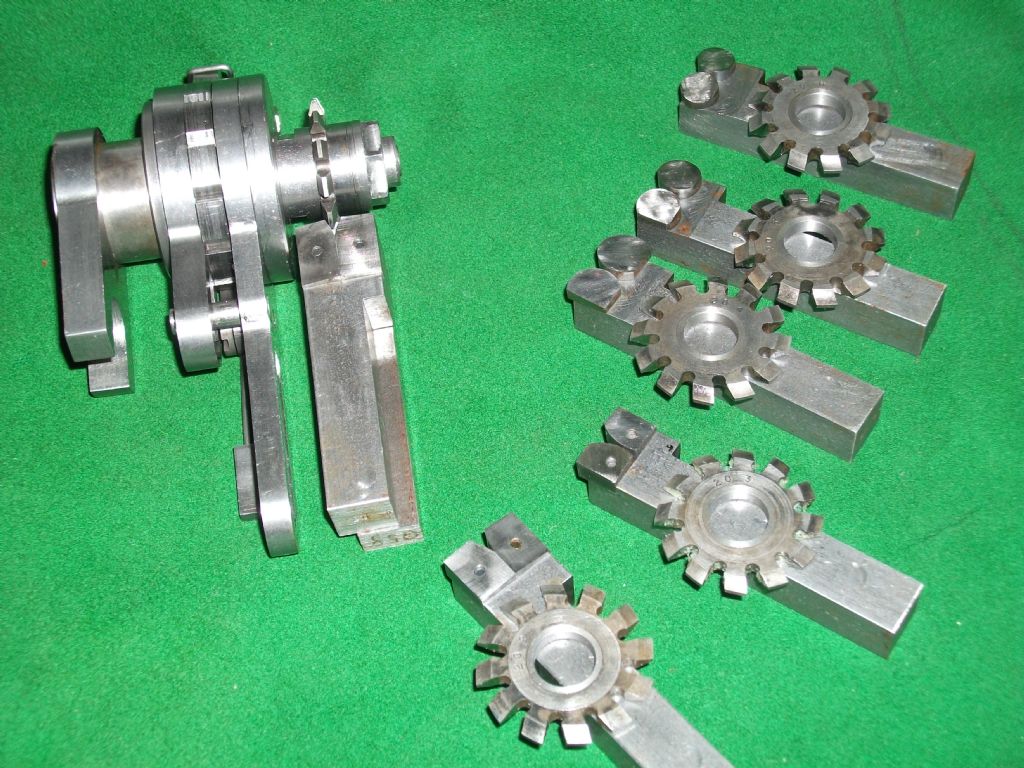

Button form tools used on the Eureka device can be a problem
to make in the sizes above cutter No 4 the radius is so large
that it would interfere with the body of the device , see here the photo
of 6 off 20 DP 20 pa cutters and tooling to make them .
Only a small part of the circle is needed to form the cutter in the
sizes 3 to 1.
These illustrations taken from an old book shows how this used
to be done and may be of some interest especially if you have
a shaper ,i don't need to add any more the pages show it all.
