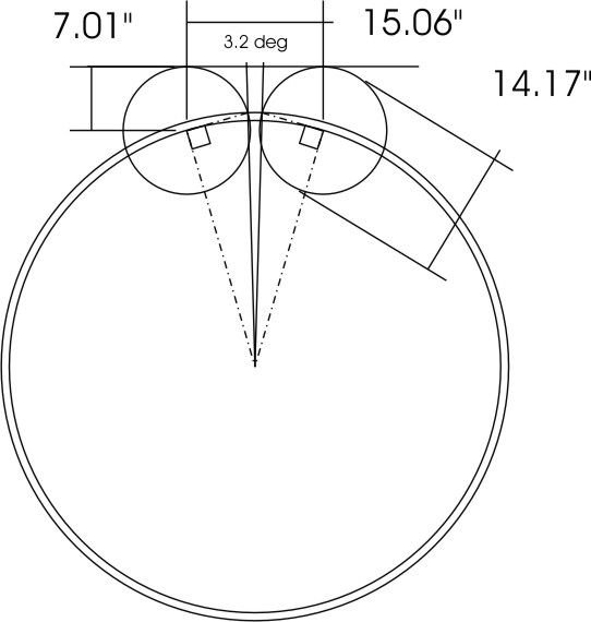

      Gentelmen (and Ladies)
      I am about to try making a replacement gear (16DP 14.5deg PA 56 teeth) and need first to make a suitable cutter. I have read Ivan Laws book, and obtained an excel spread sheet giving sizes for the buttons and their spacing for 14.5 deg, from a kind Gent via the internet. However in a quest to actually understand what I am doing, I would like to know how the button cutter spacing and infeed is derived. I can work out the size of the button cutters, but the spacing and infeed have eluded me. Can anyone enlighten me please?

                #145883
                  If you study figure 89 on page 113 of Ivan Law's book, it becomes apparent (after sufficient brain-wrangling) that the centre distance and infeed can be calculated by a certain amount of extra trignometry or by a graphical method (on paper or computer screen).
                  Darn it, it's easier to do than describe -does this help?
                  WARNING – INFEED DISTANCE IS WRONG – I SHOULD HAVE DRAWN AN INNER CIRCLE OF RADIUS 1/2pcd-DEDENDUM AND MEASURED FROM THAT!
                  Otherwise this is correct for 14.5 degree 56 tooth gears at 1DP.
                  The basic distance between buttons is calculated from knowing the length of the arc between two opposing pitch points either side of a gap. The infeed is calculated along a line that bisects the arc between the pitch points. Much easier to draw than do the trig… just draw a pitch circle and base circle with four radii with angles between them of pitch angle, 180/number of teeth, pitch angle. Using fig89 as a guide draw the circles and measure off the diameter, spacing and infeed.
                  I know this can be done, as against the odds, I made a 20-degree cutter for 13-tooth 20 DP gears. They needed very slight easing at the base of the tooth spaces, but other than that worked fine with other home made 20DP gears.
                  For the record my figures were
                  Cutter No 7.5
                  Teeth 13
                  D 4.50"
                  C 5.65"
                  E 2.25"

                    I have a version of the spreadsheet which will work out the button diameters, spacing and infeed for both module and DP gears. Just contact me via the contact form on my website for a copy.
                    http://mikesworkshop.weebly.com/
                    Mike

                      Thankyou to all who replied to my question. In less than 24 hrs I have the information from several sources. All I have to do now is make a cutter, then a gear.
