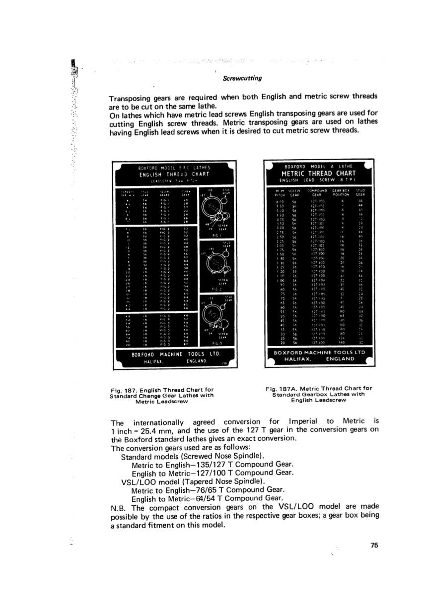

        Not sure about your transposing gears, page 75 from Know Your Lathe:-

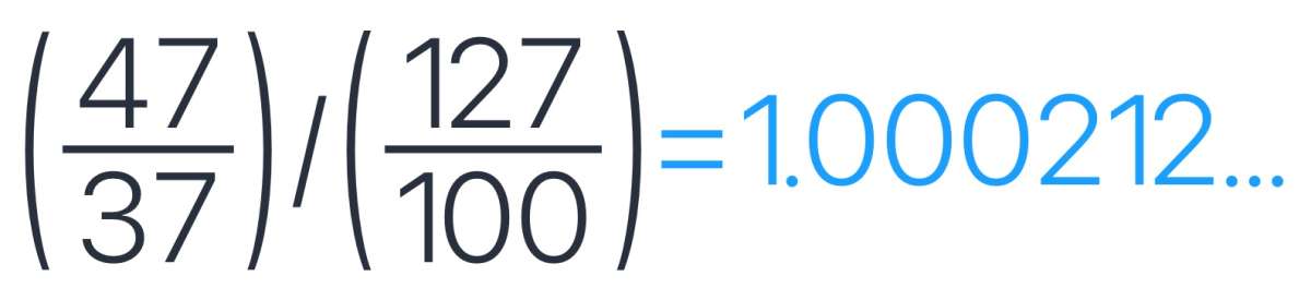

          A 47/37 gear has a ratio of 1.27027 instead of 1.27000 which is good enough for most applications.
          This table is not in my Southbend manual and the text is a bit unclear but I think it refers to a gearbox position. My lathe does not have a gearbox.
          Thanks Speedy,

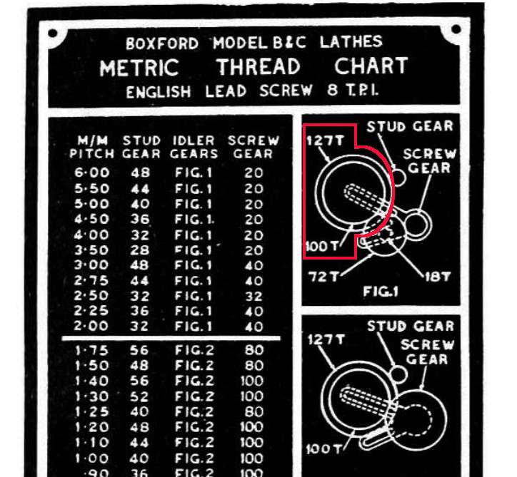

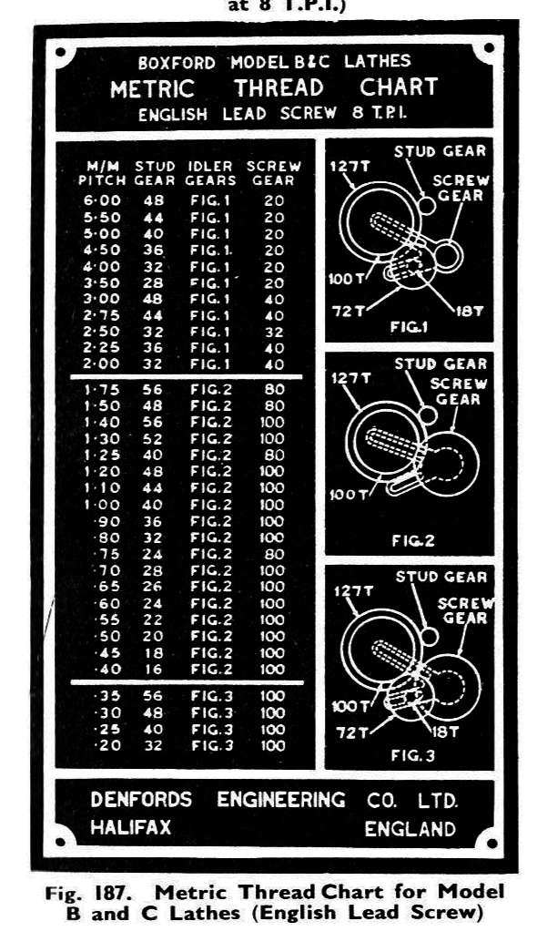

              The left chart that ‘Speedy Builder5 posted,, labelled fig. 127 shows the gears for lathes without the gearbox.
              Here it is again without the other chart or text
              Metric Threads wo Gearbox
