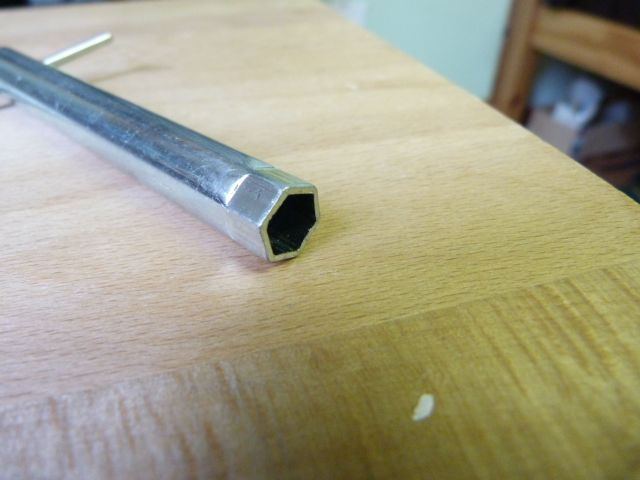

      Does anyone know where I can buy a length of 8cm (at least) of steel hexagonal tubing with an external across flats width of 10mm and an inside across flats width of 8mm. In other words, to fit over an 8mm nut and be turned by a 10mm spanner. The photo below shows the business end of a box spanner with the type of hexagonal tube I am after. If push came to shove I could possible adapt what I have already got, however, if I made a mistake it is far easier to cut another piece from a much longer length of suitably dimensioned tubing rather than reworking another box spanner.

          I would think that has been made from round tube then swaged into the hex at the end.

              I included the photo to help illustrate what I need, which is; a length of hexagonal tube. An 8mm box spanner with the external wall formed into an hexagonal throughout its length will be ideal. So far, I have only found box spanners similar to the photo and no source of 8mm internal flats, hexagonal steel tubing.

                From limited searching of the catalogues of standard steel products that I get most information from, there doesn't seem to be any steel hexagonal hollow.
                If anyone does manufacture such a product, it's likely to be a special.

                  You may be able to find hexagonal steel tube from a rollformer in China or USA (if ordered in very large qty's) but probably not on the shelf of a normal steel supplier. Some suppliers of architectural metals may also have it, but the small size may be an issue and they may not have it in steel.
                  Had you thought of using 8 x 10 or 8 x 12inside dim rectangular tube rather than hex? (if you are using it as a wrench, in fact)
                  This rectangular tube material may be easier to find. To control side slip on hex heads in such tubing if used as a wrench, setscrews could be added to centralize the tube on the hex points.
                  Failing all else, there are at least two other ways to make parts that look like hex tubing. You could make it in two pieces in the mill and solder or weld it together, or you could make a die for use in an arbour or fly press and squeeze round tube to the hex shape (maybe using an internal hex mandrel to help form the shape).

                    1 mm wall tube.11.2ish od .push hex down it..ideally creep up on size.. by mill/grind taper flats but failing that say 20 degree conical taper

                        13sigs is trying to make a long box spanner with the requisite dimensions to fit the hexagon nut of a glow plug for one of his model aeroplanes…wink
                        This should help us help him sourcing material, but I agree with David, unlikely to find tube ready made….
                        13sigs, I use a nut spinner in my glow engines for removing/ replacing glow plugs, iirc, its a BA size but cant remember which….(2BA?…)

                              This?
                              **LINK**
                              #210184
                              Vic
                                @vic
                                Posted by pgk pgk on 01/11/2015 15:12:04:
                                This?
                                **LINK**
                                Exactly, well done.
                                Why on earth would you try searching for hexagonal tube to make you own poor quality version!? wink
