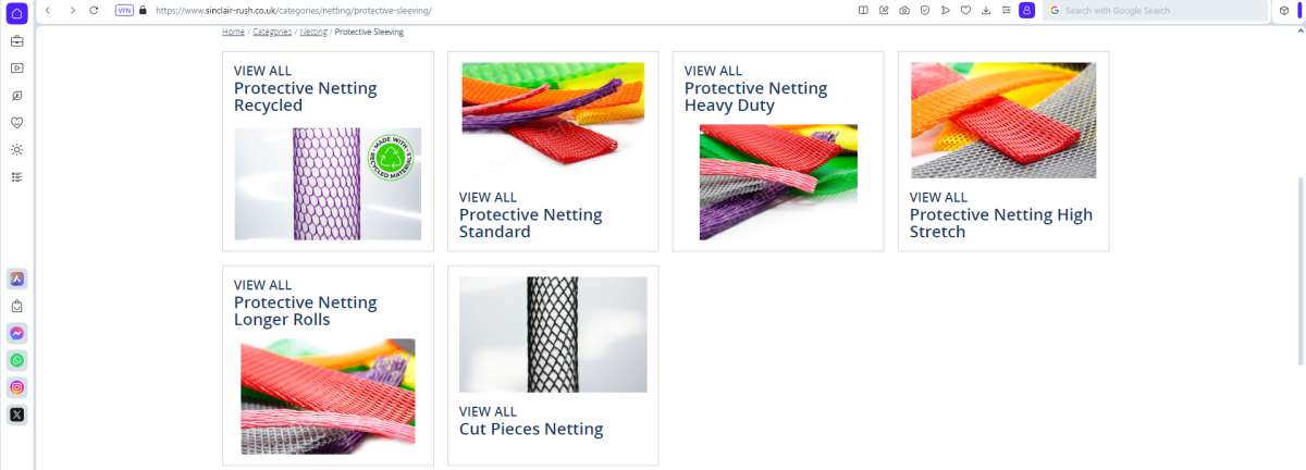

              peak4
                @peak4
                I forgot to mention, There is also this sort of protective meshing, which you could maybe colour code for metric/imperial 2/3/4 flute etc.
                I’ve no connection with this firm, or used their products
                image_2023-12-09_221612884
                Bill

                          #698483
                          Tony Pratt 1
                            @tonypratt1
                            On Grindstone Cowboy Said:
                            Crocell easily found on Ebay, but as DC31K says, not exactly cheap.
                            Rob
                            Bill
                            I would go for the above ‘mesh’, Crocell isn’t really practical for cutters you are using on a daily basis.
                            Tony

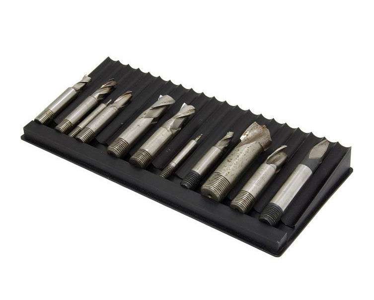

                                    #698564
                                    Andrew Entwistle
                                      @andrewentwistle
                                      For often used cutters I like these trays:
                                      https://www.machine-dro.co.uk/tool-storage-black#mz-expanded-view-1700615589643
                                      Out of stock for singles, but available from machine-dro via eBay 12 for £17
