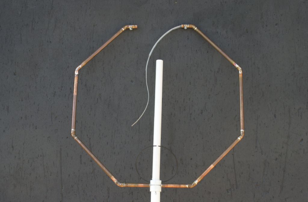

                      This is  1.2m 'diameter' loop – the coax feed to the tuning capacitor runs through the copper tube to the top, across the two open ends is where the tuning cap is fitted.

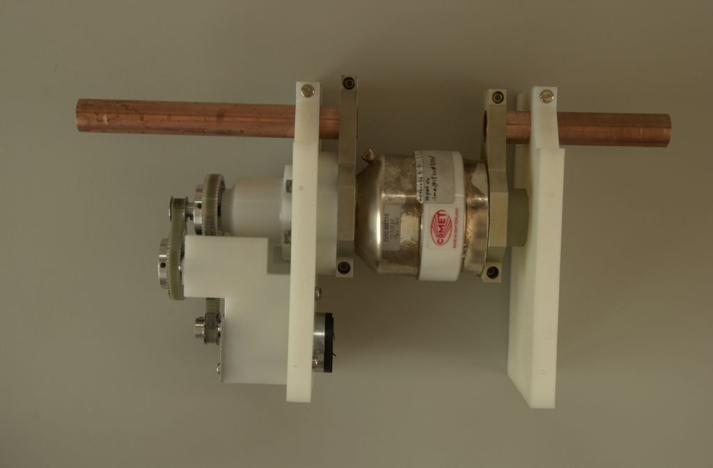

                      This is the remotely tuned vacuum cap I made up – The copper tubes fit into the open ends of the loop. The cap is a commercial COMET cap. 10KV, 1500PF max.

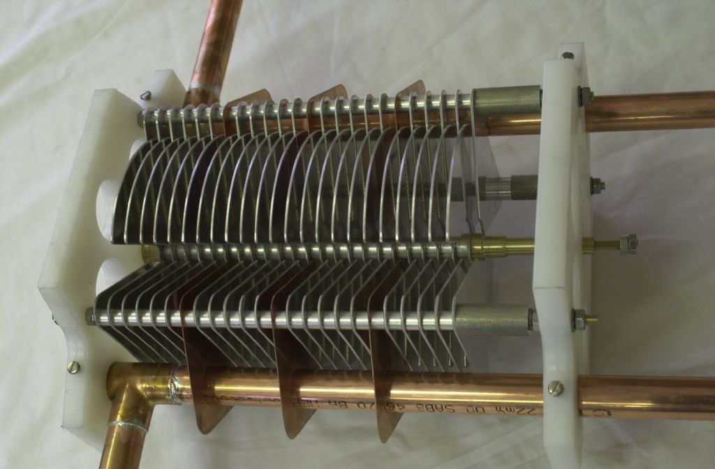

                      This is a vane type variable cap I made – the two copper tubes on the left fit into the loop open ends.
                      The cap was able to withstand 8KV, ie, 500watts on HF..

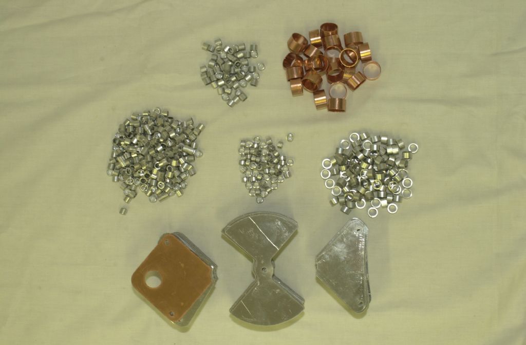

                      All the vanes were water jet cut from aluminium and copper sheet. The Moving vanes are 120mm X 70mm

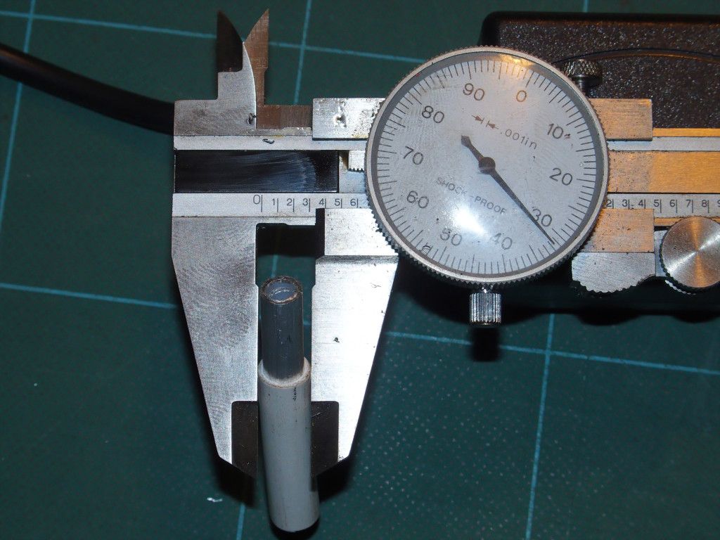

                          Dave, I'll ask on a BT/GPO telecoms forum on your behalf, if 1/4" OD pipe would fit your needs or to experiment with parallel loops.
                          It's used to link up the compressor in each exchange to the underground cables, which run under a +ve pressure of dried air to help exclude water from any damaged sections.
                          Its an aluminium alloy pipe, with a white plastic coating, and is easily bendable without kinking.
                          If you have any local BT/Openreach contacts, its used on the ECP (External Cable Pressure) racks and comes in a loose roll in a box. It holds its form reasonably well when bent.
                          Ali tube is 1/4" OD with a wall thickness of 0.050"
                          Overall OD is about 0.33"
                          The bore is clean inside, the scratches below are where I quickly de-burred a bit to measure the wall thickness.

                                With respect to a loop with joints – you lose nothing by using 20mm copper tubing, with the 45deg elbows, and solder the joints properly. The current flow in a loop antenna on transmit is very high, and due to the skin effect, resistance of the antenna plays a big roll – clean copper wins hands down against clean aluminium, but any oxidation on either can reduce the efficiency from 3 or 4% to 1-2%…
                                Also, the 'diameter' increase needed to enclose the same circle area by using an octagon shape is very small and will not impact the size in any detrimental manner I would think.
                                The Al piping may fair better in that the Al material is kept from oxidising by the plastic covering – I scrubbed my copper loop with pot scouring pads and then gave the loop a coat of clear two-part epoxy paint. That survived around 8 years.
                                The vane capacitor was enclosed in a box made from 5mm PVC sheet, and all pipe exits were sealed with silicone. The tuning of that cap was done by means of an RC servo, with a simple RC servo tester providing the 1ms to 2ms pulse train. Tuning was effected by watching the SWR meter and tuning for lowest SWR. You can a also tune on maximum received noise, but I had such a crappy ( digital) servo in the beginning , it generated so much noise itself that it masked the signal! When I replaced it with an old analogue servo that method worked ok.
                                Dave, I have one of those COMET vacumm capacitors still – good for 10KV, I believe – Had it for 12 years or so and will never use it – I could try get it to you? Not sure how much shipping would be and what the complexities are at your end for its import? It is about 220mm long and 90mm diameter, maybe 1kg or so. Solves some of the issues of keeping it dry, etc..Even a study plastic bag and tie wraps would work! You are welcome to it..
