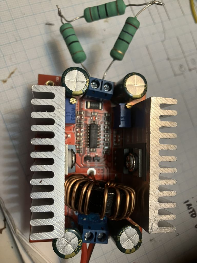

          Posted by Robin Graham on 26/01/2023 21:38:31:
          On the LUXdrive units (they look nice!) I couldn't see a Vout on the site Michael linked to (may have missed something?) but the LUXdrive A011-D-V-700 is available in the UK from Digi-Key for £20.50 and they give a maximum Vout of 48V – so they should be fine for this application.
          On other (cheaper) solutions I, like Noel, ordered a 400W booster (£8.49):
          Reading Les' account I went very carefully! With 10V input and no load I adjusted the output to 12.5V – the module drew ~10mA. Connecting an 81 ohm load (shown) the voltage remained stable and it drew 220mA at the input . Cranking the current pot right down the voltage across the load dropped to 11.5V, so I guess it's working as expected and I'm hopeful that it will be OK to drive the LED array..
          A slightly odd thing is that the +ve output appears on the leftmost heatsink in the photo. Something to be aware of if going down this road.
          Robin.
          The bit of Les' account you should pay attention to is " I would not advise anyone to buy one of these regulators to power the Plessey LED modules. "
          Your test is not conclusive. To ensure a constant current generator is working correctly you must change the load, not the output voltage or current.
          Assuming you don't have an ammeter, with your set up the test would be:
          Set the voltage control higher than required for the maximum current you want to flow
          Connect 3 resistors in series across the output
          Set the desired current (for the test load) or turn down until the output voltage just starts to drop
          Measure the voltage across the load. and not the value.
          Short out one resistor
          Measure the voltage across the load and ensure it changes to 2/3 the value for 3 resistors.
          Your resistors look like 100 Ohm to me, but photo and screen colours are dificult. Assuming they do total 81 (3 x 27) Ohms, at 12.5V maximum current would be 150mA so if current was set to less than this, say 120mA, the voltage will drop (to 9.7V for 120mA). Shorting out a resistor will, if it is a constant current supply, cause the voltage to drop to 2/3rds (6.5V for 120mA).
          Values will be +_ 10% typically.
          If it is not a constant current supply you will find it very hard to set the voltage with the load connected and the voltage will not drop when you short out one resistor.
          Robert G8RPI.

          Robin Graham
            @robingraham42208
            Robert – apologies for not responding earlier, I have only just got back to this.
            I have now made experiments along the lines you suggested. My procedure and results:
            – set PSU to 12V in CV mode
            – adjust voltage pot on convertor to give 24.5V no load – PSU is indicating 10mA at this point.
            – attach load (definitely 3 x 27 ohm 5W resistors in series) and wind down current pot on convertor to give 24.0 V
            – attach voltmeter over the central resistor in load – 8.05V as expected. The PSU is supplying 660mA.
            – short out one of the other resistors, momentary flicker, but 8.03V across the central resistor.
            So that seems good – it's current limiting.
            However…
            Removing the short then turning the current limit from the PSU right down I find that:
            – if I turn it up again straight away (within a couple of seconds) the PSU voltage / current return to 12V / 660mA immediately and all is as before.
            – if I leave it for ~15 minutes with the PSU current down to zero, then turn it up to max (3A) the PSU supplies the full 3A. At this point the the voltage from the PSU is about 6.9V and the voltage across a single load resistor is about 7.5V. After approx 70 seconds in this condition the PSU suddenly switches back to 12V and 660mA and the convertor output jumps back to 8.05V per resistor.
            Does that give any clue as to what is going on with these modules? I haven't tried connecting to 12V lead acid battery (which was what I'd hoped to do) because I suspect that the convertor would suck up too much startup current and self-destruct, as Les found.
            Robin.

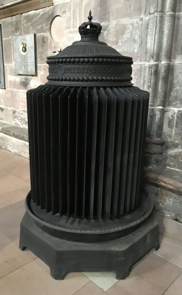

                  Probably drifting a little off-topic, but I started the thread so what the heck devil
                  I visited Chester Cathedral today, and admired these Gurney Patent heaters:
                  Inspiration for a ‘heatsink’ perhaps.
                  Incidentally: They were decommissioned when trendy underfloor heating was installed
                  … with the result that the stacking wooden chairs in that area had to be scrapped, because they warped !!
                  Ref. __  https://www.gracesguide.co.uk/Gurney%27s_Patent
                  Edited By Michael Gilligan on 07/02/2023 21:38:44
                  #632509
                  noel shelley
                    @noelshelley55608
                    A truly wonderful device ! Bolted to a semiconductor how many 100/ 1000s of As can be disipated ? I 'll be back ! Noel.

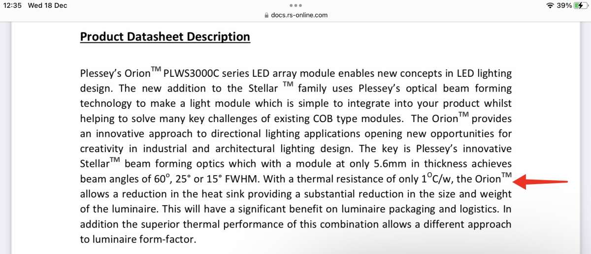

                                  I did download and read the datasheet at the time, I just looked again now and whlst it has much info on the optics there is sparse reference to its heatsink requirement. There is a picture showing this (5.6mm thick) module alongside a standard COB which is 175mm high, I agree this is quite an impressive reduction in size for an equivalent optical performance.
                                  However regarding heatsinking (the datasheet does say:
                                  By adding a driver and a lightweight heat sink consumers can experience a new quality of directional light.
                                  So a lightweight heatsink (but I suspect one that will not be inexpensive)

                                      Michael, (not because you linked to it) but that is not what I would describe as ‘lightweight’ especially in relationship to the module and the Plessey datasheet size comparison that sort of infers it is a far more compact total package than the standard ‘COB’.
                                      The Plessey datasheet states that the module itself has a 1°C per Watt thermal resistance, I’m not sure how to interpret that.
                                      Ian P

                                        Les Jones 1
                                          @lesjones1
                                          I think the 1 degree C per watt is the themal resistnace between the metal back  surface and the device junctions.  The data sheet probably also gives the maximum recomended junction temperature. So with the 1deg c/W theramal resistance of the device if it is consuming 30 watts the junction temperature will be 30 deg, C hotter than the metal mounting surface.
                                          Les.
                                          #771012
                                          Robert Atkinson 2
                                            @robertatkinson2
                                            Les is correct.
                                            The datasheet thermal resistance is Junction to case, Rthj-Tc. Actually specifed in Kelvin per Watt but that’s the same as C/W.
                                            You have to subtract that from the calculated heatsink thermal resistance for a given LED and ambient temperature.
                                            Robert.

                                              Les & Robert
                                              Many thanks for the input … ’though I confess to being confused by what exactly it would mean in a ‘real-world’ implementation.
                                              Just for convenience, let’s suppose I wanted to run one of those modules continuously, flat-out, in a domestic environment at an ambient 20°C … how would I specify a suitable passive heat-sink ?
                                              Thanks in advance
                                              #771095
                                              Robert Atkinson 2
                                                @robertatkinson2
                                                So the electrical specification is Forward Voltage 44V and maximum continuous current 700mA (0.7A). Thus the power input is 44 x 0.7 = 30.8 W. Taking a conservative 30% efficiency gives 21.6W of heat. The absolute maximum temperature of the case (mounting surface) is 90 degrees C.  For you specified ambient of 20 degrees this is a maximum rise of 70 degrees. The temperature rise of a heatsink is the power times the thermal resistance of the heatsink delta T = P x Rth. We can rearrange to find the required Rth = delta T / P. So for 21.6 W and 70 deg  we get  3.2 degrees C/W as a minimum size heatsink.
                                                We don’t consider the 1 degree C/W o the datasheet because the we have used the specified maximum case temperature not the LED chip temperature. The chip temperature will be 1×21.6 higher or 111.6 degrees C.
                                                Note that 20 degrees is a pretty low ambient. If we take 30 you need a 2.8 degree C/W heatsink.
                                                A 150 x 150 x 1.5 mm aluminium sheet is about 3.3 degrees C/W thermal resistance. 200 x 200 x 1 mm is about 3.1 C/W. Better if anodised or thinly painted black. There are calculators online for simple heatsinks.
                                                Robert.

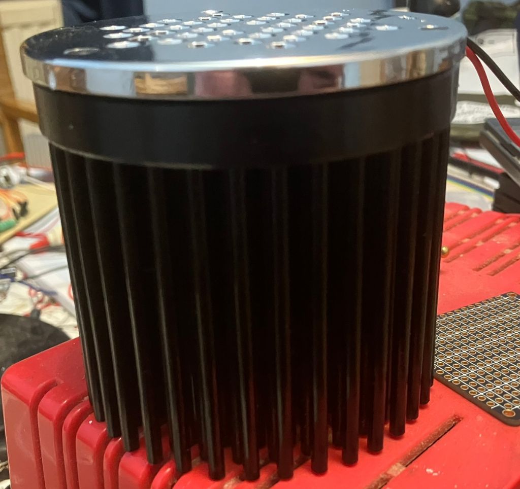

                                                      Robin Shows a pin fin heat sink of 75mm dia and about 150 pins of 60mm long with a 10mm thick base which I had deemed ample. One thought is to use the heatsink membrane between the LED unit and heatsink. It was about £8. If this was not enough I would mount a small 12v computer fan on the back of the pins to stir the air. The whole affair would be very compact as I intend to mount the PSU on plastic stand offs from the pins. It all still sits on the mantle shelf but this has prompted me to look at the idea again. Noel.
