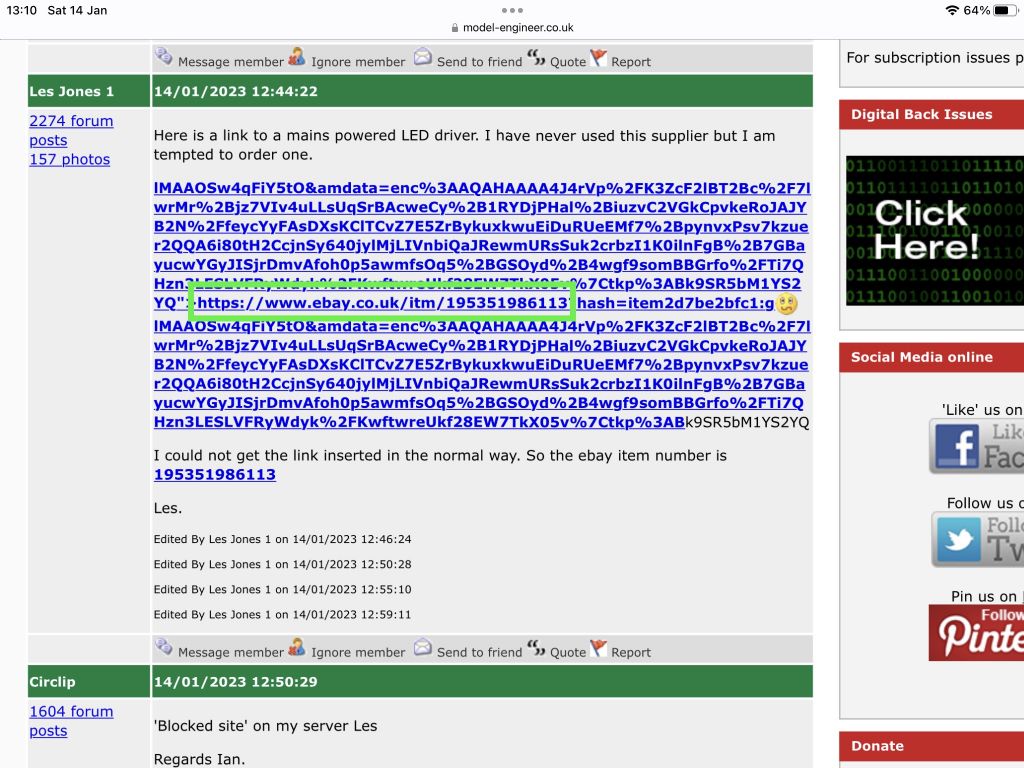

              For your future convenience, Les
              All you need from that massive hyperlink is what I have outlined here, in green
              Everything else there is ‘tracking’ which describes your journey [to those who are tracking your activity.
              Edit: __ Thanks for the link … That’s a very good price

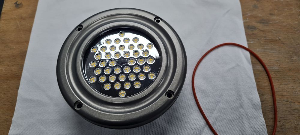

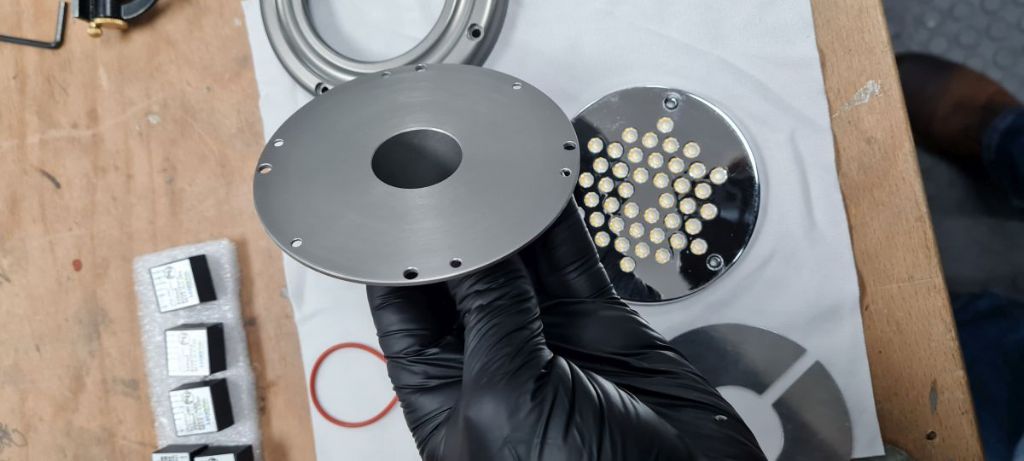

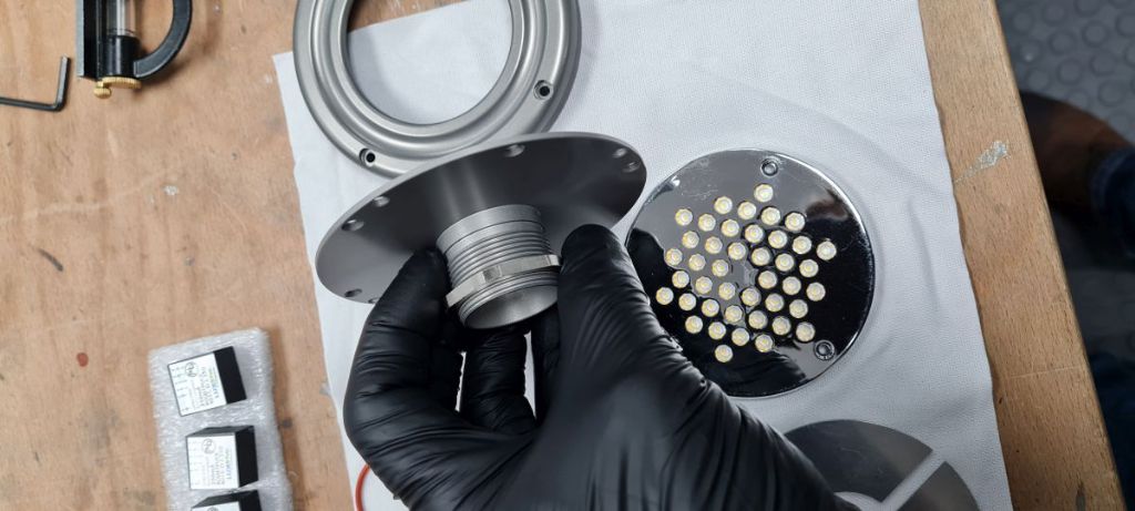

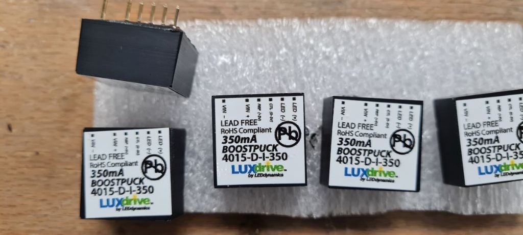

                                  Dogboy
                                    @dogboy
                                    Hello Everyone,
                                    In the past we have used the Luxdrive constant current drivers to run these modules. All though they are 'only' 350mA they work very well and the modules are still very bright. These little Boostpuck drivers are small, around an inch square with and has adjustable current pot on the bottom.
                                    They can be run from a 5V to 28V input with a max V out of 48V. This are ideal for running these modules at 5, 12, 24 Volt etc
                                    Luxdrive model number is: 4015-D-I-350, from what I remember they are fairly low cost.
                                    I have attached some pics of the drivers and also, just out of interest, I have attached some pics of some hard anodised enclosures that were made specifically for a one off project. These had glass fronts and also had two o-rings to seal the module making it totally waterproof. Unfortunately, these are not available but may have the drawings somewhere.
                                    Thanks
                                    Paul

                                      Posted by Dogboy on 16/01/2023 10:01:43:
                                      Hello Everyone,
                                      Welcome, Paul … and thanks for a great first post !!

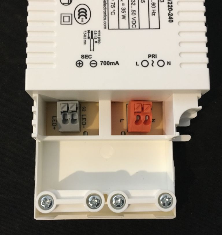

                                                    Posted by Michael Gilligan on 14/01/2023 13:23:56:
                                                    Units arrived today … and the mystery of the electrical terminations is solved
                                                    Hiding under the plastic cover is this:
                                                    Note: the ideal implement for opening the cover is on my Swiss Army Knife

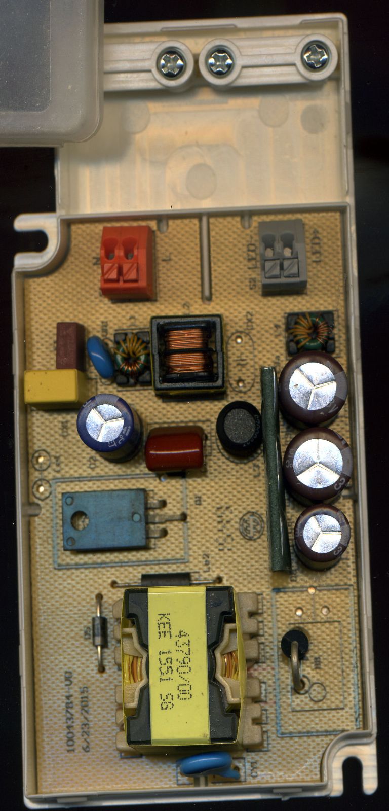

                                                      The two of these that I ordered also arrived today. I first tested one with a 64 ohm resistive load and the voltage across this was 44 volts. (Which is a current of 687.5 mA
                                                      Here is a picture of the inside just using the flatbed scanner. (The main cover is removed in the same way as the terminal cover by pressing down on the place where the clips are with a small screwdriver.)
                                                      I notice that the price of these drivers has now gone up to £7.00.
