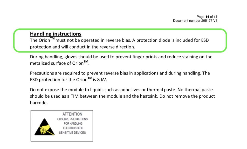

      Posted by Jim Butler 1 on 09/01/2023 00:01:12:
      Posted by Michael Gilligan on 08/01/2023 22:59:35:
      Posted by Robert Atkinson 2 on 08/01/2023 21:17:24:
      Interesting that there is a bridge rectifier on the board.
      … especially as the data-sheet appears to say it should not be reverse connected.
      Looking at the track pattern in the picture, the AC terminals of the bridge rectifier seem to be routed to the power input connector.
      In which case, reversed polarity supply would not be a problem.
      JimB
      Exactly my point, Jim
      [would not be a problem … except that it is ]
      … which is why it is essential to read the data-sheet.
      Edited By Michael Gilligan on 09/01/2023 08:49:48
      #628299
      Ian P
        @ianp
        The information in the manufacturers datasheets should sometimes be taken with pinch of salt.
        I saw the bridge and the diode packages on Michael's first picture but did not (and still have not, followed the track layout) but from the text in the Plessey datasheet one might infer that the diode was before the bridge, but in that case why even have a bridge rectifier.
        If the bridge rectifier is across the incoming supply then why the warning about reverse polarity I wonder.

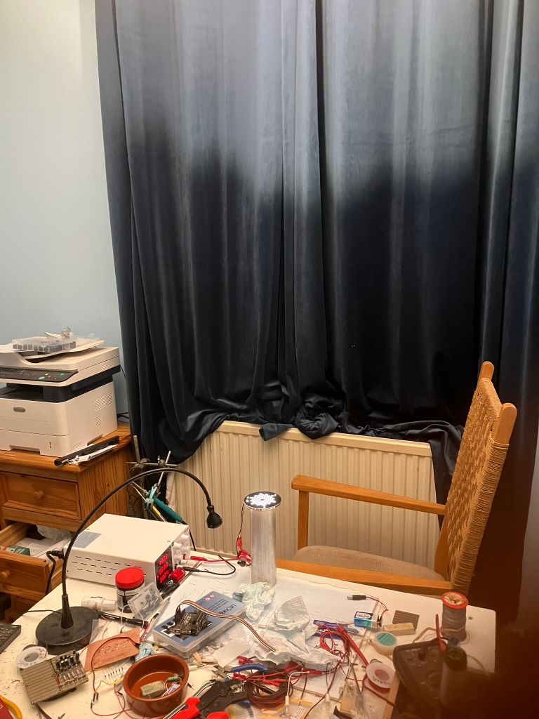

                Posted by Douglas Johnston on 09/01/2023 14:26:40:
                Right then-cut to the chase-has anybody got them working yet. Being somewhat chicken I have a couple of them on the workbench while I fret over how to power them without killing them.
                Doug
                This is a 60 degree version running in an otherwise unlit room (white ceiling):
                It's pretty bright!
                It's running from a lab PSU in CC mode, current clamped at 700mA , voltage was 43.4V at that current.
                Not having a suitable heatsink I just perched it on top of a piece of 2.25" Ali bar, fresh from the workshop so at about 10C. I ran it for maybe 2 minutes – the aluminium back of the LED was stone cold after that but the metallised plastic housing was warm.
                I'll rig up a thermocouple and get proper measurements anon.
                Robin.
                Edited By Robin Graham on 09/01/2023 22:12:38

                            Thanks for the heatsink calculation Robert – I thought it would be more complicated than that!.
                            Can you – or anyone else – rationalise this from the datasheet:
                            "Do not expose the module to liquids such as adhesives or thermal paste. No thermal paste
                            should be used as a TIM between the module and the heatsink
                            . Do not remove the product
                            barcode".
                            My bold/italics. It seems common sense to me to use thermal paste. Am I missing something?
                            Obviously no one in their right mind would remove the barcode. One shudders to think of the consequences…
                            Robin.
                            #628997
                              Posted by Robin Graham on 12/01/2023 23:16:34:
                              Robin.
                              It confused confuses me too, Robin …
                              As for the barcode [the little titchy one on the edge] … it’s interesting to note that it’s not the part number, so it might be something to do with batch traceability.
                              #629020
                              Robert Atkinson 2
                                @robertatkinson2
                                I'd not spotted the note about thermal paste. Most of these are based on silicone oil and a filler (typically zinc oxide).
                                The Silicone oil tends to bleed out of the paste and creep across surfaces. I can only assume that some component of the assembly is not compatible with silicone oil. Given the large surface area of the assembly and low power rating I would not have thought compound was needed anyway. Its more typivcally used on small components or those with a lot more power.
                                My heatsink calculaton do not allow for the thermal interface as I conservatively assumed all the input power turned to heat. In rality only about 60% is heat so more like 18W.
                                Robert G8RPI.
