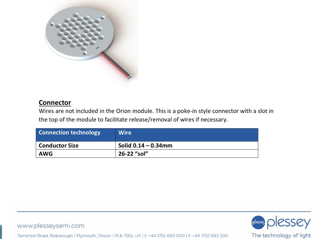

              The ‘connector’ is internal, John … it’s just a matter of poking bare wires into the two little holes.
              [there are two more holes to release the spring clips]
              Doesn’t feel comfortable to an Engineer … but there is surprisingly clever engineering involved.
              Note: The Plessey data-sheet specifies solid wire 0.14 – 0.34 mm
              a.k.a.  AWG 26 – 22 “sol”
              Which sounds like common-or-garden hook-up wire to me.
              Edited By Michael Gilligan on 07/01/2023 18:29:31

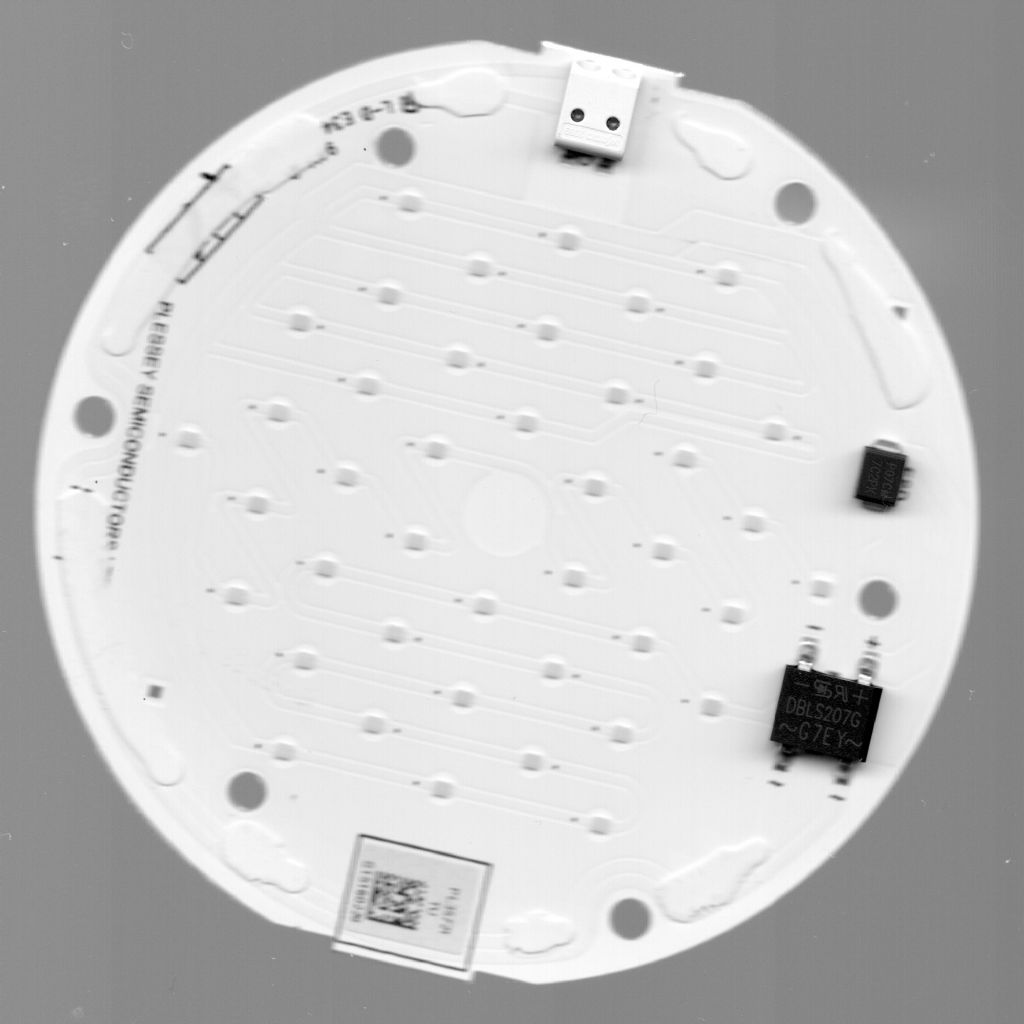

                                            As promised … a few seconds prising with the trusty Swiss Army Knife 'bottle opener cum screwdriver" revealed this:
                                            Apologies for the focus … I just popped it on the flat-bed scanner
                                            [ I might photograph it properly tomorrow ]
                                            Hopefully the tracks are visible.
                                            That 'board' is actually on the surface of the steel anodised aluminium heatsink, and the LED chips are tiny
                                            The clever optics is all in the cover
                                            Edited By Michael Gilligan on 08/01/2023 20:09:04

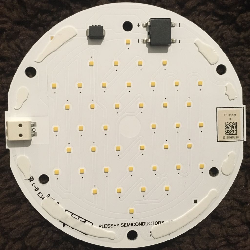

                                              [ UPDATE ]
                                              This, snapped on the iPad, will probably suffice:

                                                Interesting that there is a bridge rectifier on the board.
                                                Robert G8RPI

                                                    Posted by Robert Atkinson 2 on 08/01/2023 21:17:24:
                                                    … especially as the data-sheet appears to say it should not be reverse connected.
                                                    #628267
                                                    Jim Butler 1
                                                      @jimbutler1
                                                      Posted by Michael Gilligan on 08/01/2023 22:59:35:
                                                      Looking at the track pattern in the picture, the AC terminals of the bridge rectifier seem to be routed to the power input connector.
                                                      In which case, reversed polarity supply would not be a problem.
