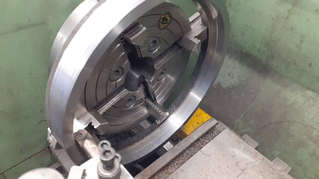

        Hopper I suspect the OP is a 3/16 and 5/16" shank solid HSS bar, I certainly have these sort of sizes.
        By DOC he means depth of hole those 3x and 5x figures as multiples of the shank diameter.
        All perfectly possible with a mini lathe, have even done it on my old Unimat 3
        How deep you need to bore down into the hole is what generally determines bar diameter, I have upto 28mm and that only comes out for holes that are 150mm deep or more, tell a lie I do have a 35mm one but that only gets used between ctrs.
        Diameter is not so important. Take this afternoons efforts, 185mm dia but as I was only going 18mm deep I used a 12mm insert bar as it's the biggest that fits the QCTP so less hassle to just slip it in as it stays in a holder all the time
        Lathe;s power liminted the cutting depth (amount removed per pass) so it did not break the swarf into chips but got an impressive sized birdsnest of swarf in various colours.

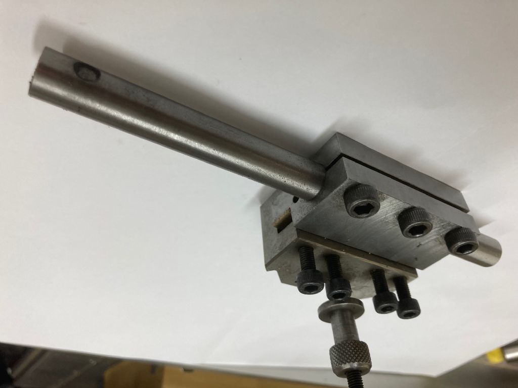

          Here is my rendition of one of G H Thomas' Boring bars.
          Has all the advantages of the square tool holder as has been mensioned but with the additional advantage of being able to clamo round sections larger than the tool post slots. It's also easier to extend the bar without having it come lose in the toolpost.
          regards Martin

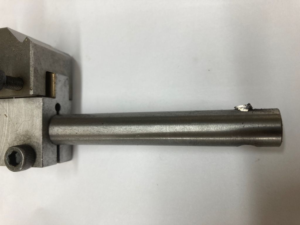

            Yes – for boring, of course it's too long, Clive!
            I was last using it to flycut a flat on the bottom of a titanium toy car for the grandkids! smiley
            Time before that I was cutting some 1 7/16" x 12 TPI internal threads for the railway, using a different toolbit ground to fit the pitch gauge.
            Versatility was my point.
