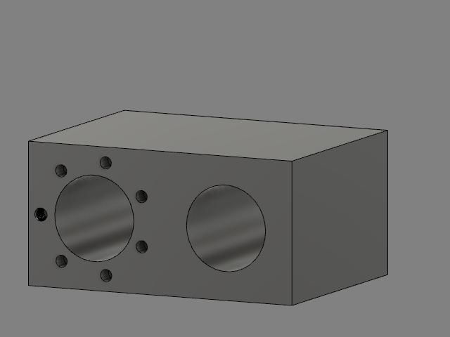

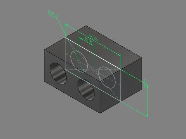

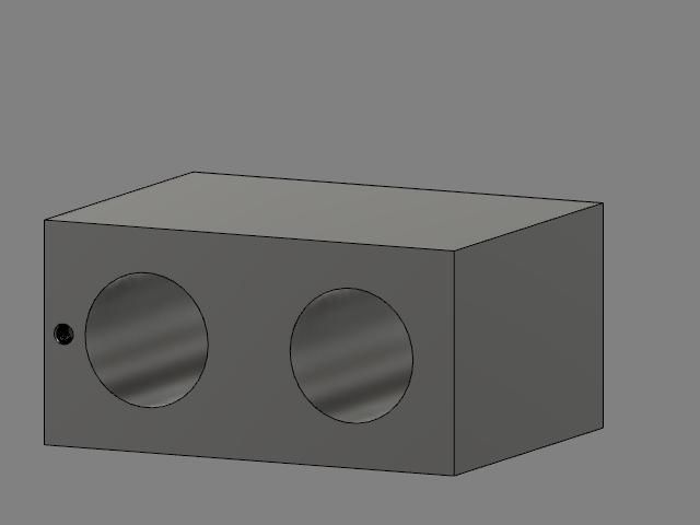

                                            #577825
                                            Nick Wheeler
                                              @nickwheeler
                                              Pictures would help……
                                              But the stud holes would be created directly onto the required surface, just like you would physically drill them. And you only need one, created using a hole command that controls the diameter, depth, thread size, and even the drill point you expect. Then it's another editable command to add however many you need around the circle.
                                              And I have no idea why you're creating and moving a box around that isn't even the shape you want.
                                              Once again, you need to stop thinking combined drawing elevations, and start thinking 3D object because that's what you actually want.
                                              Something like this, a sketch that's one rectangle, two equal circles, two extra construction lines, and a symmetry constraint extruded to a solid:
                                              Add an M5 hole 6mm deep
                                              and a pattern of 7(because that's a horrible thing to calculate) around the bore:
                                              So that's one simple sketch, an extrude, one feature(the hole) and a pattern. Any of those four operations can be changed, so you could make the thread imperial, a more reasonable pattern of 6 holes or the block 87.65748380mm long instead of the 75 I chose. Relieving the edges between the bores would be drawn on the face to the required shape, and extruded through the block to cut them out. That could be done on the original sketch, but would make it a bit busy. You would round the four outer edges of the block with one fillet operation that gives full control of the radius applied.
                                              This is far simpler and easier to do than your painful description. Alibre or Solidedge wouldn't be much different.

                                                Regarding putting the small hole son the other end, I just click "mirror" and select the axis to mirror them in and they all appear on the opposite side.
                                                As for dragging a rectangle about to centralise I just click the symmetric icon and then axis and two opposite sides of the rectangle and it will then move to a symmetric position.
