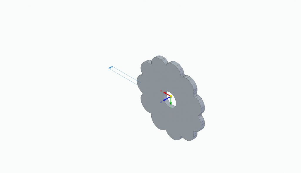

                                            Well, I managed to generate a "Daisywheel" cam in CamBam (which has tool for generating cycloidal reducers), import the profile into SE22, and extrude it as a part 1.6mm thick. Not bad for me considering I only started viewing the tutorials yesterday…
