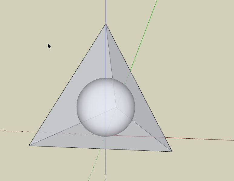

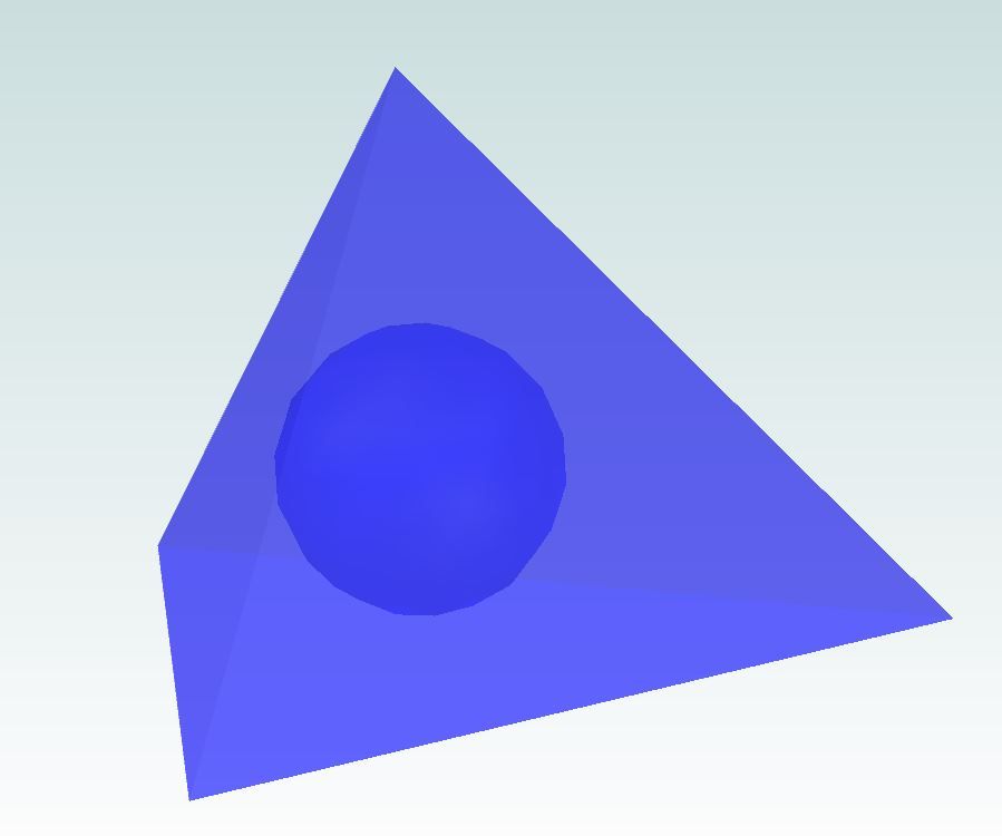

          Anyway your homework for this weekend is a semi transparent Tetrahedron with a spherical void in the middle. Oh and that is after you have cut those spur gears which have not been handed in for marking yetsmile p

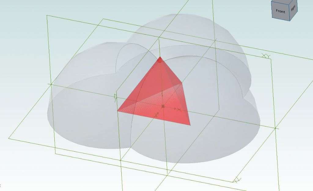

              Well JB a lot of contributors are missing the point – perhaps the reference to balls clouded their vision
              You see the derided 2D compass was the way to find an intersection in 2D

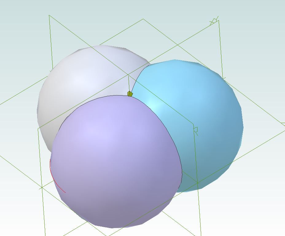

              But take the tetrahedron , we have a base triangle and a point in space to draw 3 identical side lines to meet the others from their respective vertices.
              obvious – have we lost them yet?
              a compass will describe a sphere in 3D. So we are intersecting 3 spheres (which will give 2 points +/- Z)
              BUT the CAD circle is approximated by a polygon (default 24,36 segments)
              Without using built-in tools as may exist in some CAD apps, it is difficult to intersect 2 circles on the 2D plane – it wont give you an intersection point. In SE you have to use the Trim tool to remove the outer arcs leaving you with a lens
              This lens will be given intersection points vertices you can use and its accurate (to 6dp)
              Now there are glitzy tools in some CAD apps that will draw platonic solids ready made which skates over the fundamental issue here – your vertices must be 100% accurate (near enough is not good enough – which you can fudge in 2D). More than 3 must be coplanar or they wont make a face – plus the other manifold rules
              to construct the tetrahedron with a given construction line drawn from centre up the Z axis, Can you draw a line from one of the vertices with the given side length so that it intersects with this Z line
              If you can you cracked it.

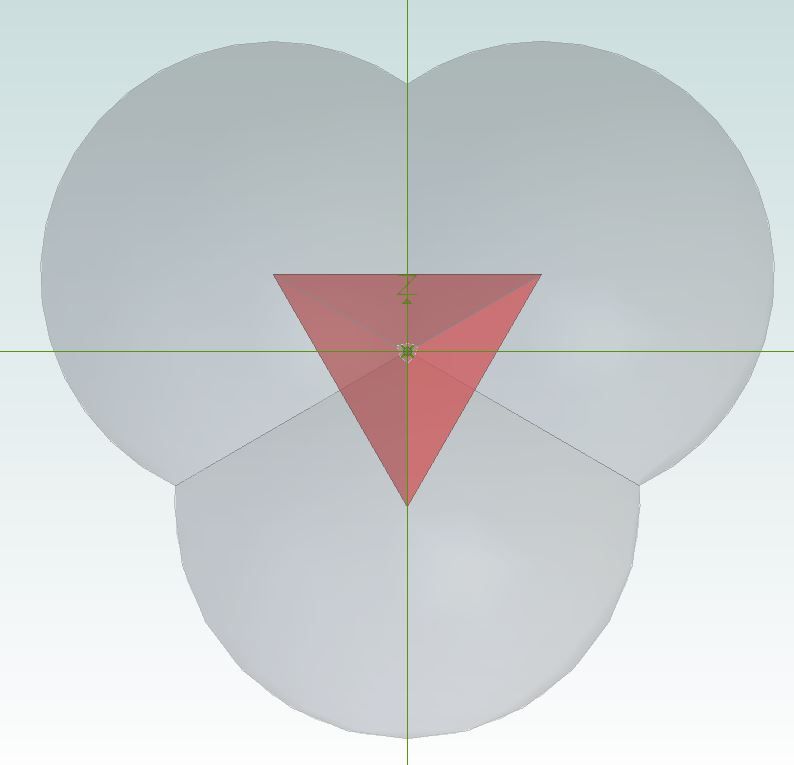

                Ah, I see what you mean now. 3 spheres each with their ctr located at a corner of the base triangle will intersect at the top. I've left the top poking through a bit to make it more obvious.
                hemispheres may be easier to see whats going on, view from below
                And from above

                  is that intersection point accurate
                  can you draw 3 lines to intersect
                  are all the edges the same length to n dp
                  if so thats cooking on gaslaugh

                  I constructed my solid using lines not a glitzy extension.  SU2021 has addressed the intersection problem and it will now intersect in 3D space correctly, but I have yet to xlate this into an SE experience
