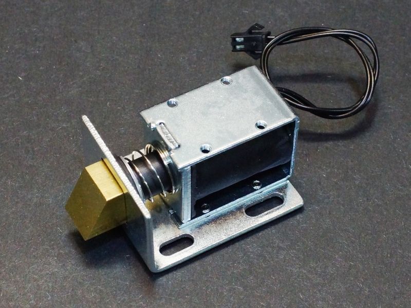

                    I was thinking of a 1kg pull solenoid lock like this.
                    The example has a 12V coil demanding 1.7A which would need a high-current battery, though only in a short pulse. Li-ion battery rather than CR2032 but do-able!
